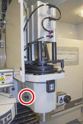

  1. Identify the two pre-existing mounting holes behind the spindle on the head casting.
Figure 1: Mounting holes on the head casting.

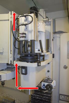

PCNC 770/PCNC 1100
  1. Open the spindle motor cabinet door.
  2. Route the control cable from the SmartCool head unit up the spindle column and through the inside of the spindle motor cabinet.
Figure 7: Routing into the spindle motor cabinet.
  1. Secure the control cable from the SmartCool head unit to the machine with two cable ties and two cable tie mounts: one inside the spindle motor cabinet, and one on the head casting.
Figure 8: Cable tie mount on the head casting.
