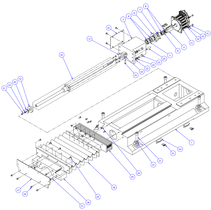

Y-Axis Assembly - 770MX
Alternative Part Number
770 Machine Base*
770 Y-Axis Motor Mount (PN 31617)
Ball Screw Coupler (PN 31421)
X-/Y-Axis Ball Screw Support Bearing (PN 31432)
770 X-Y Ball Screw Bearing Spacer*
Bearing Cap (PN 31530)
Sleeve*
770 X and Y Ball Screw Preload Nut (PN 31616)
770 Tab Washer for Preload Nut (PN 31542)
Y-Axis Ball Screw Assembly, 770 (PN 31425)
11
Y-Axis Servo Motor, 770 (PN 38702)
12
X/Y-Axis Ball Screw End Bumper, 770 (PN 31613)
13
770 Ball Screw End Stop Clamp*
14
Y-Axis Limit Switch Flag (PN 30450)
15
770 X-Y Motor Mount Cover Plate*
16
770 Y-Axis Bellows Holder*
17
Y Cover Mounting Plate (PN 31628)
18
Y-axis Front Way Cover, 770 (PN 31419)
19
Y-axis Rear Way Cover, 770 (PN 31437)
20
Washer, Flat, 5 × 25, 3 mm Thick*
21
Screw, Socket Head Cap, M12 × 1.75 - 45
McMaster-Carr: 91290A624
33
22
Washer, Flat, M12
McMaster-Carr: 91166A290
12
23
Washer, Split Lock, M8
McMaster-Carr: 91202A238
24
Screw, Pan Head Machine, M5 × 0.8 - 10
20
25
Pin, Taper, 8 × 30, M5 Thread*
26
Screw, Pan Head Machine, M5 × 0.8 - 8
McMaster-Carr: 92095A207
