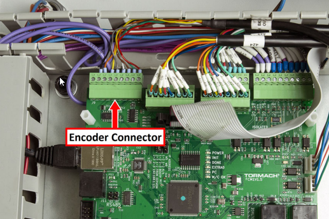

Inspect the Connectors and Wires at the Machine Control Board
Reason: Loose or incorrectly wired encoder wires or connector.
  1. Power off the machine.
  2. Examine the connection at the machine control board. Verify that the connectors are firmly seated, and examine the connectors for loose wires or ferrules.
J9.1 - Red
J9.2 - Green
J9.3 - Brown
J9.4 - White
J9.5 - Gray
J9.6 - Yellow
J9.7 - Orange
J9.8 - Black
J9.9 - No Connection
