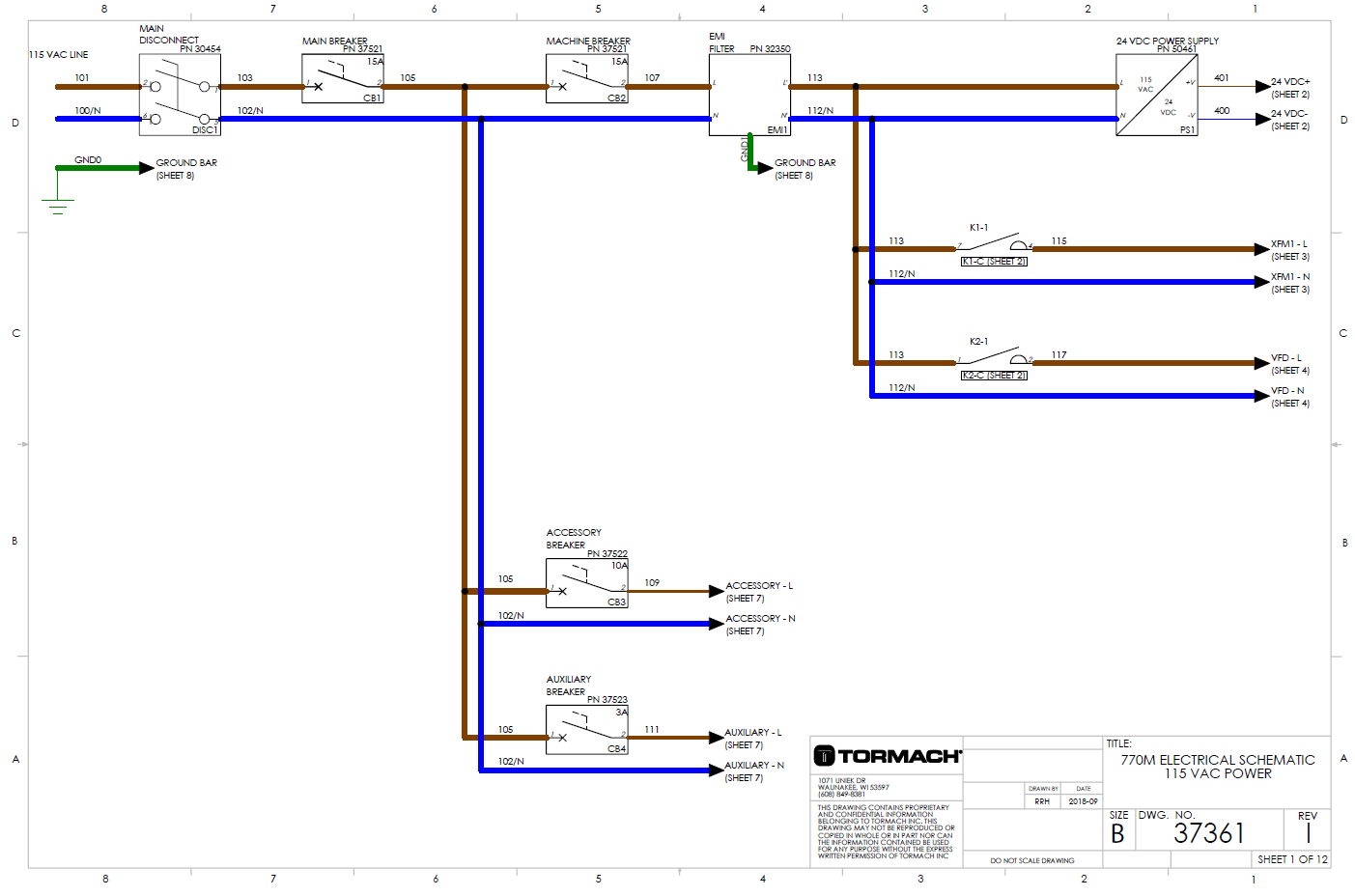

Diagrams and Parts List
115 VAC Power - 770MX
24 VDC Controls - 770MX
Axis Drive Bus - 770MX
Spindle Drive - 770MX
Machine Control Board - 770MX
Limit/Door Switches - 770MX
Grounds - 770MX
Operator Box Layout - 770MX
Wiring Table - 770MX
770MX (MF/MH) Knowledge Base
