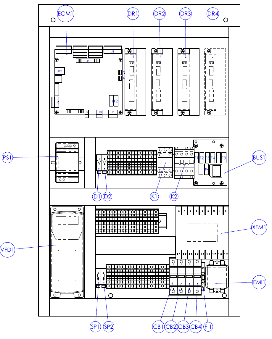

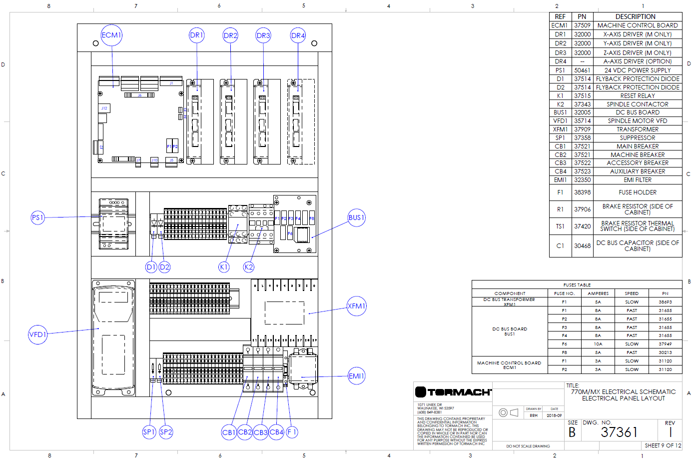

REF
PN
ECM1
37509
Machine Control Board
DR1
53488
X-Axis Driver (M Only)
DR2
53488
Y-Axis Driver (M Only)
DR3
53488
Z-Axis Driver (M Only)
DR4
32793
A-Axis Driver
PS1
50461
24 VDC Power Supply
D1
37514
Flyback Protection Diode
D2
37514
K1
37515
Reset Relay
K2
37343
Spindle Contactor
BUS1
32005
DC BUS Board
VFD1
51123
Spindle Motor VFD
XFM1
37909
Transformer
SP1
37358
Suppressor
CB1
37521
Main Breaker
CB2
37521
Machine Breaker
CB3
37522
Accessory Breaker
CB4
37523
Auxiliary Breaker
EMI1
32350
EMI Filter
F1
38398
Fuse Holder
R1
37906
Brake Resistor (Side of Cabinet)
TS1
37420
Brake Resistor Thermal Switch (Side of Cabinet)
C1
30468
DC BUS Capacitor (Side of Cabinet)
Component
Fuse No.
Amperes
Speed
PN
DC BUS Transformer XFM1
F1
5A
Slow
38693
DC BUS Board BUS1
F1
8A
Fast
31655
F2
8A
Fast
31655
F3
8A
Fast
31655
F4
8A
Fast
31655
F6
10A
Slow
37949
F8
5A
Fast
30213
Machine Control Board ECM1
F1
3A
Slow
31120
F2
3A
Slow
31120
