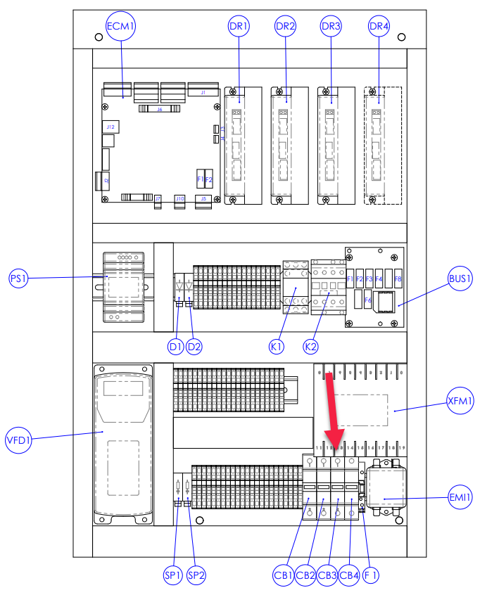

    • Reset the CB3 circuit breaker.
770MX Electrical Cabinet
