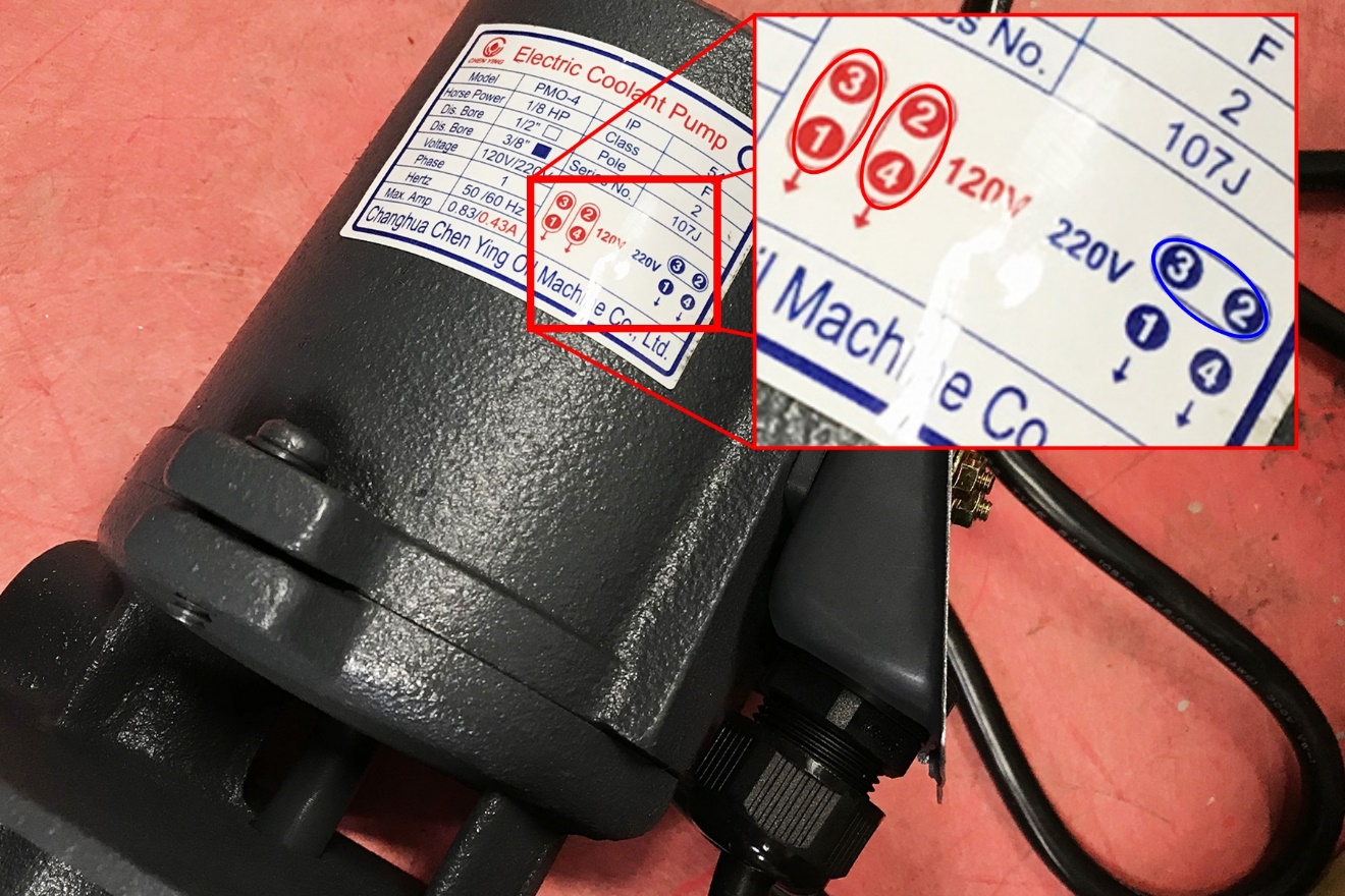

Because the coolant pump is dual voltage, you may need to adjust the motor strapping.
  1. Identify the jumper configuration diagram. The coolant pump motor strapping varies by machine:
    1. 1100 (All Models) 220 Vac (high volt)
    2. 770 (All Models) 120 Vac (low volt)
Figure 1: Coolant pump motor jumper configuration diagram.
  1. Remove the access cover on the coolant pump.
  2. Reference the configuration diagram and move the jumper to the 220 Vac (high volt) position. Don't change the position of any wires – just the jumper that connects the terminals.
Figure 2: Coolant pump motor strapping adjusted for 220 Vac.
  1. Reinstall the access cover on the coolant pump.
