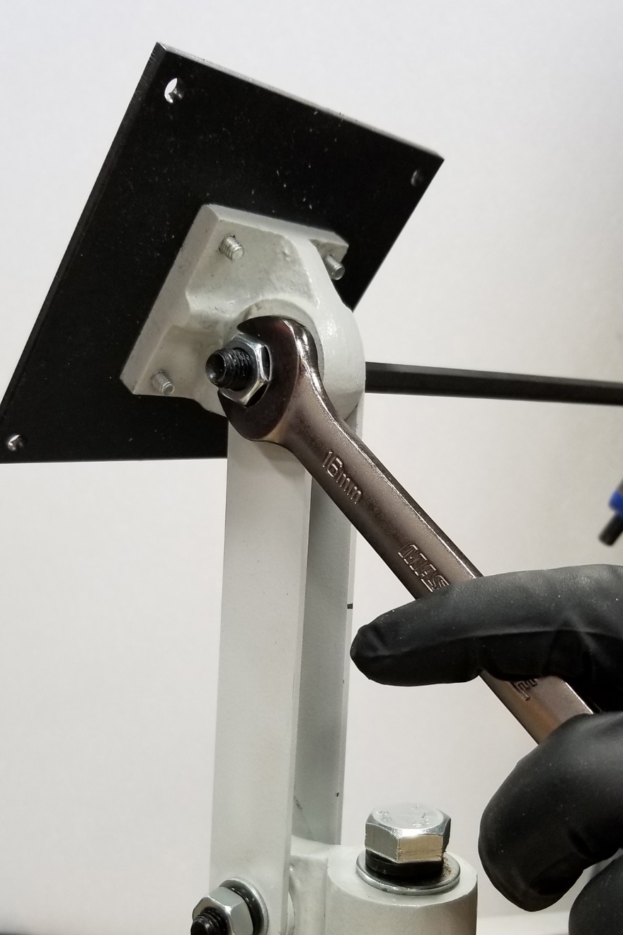

Figure 3: Incorrect and correct orientations of the monitor bracket on the Controller Arm.
Figure 4: Tightening the monitor bracket in place.
