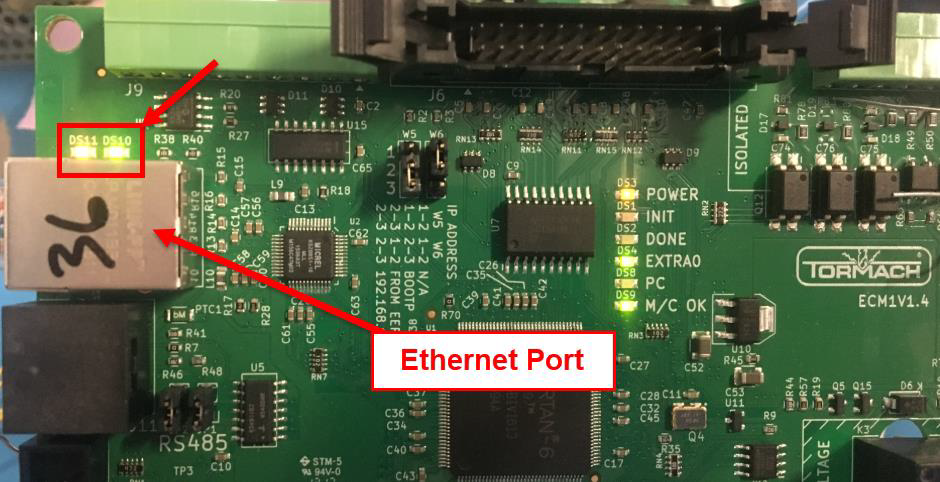

    a. If no light is present, reference Machine Won't Power On - 770MX

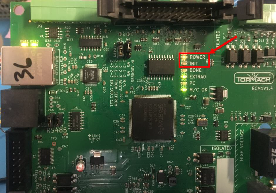

ECM Board
    If it is not lit at power up but lights up later, that means that there was a successful connection to the controller, but it has since disconnected. Go to Step #4.
ECM Board
Orange LED
OFF
Blinking
ON
ON
ON
Green LED
OFF
N/A
OFF
ON
Blinking

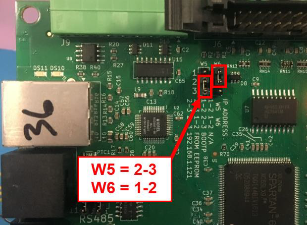

ECM Jumper Location

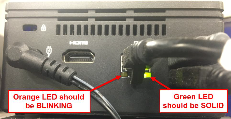

  1. Use a laptop, another computer, or a router to plug a known working cable from your device directly into the PathPilot Controller. If the orange light on the PathPilot Controller ethernet port isn’t blinking after ~15 seconds or no lights at all, then there is a configuration issue with ethernet port on the controller and continue to Step # 8. Otherwise skip to Step # 9.
Back of PathPilot Controller
