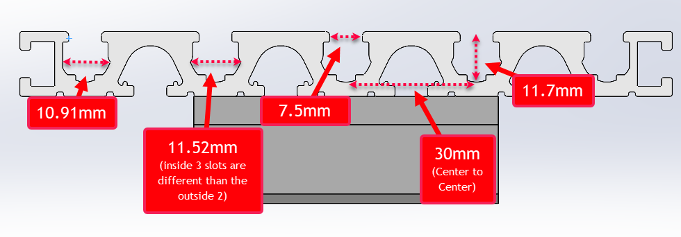

T-Slot Spacing of xsTECH
The T-slots of the xsTECH are not standard. The image below notates all of the dimensions.
