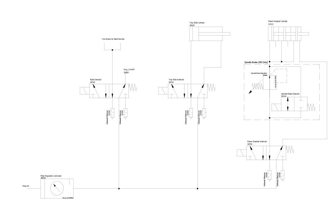

  2. Make the air line connections as follows:
    1. Connect the short air line from the left port of the lower solenoid valve to the fitting on the air cylinder that's closest to the spindle.
    2. Connect the long air line from the right port of the lower solenoid valve to the fitting on the air cylinder that's furthest from the spindle.
Figure 13: Air line connections.

  2. From the power drawbar cylinder, identify two 5/32 in. plastic tubes.
  1. Connect the loose ends of the 5/32 in. plastic tubes in the following order:
    1. Connect the Retract airline (from to the bottom push-to-connect elbow on the power drawbar cylinder) to the left push-to-connect elbow on the ATC's top solenoid.
    2. Connect the Advance airline (from the T-connector on the power drawbar cylinder) to the right push-to-connect elbow on the ATC's top solenoid.
Figure 15: Air in port in the ATC main assembly.

Schematics
Automatic Tool Changer (ATC) Pneumatics

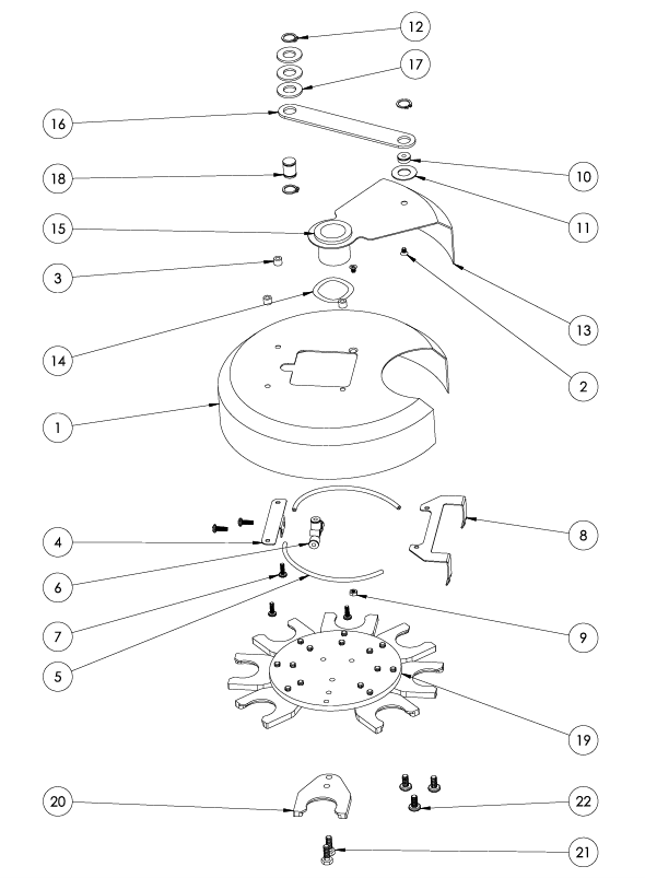

Carousel Assembly Exploded View
Carousel Assembly Parts List
ID
8-Tool Cowling (PN 35834)
M6 × 4 mm Phillips (PN 35909)
8 mm Nylon Standoff (PN 35837)
Blaster Tee Mount (PN 35838)
5-32 Air Blast Hose (PN 35918)
5-32 Tee (PN 35839)
M4 × 12 mm Pan (PN 35842)
Blaster Guide (PN 35841)
M4 Hex Nut (PN 35889)
Tray Arm Pin – Front (PN 32133)
11
Lever Arm Bearing (PN 35919)
12
12.5 mm C-Clip (PN 35844)
13
8-Tool Chip Door (PN 35845)
14
Chip Door Wave Spring (PN 35843)
15
Door Flange Bearing (PN 35835)
16
Chip Door Lever (PN 35910)
17
Lever Arm Thrust Bearing (PN 35920)
18
Tray Arm Pin – Rear (PN 32132)
19
Tool Tray Platter (PN 35862)
20
Universal Tool Fork (PN 38497)
21
M6 × 16 mm Nylon Hex Bolt (PN 32173)
22
M5 × 12 mm Pan Head (PN 35856)

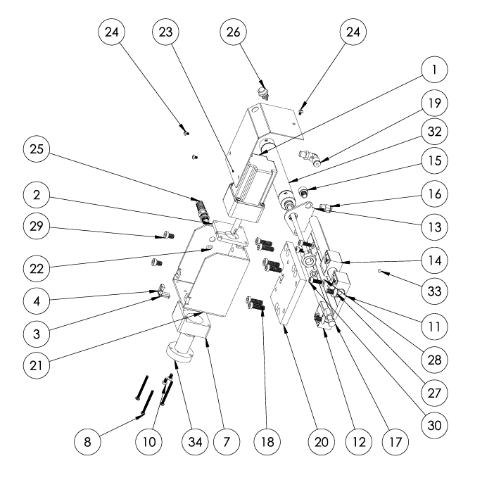

Motor and Actuator Exploded View
Motor and Actuator Parts List
ID
NEMA 23 Gear Head Motor (PN 35847)
Motor Spacer (PN 35848)
Hall Effect Sensor Module (PN 35899)
3-Pin Molex Connector (PN 35904)
1-8 Magnet (PN 35851)
Gear Motor Thrust Bearing (PN 35852)
Hub Bearing Housing (PN 35853)
M4 × 50 mm Pan Head Screw (PN 35857)
M4 × 12 mm Pan Head Screw (PN 35842)
M5 × 8 mm Low-Profile Socket Head Cap Screw (PN 35836)
11
16 mm Rail (PN 35858)
12
16 mm Shuttle (PN 35859)
13
Cylinder Mounting Plate (PN 35860)
14
Magnetized Shuttle (PN 35881)
15
M10 × 10 mm Socket Head Cap Screw (PN 35861)
16
5-32 × 1-8 NPT Male Connector (PN 35863)
17
Air Cylinder Rod Coupling (PN 35864)
18
M8 × 25 mm Socket Head Cap Screw (PN 35865)
19
5-32 × 1-8 NPT Elbow (PN 35905)
20
Motor Chassis Slide Plate (PN 35868)
21
Motor Housing (PN 35869)
22
5-32 Grommet (PN 35855)
23
Motor Housing Cover (PN 35873)
24
M4 × 6 mm Pan Head Screw (PN 35871)
25
Flex Cable Retainer – 1/4 NPT (PN 32139)
26
Waterproof Button (PN 35870)
27
M8 × 18 mm Flat-Head Cap Screw (PN 35872)
28
M6 Washer (PN 35874)
29
M8 × 12 mm Low-Head Socket Head Cap Screw (PN 35875)
30
M6 × 18 mm Socket Head Cap Screw (PN 35876)
31
M4 × 18 mm Flat-Head (PN 35877)
32
Air Cylinder (PN 35849)
33
1-4 magnet (PN 35854)
34
Taper Lock Hub (PN 35850)

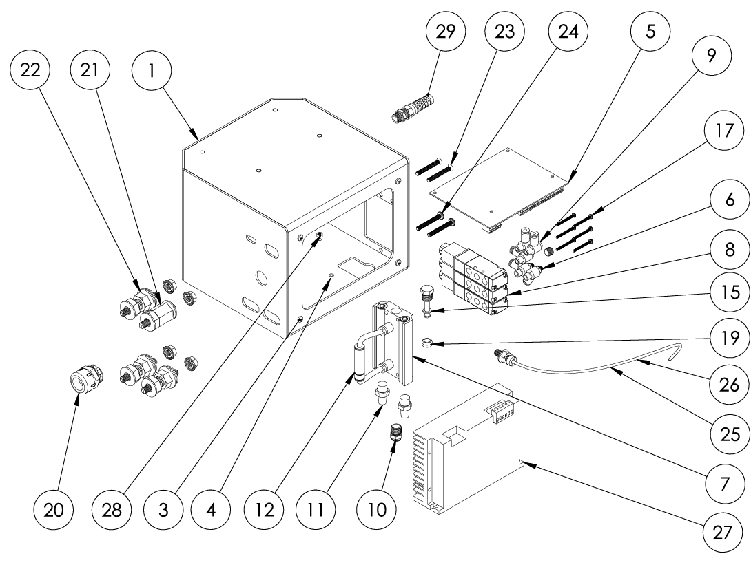

Mount and Control Exploded View
Mount and Control Parts List
ID
Mounting Box (PN 35879)
Back Plate (PN 35880)
3.5 mm Mono Jack (PN 35907)
ATC Control Board (PN 35901)
Meter Out Elbow 5-32 × 1-8 NPT (PN 35883)
Air Manifold (PN 35884)
Double Acting Solenoid 1-8 NPT (PN 35885)
5-32 × 1-8 NPT Elbow (PN 35886)
5-32 × 1-8 NPT Male Connector (PN 35887)
11
Muffler (PN 35888)
12
Check Valve In Line
13
10-32 × 1/4 Push Connector (PN 32169)
14
1-4 NPT Hex Plug (PN 35890)
15
Air Isolator Baffle (PN 35891)
16
1-8 NPT Hex Plug (PN 35892)
17
M3 × 30 mm Pan Head Screw (PN 35895)
18
M3 × 4 mm Pan Head Screw (PN 35903)
19
O-Ring (PN 35914)
20
3-8 NPT Conduit Terminator (PN 35896)
21
Cam Tilt Adjuster Standoff (PN 35911)
22
Length Adjuster Standoff (PN 35833)
23
M5 × 40 mm Flat-Head Screw (PN 35917)
24
M5 × 40 mm Pan Head Screw (PN 35846)
25
Hall Effect Sensor Assembly, 10 mm Serial #0 - 60 (PN 35867)
26
Hall Effect Sensor Assembly, 8 mm Serial #61+ (PN 35866)
27
Stepper Driver (PN 32793)
28
29
30
M4 × 12 mm Flat-Head Screw
