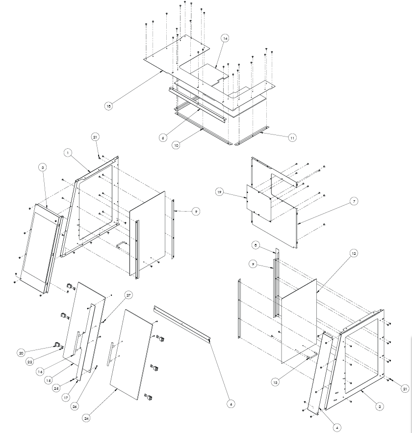

Install the Enclosure Panels
Tip! To install the enclosure panels, work from the left to the right of the machine.
To make it easier to install all components, don't install the side windows until later in the procedure.
Keep all screws one quarter-turn loose while installing the enclosure panels. This makes it easier to align the panels. Once you're done installing the enclosure, fully tighten all screws.
Install the Left Rear Panel

Install the Left Side Panel
  1. Attach the left side panel to the left rear panel with four M5 × 0.8 - 10 screws.
Figure 4: Left side panel attached to the left rear panel.
  1. Attach the left side panel to the left chip pan with four M5 × 0.8 - 10 screws.
Figure 5: Left side panel attached to the left chip pan.

Install the Left Front Panel
  1. Loosely attach two M5 × 0.8 - 10 screws to the chip pan.
  2. Slide the left front panel over the two screws that you installed in Step 1.
Figure 7: Left front panel attached to the left chip pan.
  1. Attach the left front panel to the left side panel with four M5 × 0.8 - 10 screws.
Figure 8: Left front panel attached to the left side panel.
Install the Right Side Panel
  1. Loosely install two vertical window retainers on both sides of the right side panel's window opening with two sets of four M5 × 0.8 - 10 screws.
Figure 9: Right side window retainers attached to the right side panel.
  1. Attach the right side support to the right side panel with four M5 × 0.8 - 10 screws.
Figure 10: Right side support attached to the right side panel
  1. Attach the right side panel to the right chip pan with four M5 × 0.8 - 10 screws.
Figure 11: Right side panel attached to the chip pan.
  1. (Optional) If required, pull the chip pan forward while pushing the machine backward until you can secure the screws in place.
Install the Right Front Panel
  1. Loosely attach one M5 × 0.8 - 10 screw to the chip pan.
  2. Slide the right front panel over the screw that you installed in Step 1.
Figure 12: Right front panel attached to the right chip pan.
  1. Attach the right front panel to the right side panel with four M5 × 0.8 - 10 screws.
Figure 13: Right front panel attached to the right side panel.
Install the Top Panel
  1. Loosely attach two short, vertical window retainers to both sides of the top panel with three sets of M5 × 0.8 - 10 screws.
  2. Loosely attach the long, vertical window retainer to the top panel with three M5 × 0.8 - 10 screws.
Figure 14: Window retainers attached to the top panel.
  1. Remove and discard the protective plastic film from the window.
  2. Slide the window into the three installed window retainers. Take care not to scratch the window.
  3. Attach the top panel assembly to the enclosure with 12 M5 × 0.8 - 10 screws, as shown in the following image.
Figure 15: Top panel attached to the enclosure.

Enclosure Exploded View
