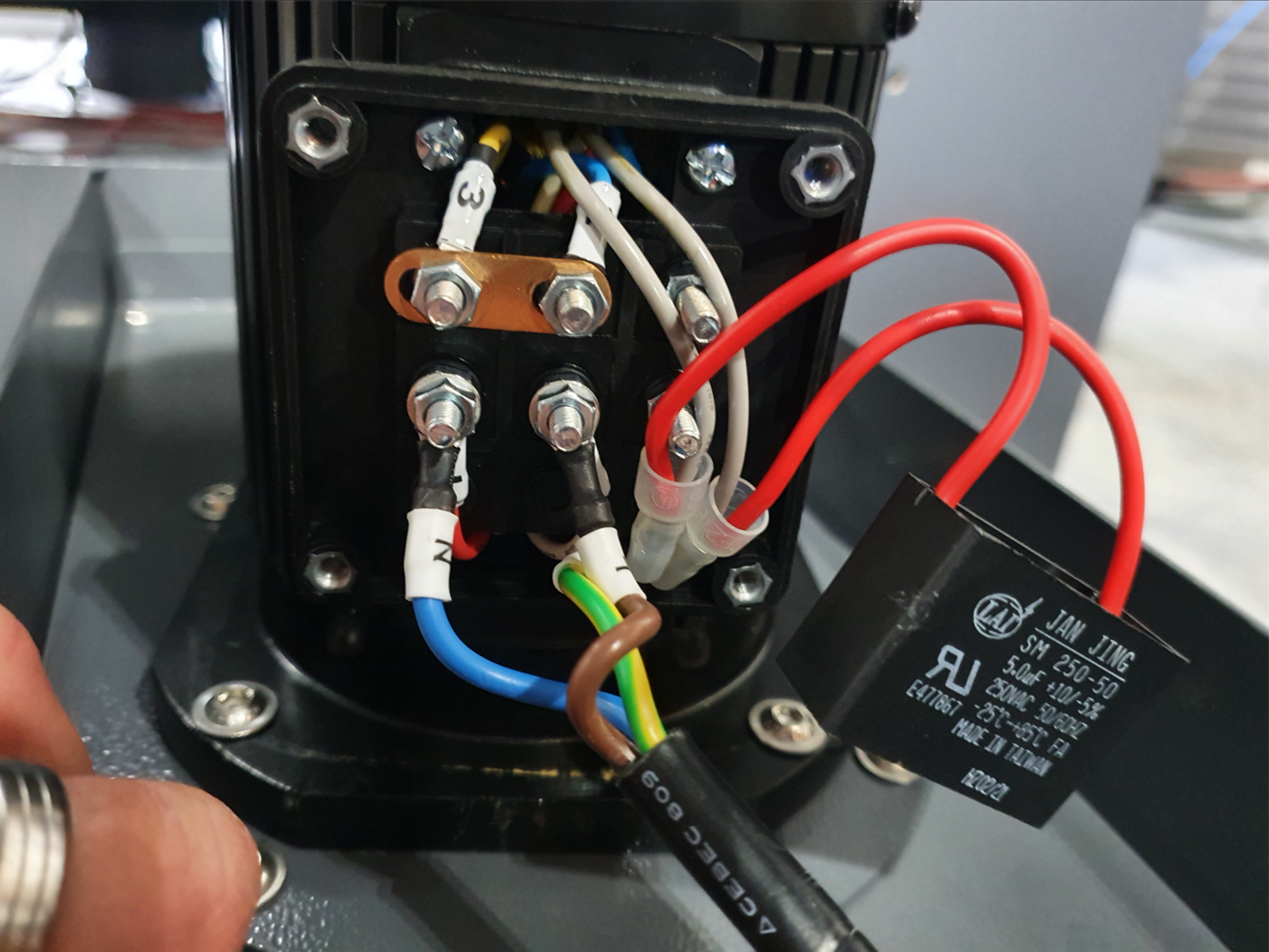

Reseat the Coolant Pump Power Cord

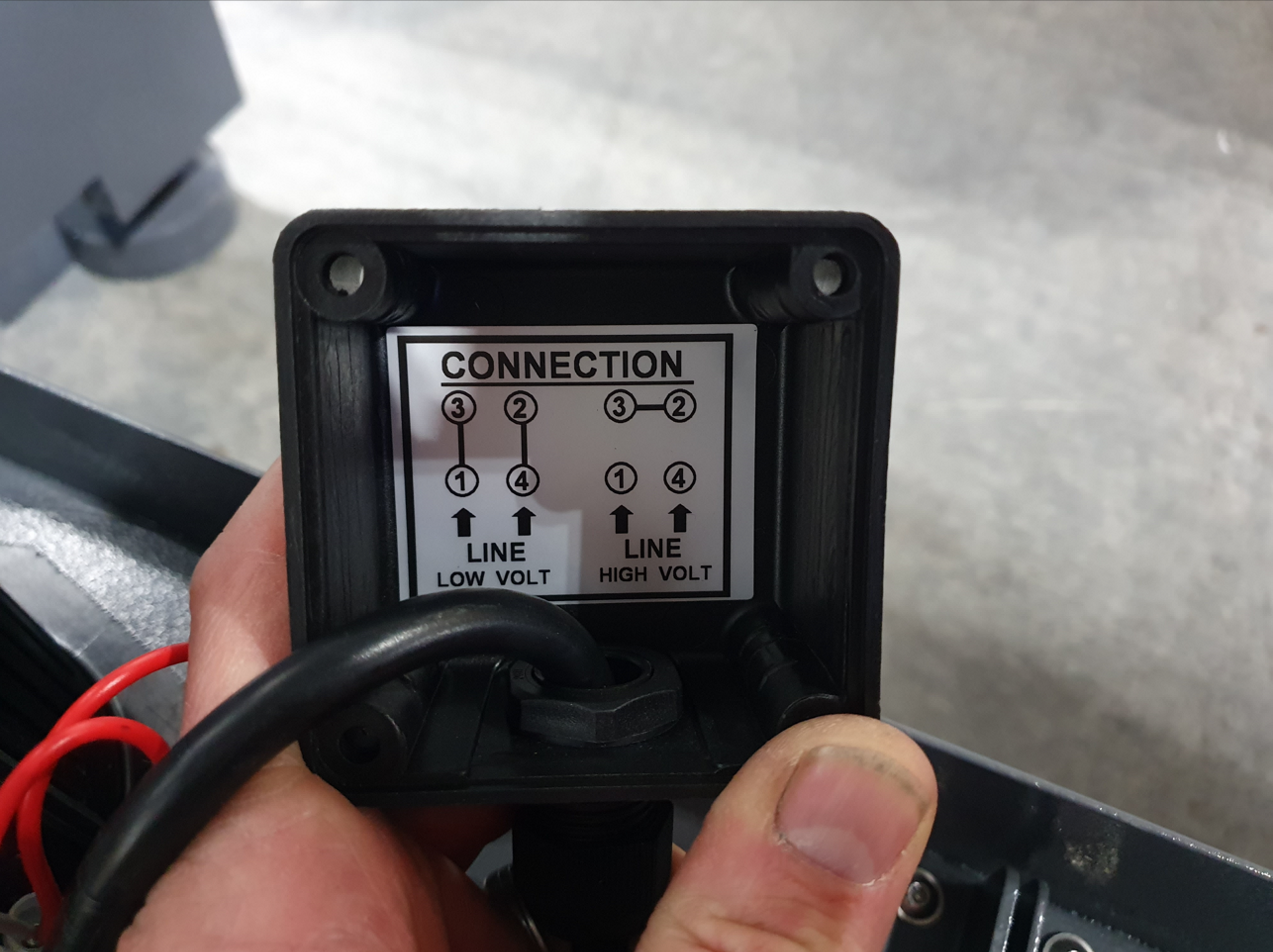

Inspect the Coolant Pump Strapping
Your pump should be wired for low volt configuration.

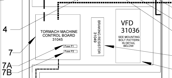

Inspect Fuse F2 on Machine Control Board
Reason: Fuse F1 on the machine control board is blown.
  1. Power off the machine.
  2. Locate and remove the F2 fuse from the machine control board (7B).
    2. If the fuse measure 0-5 Ω, reinstall it into the machine control board.
If the coolant pump shorts, the 3 A, slow-blow, F1 flood coolant fuse on the ECM1 control board blows before CB3 trips.
