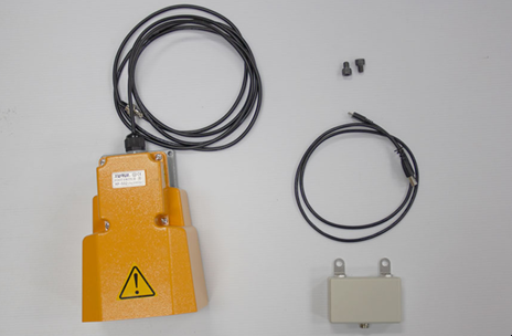

Product: Collet Closer Foot Pedal Kit (PN 39407)
Foot Pedal
Foot Pedal Control Box
M8 Fastener
USB Cable

  2. Find the two M8 fasteners and the foot pedal control box provided with this kit.

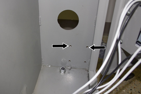

  4. Inside the controller cabinet, on the back wall, identify the four holes (originally used to raise the machine off of its shipping pallet). To mount the foot pedal control box, you'll use the top two holes.
Figure 1: Mounting hole location on the back wall of the controller cabinet.

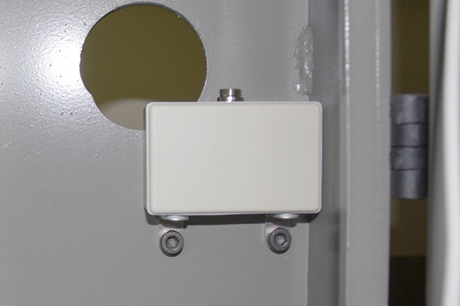

  1. Mount the foot pedal control box to the controller cabinet with two M8 fasteners and a 6 mm hex wrench. Verify that the foot pedal control box is oriented as shown in the following image. The USB port must point toward the bottom of the controller cabinet.
Figure 2: Foot pedal control box mounted to the controller cabinet.

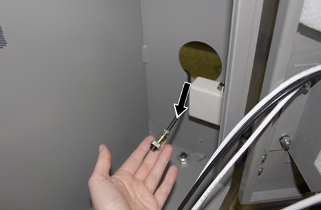

  1. Put the foot pedal in the desired location (near the front of the electrical cabinet).
  2. Route the foot pedal cable around the back of the machine and toward the access hole in the controller cabinet.
NOTICE! Don't route the foot pedal cable underneath the machine. If you do, it could interfere with the casters on the coolant tank, which may cause damage to the foot pedal cable.
  1. Route the foot pedal cable through the access hole in the controller cabinet and toward the foot pedal control box that you mounted in Step 5.
Figure 3: Moving the foot pedal cable through the access hole in the controller cabinet.

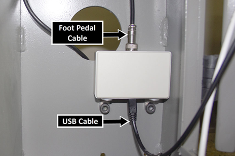

  1. Connect the cable to the control box, and then secure it with the locking collar.
  2. Find the USB cable provided with this kit. Then, connect one end to the USB port on the foot pedal control box.
Figure 4: Cable connections on the foot pedal control box.
  1. Connect the loose end of the USB cable to a USB port on the PathPilot controller.
