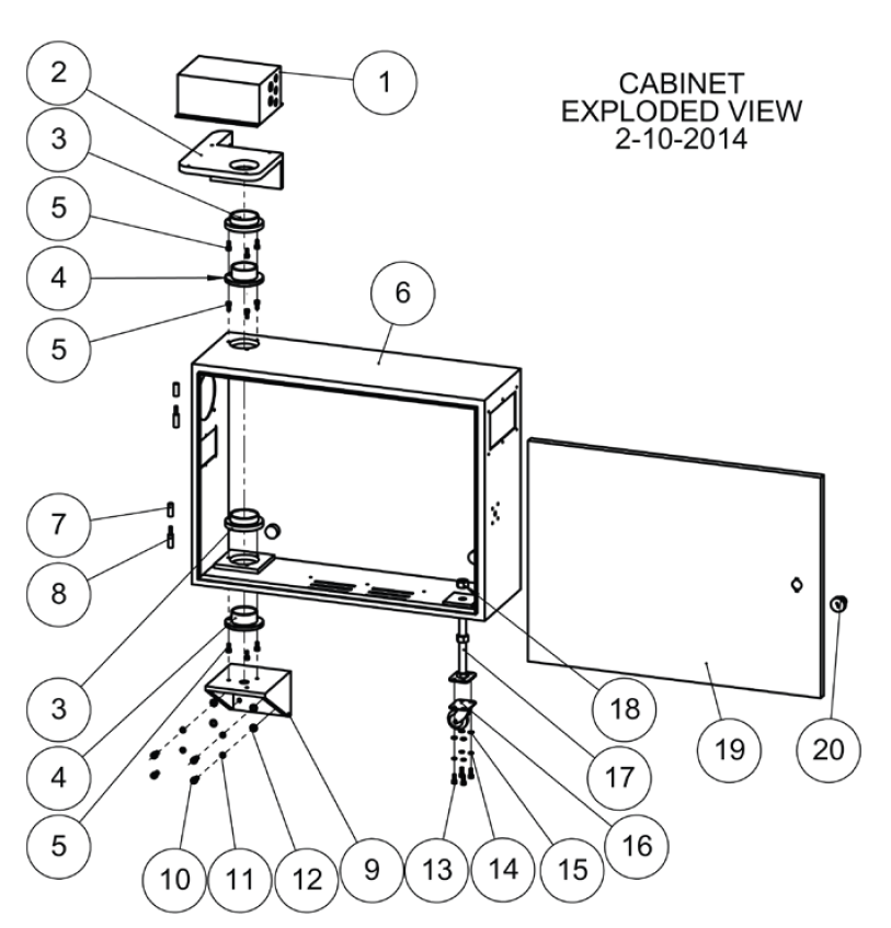

Lathe Cabinet Hardware - 15L
Alternative Part Number
Junction Box (PN 34135)
Top Hinge Mount (PN 34136)
Upper Hinge Collar (PN 34137)
Lower Hinge Collar (PN 34138)
Screw, M5 x 12
McMaster-Carr: 91290A228
Cabinet*
Hinge Body (welded)*
Hinge Pin (welded)*
Bottom Hinge Mount*
Screw, M8 x 16
McMaster-Carr: 96144A216
11
Washer, Lock M8
McMaster-Carr: 92148A200
12
Washer, Flat M8
McMaster-Carr: 93475A270
13
Screw, M6 x 16
McMaster-Carr: 96144A116
14
Washer, Lock M6
McMaster-Carr: 92148A180
15
Washer, Flat M6
McMaster-Carr: 93475A250
16
Wheel*
17
Wheel Point*
18
Nut, M16
McMaster-Carr: 90591A220
19
Cabinet Door*
20
Door Latch (PN 30467)
