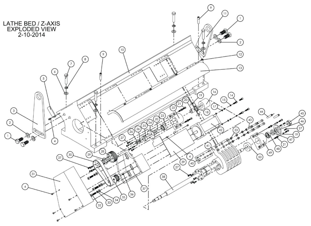

15L Knowledge Base
Lathe Bed Z-Axis - 15L
Alternative Part Number
Bolt, M16 x 35
McMaster-Carr: 91280A839
Washer, Lock M16
McMaster-Carr: 92148A241
Lifting Hanger RH*
Screw, M8 x 8
McMaster-Carr: 92095A493
Z Limit Switch Stop*
Washer, Flat M12
McMaster-Carr: 93475A290
Bolt, M12 x 55
McMaster-Carr: 95327A684
Washer, Lock M12
McMaster-Carr: 92148A214
Pin, M10 x 45*
Bed Casting*
11
Lifting Hanger LH*
12
Screw, M5 x 10
McMaster-Carr: 92095A208
13
Ballscrew Cover, Z-axis*
14
Screw, M5 x 20
McMaster-Carr: 91290A370
15
Washer, Lock M5
McMaster-Carr: 92148A170
16
Bumper, Z-axis RH (PN 34170)
17
Washer, Flat M5
McMaster-Carr: 93475A240
18
Seal, Z-Axis Ballscrew (PN 34172)
19
Pin, M6 x 30 (PN 34173)
20
Spacer, Z Screw Bearing*
21
Screw, M6 x 25
McMaster-Carr: 96144A125
22
Bearing Mount Block RH (PN 34176)
23
Bearing, Z Ballscrew Mount RH (PN 34177)
ABEC Identification: 7003B/DB/P5 (1 unit includes a bearing pair)
24
Bearing Cap*
25
Spanner Nut, M17 x 1 (PN 34179)
26
Spacer, Z Pulley*
27
Screw, M5 x 12
McMaster-Carr: 91290A228
28
Pulley, Z Ball Screw*
29
Pulley Mount Flange Z Screw*
30
Belt, Z-axis Drive (PN 34184)
31
Belt Cover, Z-axis (PN 34185)
32
Screw, M8 x 30
McMaster-Carr: 96144A219
33
Washer, Lock M8
McMaster-Carr: 92148A200
34
Washer, Flat M8
McMaster-Carr: 93475A270
35
Pulley, Z Motor (PN 34189)
36
Set Screw, M6 x 10
McMaster-Carr: 91390A128
37
Z Motor Mount*
38
Ball Screw, Z-axis Lathe (PN 33224)
39
Motor Cover*
40
Mount Pad, Z Carrier*
41
Carrier, Z Ballscrew*
42
Z-axis Stepper Motor (PN 33066)
43
Screw, M8 x 50
McMaster-Carr: 96144A231
44
Pin, M8 x 65*
45
Spanner Nut, M15 x 1 (PN 34197)
46
Bearing Cap (PN 34198)
47
Felt Washer*
48
Bearing, Z Ballscrew Mount LH (PN 34200)
ABEC Identification: 6003-22
49
Bearing Mount Block LH (PN 34201)
50
Bumper, Z-axis LH (PN 34202)
