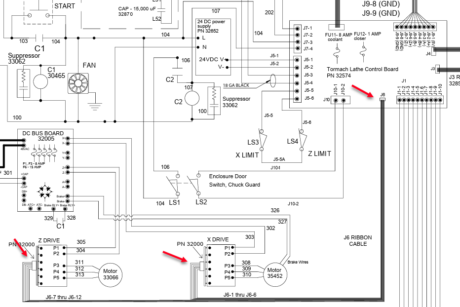

Reseat the connectors on the machine control board and motors
  1. Power off the machine.
    1. Machine control board: J6 (16 pin IDC ribbon cable)
      1. J6-1 - J6-6 (X Axis)
      2. J6-7 - J6-12 (Z Axis)

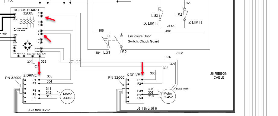

  1. Examine the power and control cables at the DC-Bus and the stepper driver controllers removing, inspecting, and re-connecting them to ensure they are seated.
    1. DC-Bus/Stepper driver controllers: Spade connectors/Degson Style
      1. 302/303 (X-axis)
      2. 304/305 (Z-axis)

Inspect the DC-Bus board
    1. If the green LED is not illuminated: Go to All Axes Won't Move When Commanded - 15L

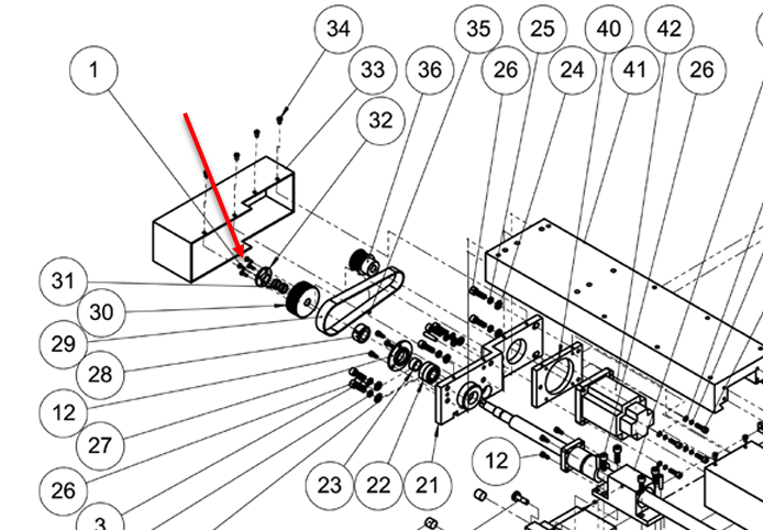

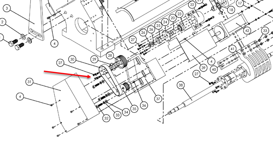

Check Pulley Hubs
Reason: Axis pulley is loose.
  1. Tighten the indicated bolts on the X and Z axis pulley hubs.
X Axis Pulley Screws
Z Axis Pulley Screws
