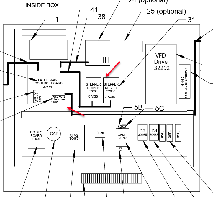

Reseat the connectors on the machine control board and motors

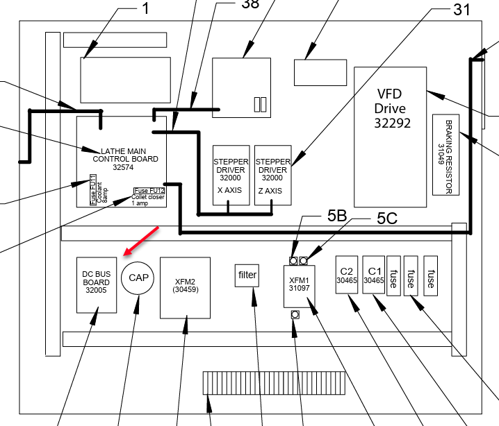

  1. Inspect the stepper driver controller lights.
    1. Some controller lights are on: One Axis Won't Move (or Only Moves in One Direction), and Other Axes Move - 15L.
    2. All the controller lights are off: Continue to the next step.
  2. Power off the machine.

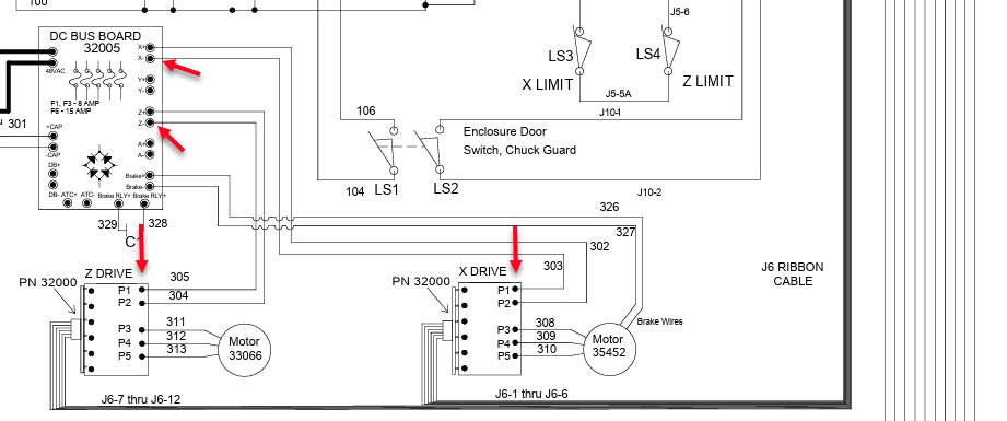

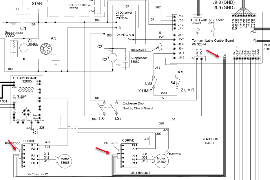

  3. Examine the data cable at the machine control board and the axes drivers.
    1. Machine control board: J6 (16 pin IDC ribbon cable)
      1. J6-1 - J6-6 (X Axis)
      2. J6-7 - J6-12 (Z Axis)
15L Main Control Board and Driver Locations
    1. DC-Bus/Stepper diver controllers: Spade connectors/Degson style
      1. 302/303 (X-axis)
      2. 304/305 (Z-axis)
15L DC-BUS Location

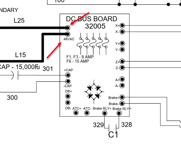

Inspect the DC-BUS board
Reason: The DC-BUS is malfunctioning.
    1. If it does: The motors or stepper driver controllers will be illuminated, if the DC Bus Axis Fuses are not blown. To learn how to check individual fuses, see: One Axis Won't Move (or Only Moves in One Direction), and Other Axes Move - 15L | Inspect the DC Bus board
    1. L15 (J2)
    2. L25 (J1)
15L DC-BUS

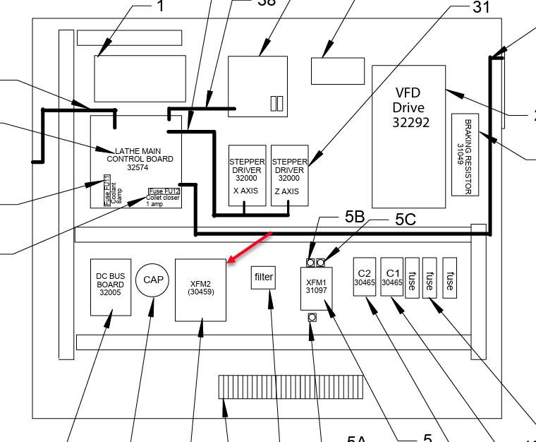

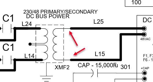

Inspect the XMF2 Transformer
Reason: The transformer is shorted
  1. Power off the machine.
  2. Remove L25 and L15 from the transformer.
15L XFM2 Location
  1. Power the machine back on.
  2. Take an AC reading between the terminals L25 and L15 were on.
  3. If you do not see 48 Vac, continue to the next troubleshooting step.

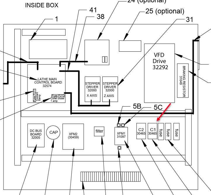

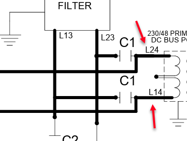

Check the C1 Contactor
Reason: The C1 is defective.
  2. Inspect the C1 to see if the center bar has been pulled in.
    1. If bar is in: The C1 is latched. Using a digital multimeter set to Vac, measure for 220 Vac between:
      1. L14
      2. L24
15L C1 Location
  1. Press and hold the Reset button on the operator box and observe the C1. Then release the Reset button and observe the C1.
    1. If the bar only stays in when the button is pressed: There is a loose coil wire, short, or the C1 has malfunctioned.
    2. If the bar never gets pulled in: See Machine Won't Power On - 15L.
