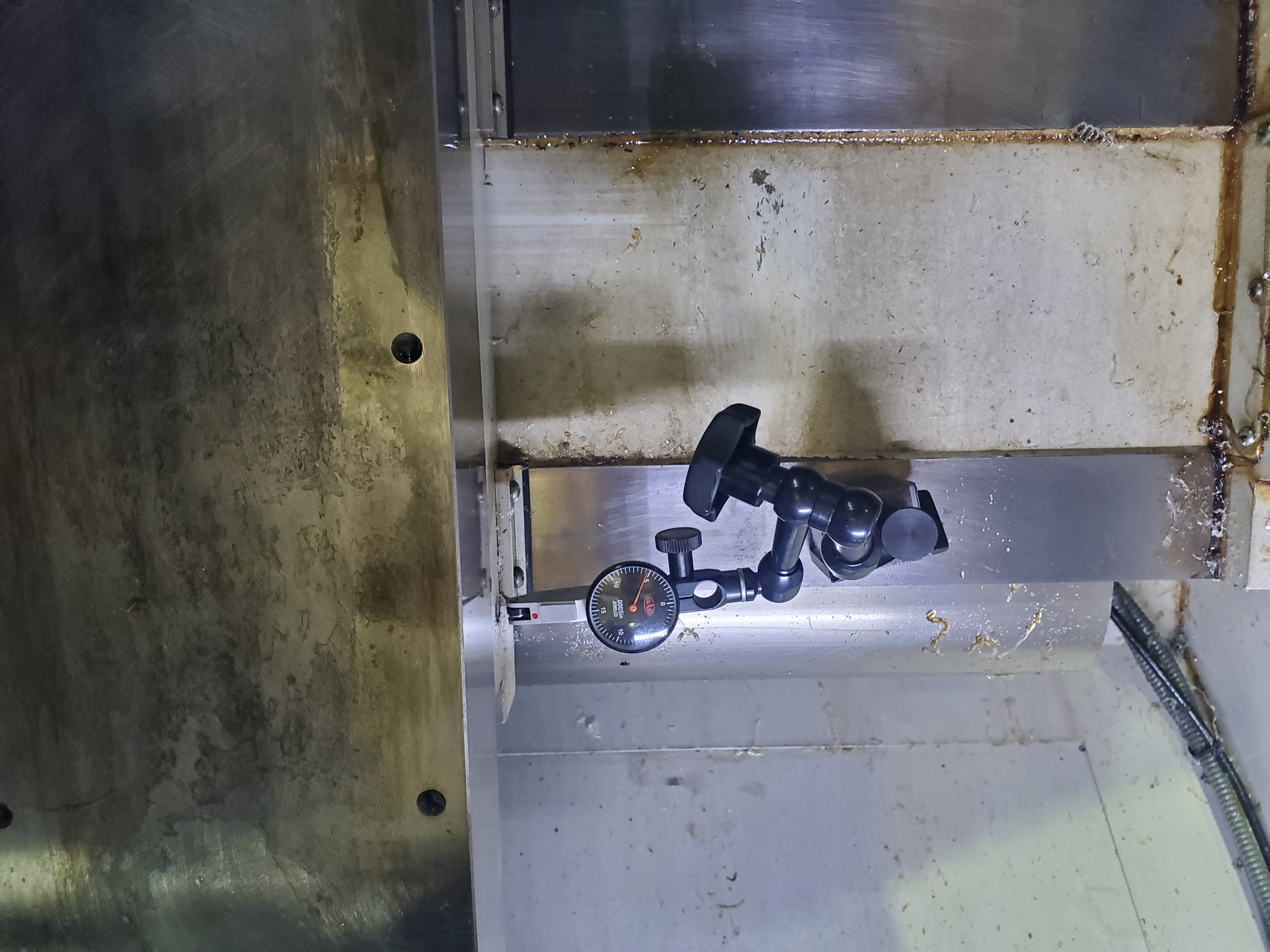

Measuring Lost Motion
The following method describes the proper procedure to measure Z-axis backlash. An analogous procedure is used to measure X-axis lost backlash.
  1. Mount a dial indicator to the machine bed along the Z-axis with the tip in line with the x axis carriage. Be sure that the indicator needle will touch a machined surface.
  2. Jog the X- and Z-axis to position the carriage so the indictor tip contacts the edge of the carriage.
  3. Carefully jog the Z-axis in the negative direction until the indictor contacts the spindle. After initial contact, continue to jog the Z-axis in the negative direction so that the dial makes at least one complete revolution; stop when dial reads 0.
  5. In MDI field, program a negative Z move of .01” at a feed rate of 5 IPM: G01 X.01 F5. The carriage moves slightly in -Z direction. When finished, indictor should read .010”.
  6. Program a Z move back to 0: G01 X0 F5. The carriage moves slightly in the +Z direction. The Z DRO should say 0; however, the dial indicator should read a number very close to 0. This value is the measured lost motion.

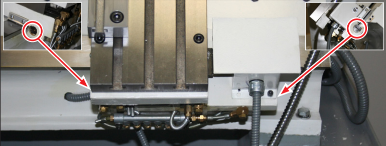

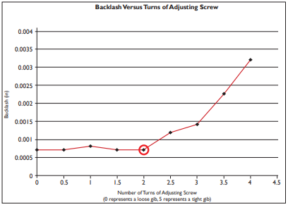

Gib Adjustment
The adjustment procedure is similar for both axes. The Z-axis is described in detail. The gib plate is tapered from right to left. When the gib plate is moved in the Z negative direction (to the left of the operator), the Z-axis saddle the slide way tightens; when it moves in the Z positive direction, the slideway loosens.
  1. Loosen the right screw eight turns and tighten the left screw eight turns so that the gib clearance is loose.
  2. Use a dial indicator to measure the axis backlash. With a very loose gib, the measured backlash is entirely attributable to the backlash in the belt reduction drive, the angular contact bearings, and the ball nut. On a newer machine, the value should be under 0.0025” on either axis.
  3. Tighten the gib by one turn (by loosening the lower screw first, then tightening the upper screw). Measure the backlash again.
  4. Repeat this procedure until the measured backlash increases – this is the point at which the gib setting has started to induce lost motion in the axis.

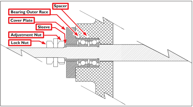

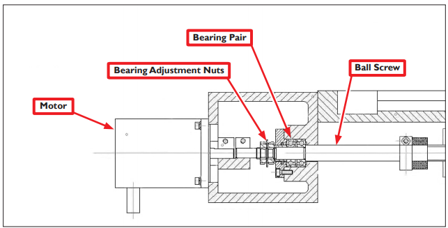

The figure to the above shows how the force of preload is transmitted through the bearings, from the inner race to the outer race. In a preload pair, this force is then transmitted back to the inner race by an opposed bearing. It should be apparent that the correct orientation of the angular contact bearing is critical to the operation.

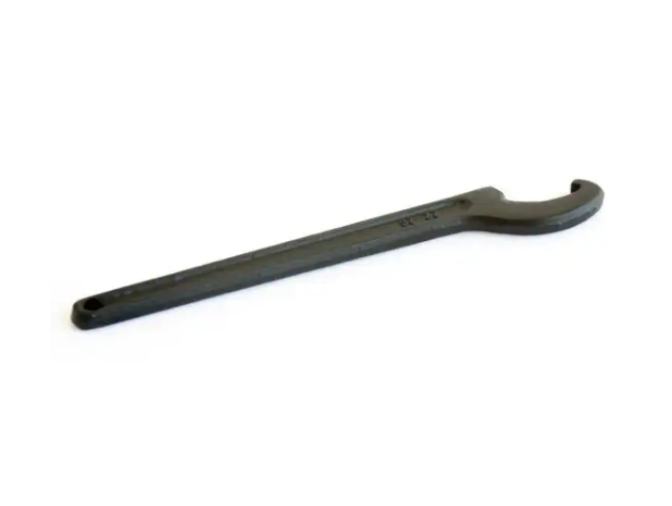

To adjust the angular contact bearing pair preload on the 15L, two 22-26mm Hook Spanner Wrenches can be used.
To properly estimate the torque needed to overcome angular contact bearing friction, the bearings must be isolated from the motor detent torque. The following procedure illustrates the Z axes of the 15L; other axes will follow suit:
  1. For adjusting the Z-axis, position the table near the right hand end of its travel (i.e., Z near to zero). This ensures that the bearing is near to the ball nut to minimize bending of the screw during tests.
  2. Remove the enclosure right side panel, the motor cover plate, and the Z-axis motor mount cover plate.
  4. Loosen four cap screws holding the axis motor to the motor mount and remove the drive belt. Take care not to put any strain on the motor wires.
  5. Remove the ball screw pulley.
  6. Rotation should be smooth with a small perceptible drag; this corresponds to a medium preload of about 150 pounds. If the rotation feels tight, you have too much preload and will dramatically shorten the life of the bearings. If the rotation is free, you have little or no preload and backlash will be excessive. This test should be done with the lock nut tight.

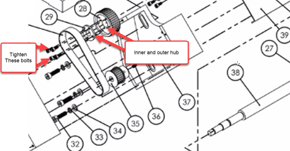

Loose Z Axis Pulley
A cause of lost motion exclusive to the 15L, is a loose Z axis pulley.
