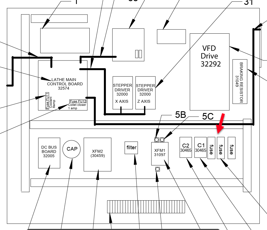

Check the FU1 and FU2 Fuses
Reason: Fuse is blown.
  1. Identify your machines main fuses.
15L FU1 and FU2 Location
  1. Power down the machine, and remove both fuses.
  2. Check both fuses using the following process: Checking a Fuse on a Tormach Machine .
  3. If any fuse is blown, replace it.

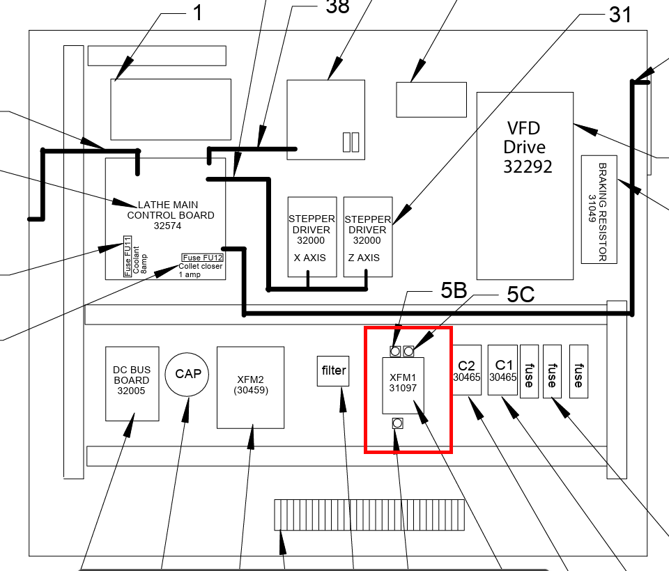

Inspect the XFM1 Transformer
Reason: Transformer fuse blown or transformer shorted.
  1. Take a Vac reading between wires 100-102.
  2. If no voltage is present, power down the machine, and check all three fuses on the transformer.
XFM1 Transformer and Fuse Location

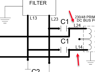

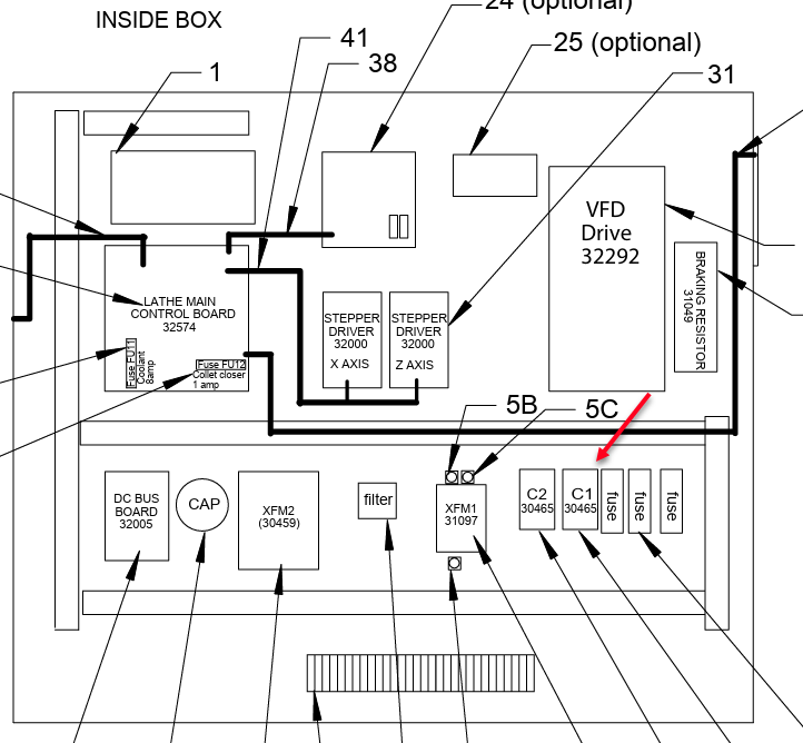

Check the C1 Contactor
Reason: The C1 is defective.
  2. Inspect the C1 to see if the center bar has been pulled in.
    1. If bar is in: The C1 is latched. Using a digital multimeter set to Vac, measure for 220 Vac between:
      1. L14
      2. L24
15L C1 Location
  1. Press and hold the Reset button on the operator box and observe the C1. Then release the Reset button and observe the C1.
    1. If the bar only stays in when the button is pressed: There is a loose coil wire, short, or the C1 has malfunctioned.
    2. If the bar never gets pulled in: Go back to the previous troubleshooting topics to ensure your machine is receiving power.

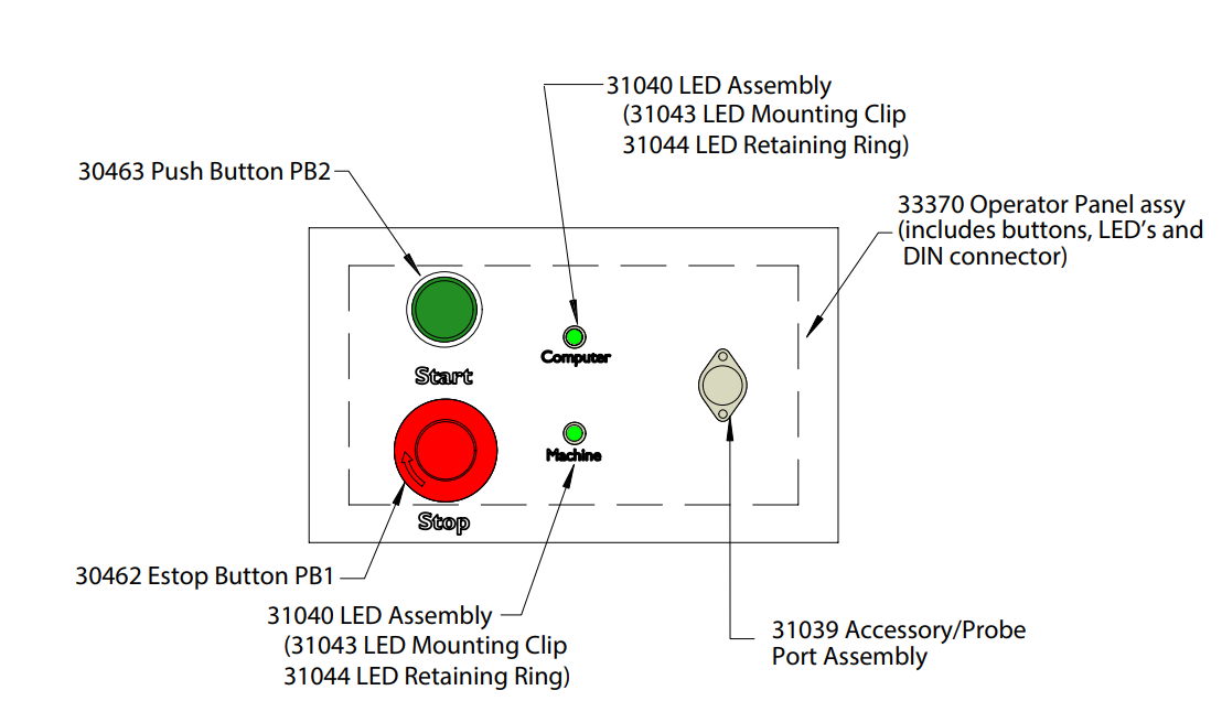

Our main indicator of the source of the fault is the machine LED light on the 15L’s electrical cabinet. It’s status indicates which subsystem to begin checking for the estop fault.
  • Dark - the estop circuit has been interrupted
  • Solid - communication with Pathpilot has dropped
  • Blinking 50/50 on/off - VFD has faulted
  • Blinking 10/90 on/off - turret tool change has failed

  1. Verify that the estop buttons are not tripped. The 15L is equipped with two estop buttons:
    1. On the front of the electrical cabinet
    2. On the tray of the controller arm

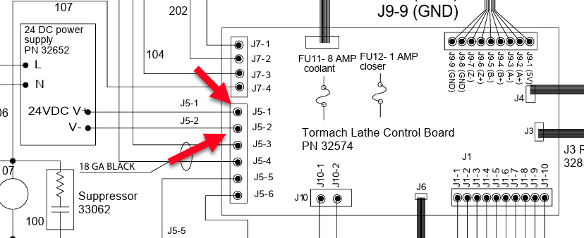

  3. Verify that the 24v DC power supply is outputting at least 24v and less than 28v.
  4. Verify that the main control board is receiving 24v DC power by measuring between terminals J5-1 and J5-2.
