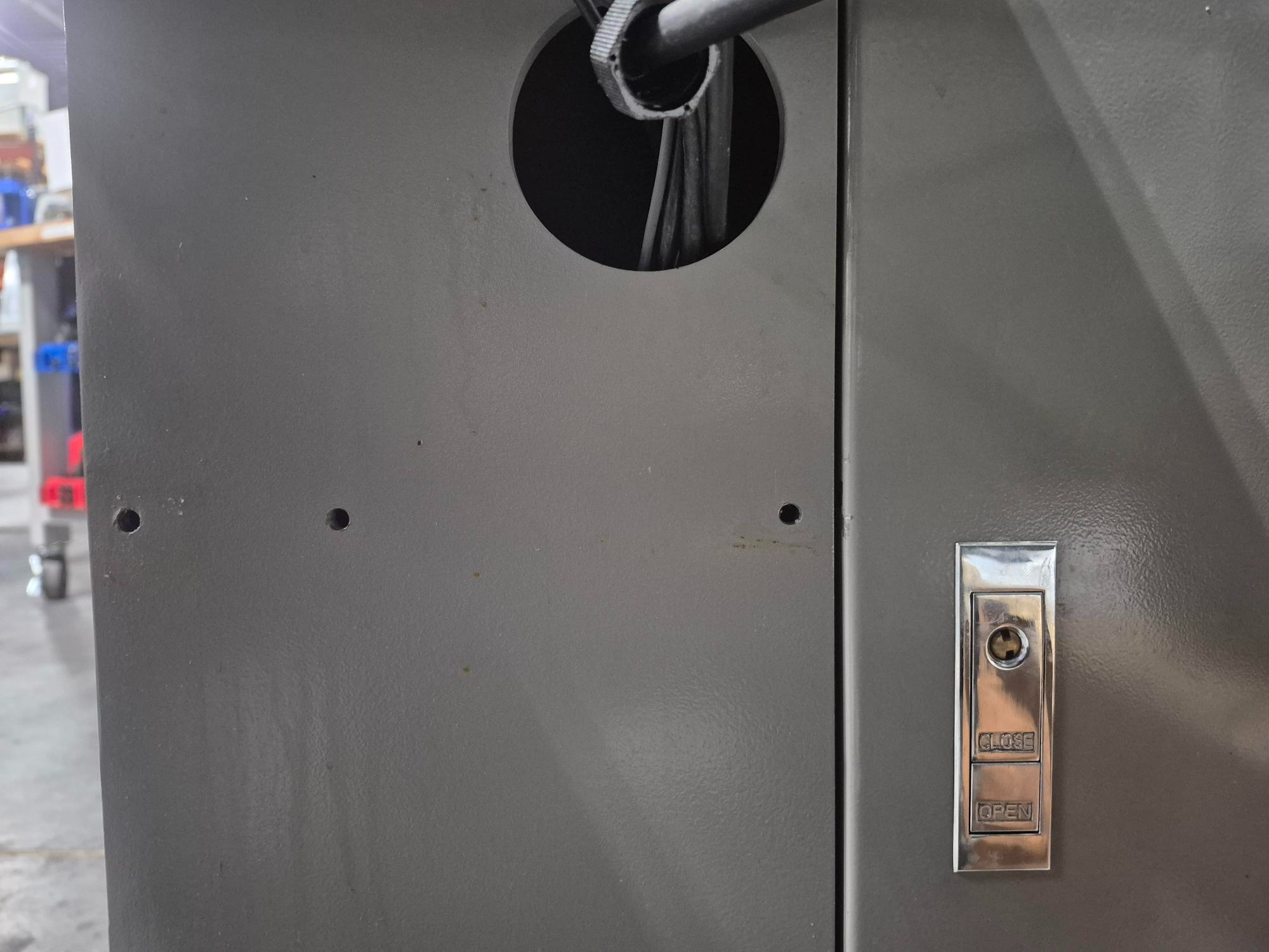

  1. Using two M6 x 15 mm socket head cap screws, mount oiler to pre-drilled holes on side of lathe (see Figure 3).
Figure 3

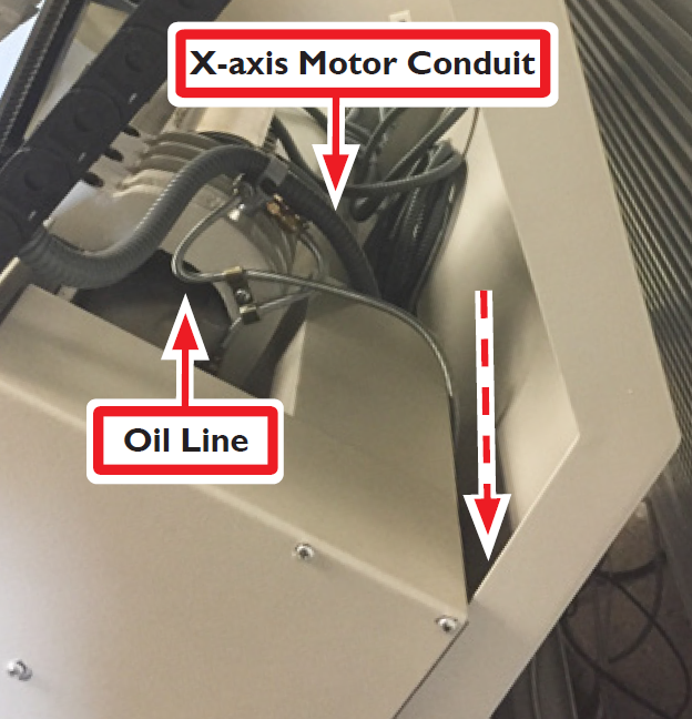

    1. Following the X-axis motor conduit toward the lathe bed (see Figure 4)
Figure 4

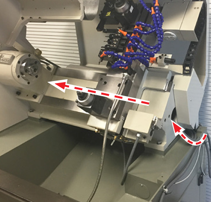

b. Through the access hole in the lathe bed casting toward the spindle (see Figure 5)
Figure 5

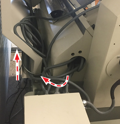

c. Through the opposite access hole in the lathe bed casting toward the back of the lathe (see Figure 6)
Figure 6
