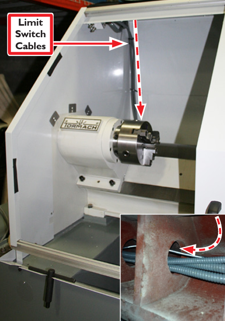

  1. Attach the lathe light with bracket to lathe enclosure ceiling with four 10-32 × 7/16 in. pan head screws. The holes in the enclosure are pre-threaded.
Figure 1: Mounting location on the inside of the lathe's enclosure.
  1. Route the light cord along with the limit switch cables, going around the back and through the lathe casting.
  1. Secure the cord to the limit switch cables with the provided cable ties.
