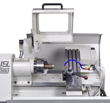

This document details installation of the lathe’s Chuck Guard Kit.
Product Identification: 15L Slant-PRO Lathe Chuck Guard Kit (PN 33323)

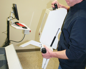

  1. After unpacking the Chuck Guard, hold it with two hands in the locations shown in Figure 1.

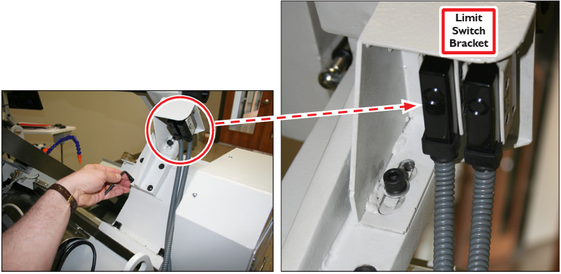

  1. Using a hex wrench, tighten four socket head screws (pre-threaded) into headstock holes (see Figure 3).
  2. Locate and mount the Limit Switch bracket using screws pre-threaded in the main chuck guard bracket (see Figure 3).
NOTE: The Limit Switches and bracket are pre-wired to the lathe.
Figure 3

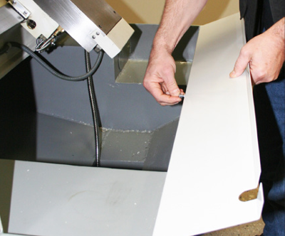

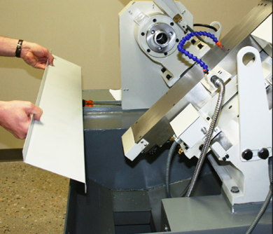

Install Back Splash

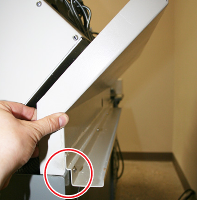

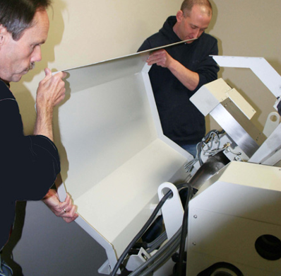

  1. Position Back Splash at the back of lathe, ensuring the slot located at the bottom of Back Splash fits over the back edge of lathe pedestal (see Figure 4 and Figure 5).
Figure 4
Figure 5
  1. Attach the Back Splash to the lathe pedestal with four 5 mm Socket Head Cap Screws (see Figure 6).
Figure 6

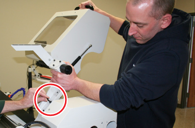

Connect Back Splash
  1. Connect the top of the Back Splash to the Chuck Guard using two 6 mm Socket head cap Screws, lock washers, flat washers and nuts (see Figure 7).
Figure 7

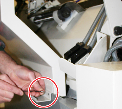

Install Front Splash
  1. Attach the Front Splash guard to lathe’s front pedestal using three 6 mm long Socket Head Cap Screws (see Figure 8 and Figure 9).
Figure 8
Figure 9

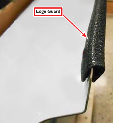

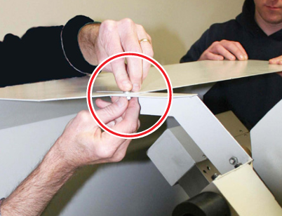

  1. Slip Edge Guard over top edge of Front Splash as shown in Figure 10.
Figure 10

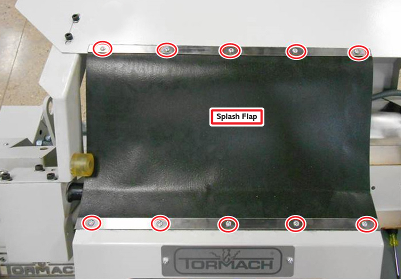

Install Splash Flap
  1. Install the Splash Flap to prevent spray back of coolant above the Chuck Guard with 10 Phillips Head Screws, lock washers, and nuts as shown in Figure 11.
NOTE: Some tweaking of the upper Back Splash bracket may be required to align the Splash Flap holes.
Figure 11

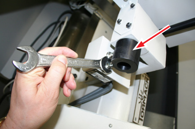

Adjust Chuck Guard
  1. Tighten the two Limit Switch slotted nuts and verify they are secure (see Figure 12).
Figure 12

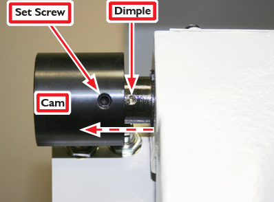

  1. Verify the door cam position by loosening the set screw on the cam with a hex wrench; slide the cam slightly to the left to expose the dimpled pivot shaft (see Figure 13).
  2. With set screw still loose, slide the cam back over the shaft ensuring screw and dimple are aligned. Then, slowly tighten screw until it drops into dimple; tighten firmly. See Figure 13 to review correct positioning when Chuck Guard is closed.
Figure 13
  1. Verify the Limit Switch adjustment by lifting the Chuck Guard. If correctly adjusted, two clicks are heard as the rollers run down the cam. If two clicks are not heard, adjust the switch height accordingly.

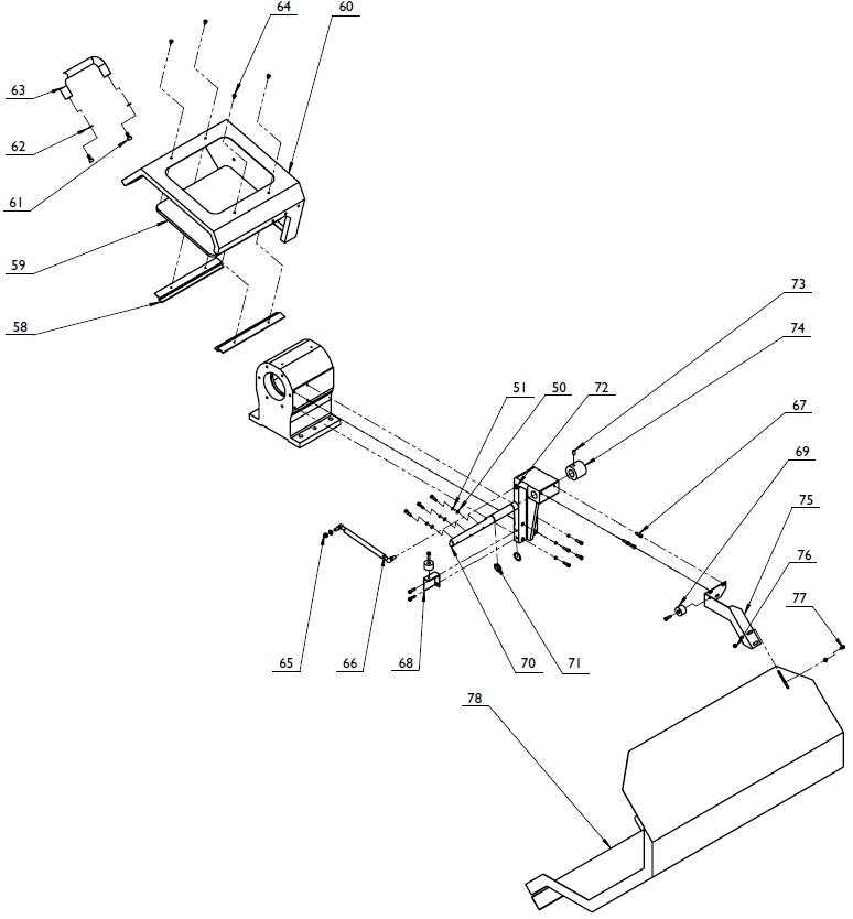

Parts List
ID
PN
50
34298
Washer, Flat M6
51
34299
Washer, Lock M6
58
34306
Window Bracket
59
34307
Window
60
34308
Chuck Guard
61
34309
Screw, M8x16
62
34310
Washer, M8
63
34311
Handle
64
34312
Screw, M5x10
65
34313
Nut, M8
66
34314
Air Spring
67
34315
Screw, M6x20
68
34316
Bracket
69
34317
Bumper
70
34318
Pivot Shaft
71
34319
Retaining Ring
72
34320
Main Guard Mount Arm
73
34321
Set Screw, M8x14
74
34322
Cam, Door Switch
75
34323
Mounting Bracket
76
34324
Nut, M6
77
34325
Screw, M6x12
78
34326
Back Splash Panel
(not shown)
35691
Switch Bracket
To view a PDF version of your manual, go to Tormach document TD10243.
