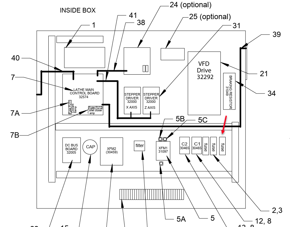

  1. If the monitor and the controller both don't have power:
    1. Verify the secondary 120V is plugged into the back of the machine.
    2. Examine the power cables for damage or exposed wires and replace if needed.
    3. Replace the FU6 fuse.
15L FU6 Location
