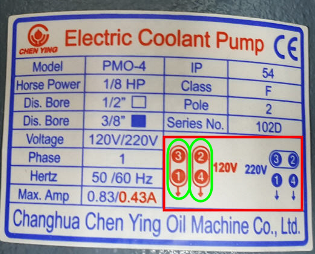

Reseat the coolant pump power cord

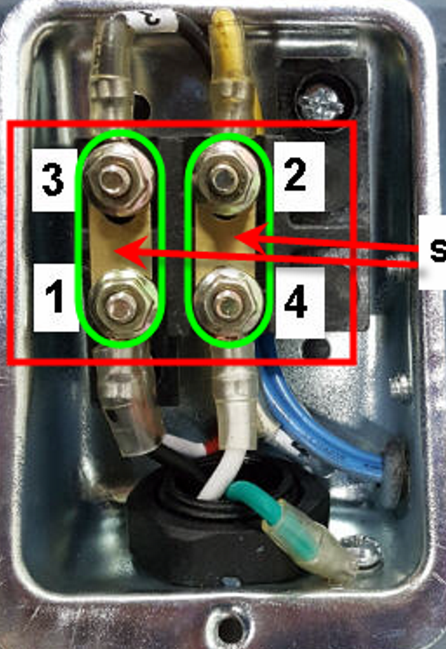

Inspect the coolant pump strapping
  1. Open the box on the side of your pump. Check the strapping compared to the diagram on your pump.

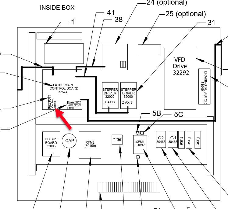

Inspect fuse FU11 on the machine control board
Reason: Fuse F11 on the machine control board is blown.
  1. Power off the machine.
  2. Locate and remove the F11 fuse from the machine control board.
15L FU11 Fuse Location
  1. Measure the resistance across the fuse with digital multimeter set to resistance.
    2. If the fuse measure 0-5 Ω, reinstall it into the machine control board.
If the coolant pump shorts, the 8 A, FU11 flood coolant fuse on the control board blows before the FU1, FU2, or FU6. https://tormach.com/fuse-5x20-glass-8a-217-series-31655.html
