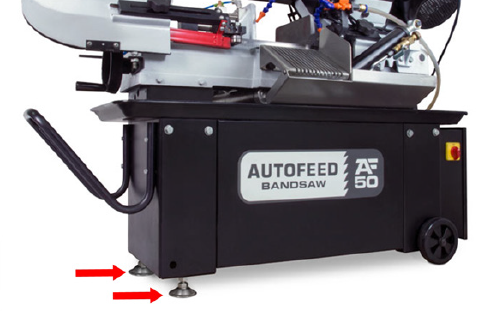

Level the Machine
Before operating the machine, you must verify that it's approximately level. While this helps with things like coolant flow, it doesn't impact machine performance.
To level the machine:
  • Make note of any high or low spots, and, if required, adjust the leveling feet.
Figure 1: Leveling feet on the machine.

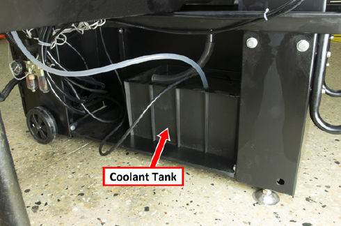

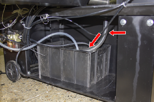

Install the Coolant Tank
  1. Find the coolant tank inside the machine's stand.
Figure 2: Coolant tank inside the machine's stand.

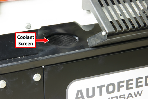

  3. Put the coolant screen on the machine's base below the saw, as shown in the following image.
Figure 3: Coolant screen put on the machine's base.
  1. Connect the coolant tube to the port below the machine's base, and then put it on top of the tray on the coolant tank, as shown in the following image.
Figure 4: Coolant tube connected to the machine's base and the coolant tank.

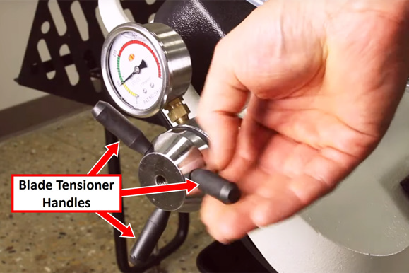

Install the Blade Tensioner Handles
  1. Install and hand-tighten the three blade tensioner handles.
Figure 5: Installing the blade tensioner handles.

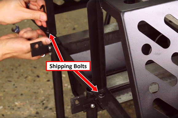

Remove the Shipping Bolts on the Rear Cage
  • The rear cage is secured to the frame for shipment. Remove the two bolts.
Figure 6: Removing the shipping bolts from the rear cage and the frame.

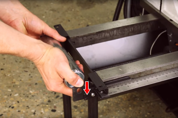

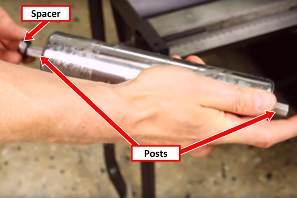

Install the Rear Roller
  1. Install the two spacers on either end of the roller posts.
Figure 7: Installing the spacer on one end of the roller's post.
  1. Put one roller post into the frame, and then squeeze in the spring-loaded post and slide it into the opposite end of the frame.
Figure 8: Squeezing the spring-loaded post.

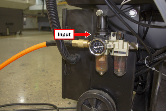

Make Air Connections
  1. Connect the air line from your site to the input port on the FRL Filter-Regulator-Lubricator (on the back of the machine).
Figure 9: Input port on the FRL Filter-Regulator-Lubricator.

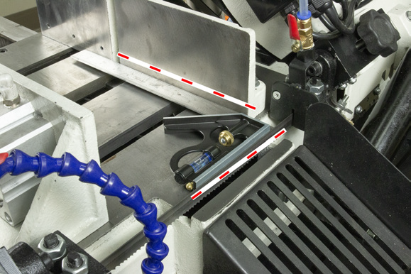

Verify the Alignment of the Fixed Jaw
  1. Open the jaws so that there's enough space to put a square in between them.
  2. Put a square on the base casting between the jaws.
  3. Push the square until it's flush with the side of the blade.
NOTE: The square must be flush with the side of the blade, not the blade's teeth.
  1. Confirm that the bottom of the square is flush with the side of the blade, as shown in the following image. If it's not, go to “Align the Fixed Jaw”.
Figure 10: Fixed jaw aligned with the blade.

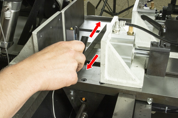

Verify the Alignment of the Infeed Table
  1. Move the infeed table so that it meets the base casting.
  2. Put a square on the base casting as shown in the following image.
Figure 11: Square on the base casting.

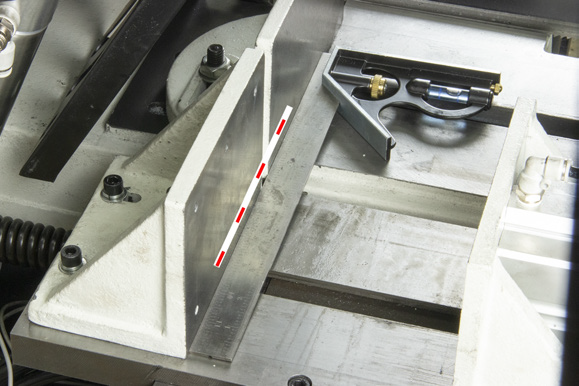

  1. Keeping the square flat on the base casting, move it back over the infeed table. Make note of any height inconsistencies. If there are height inconsistencies, go to “Adjust the Height of the Infeed Table”.
  2. Put a square along the fixed jaws, as shown in the following image. Verify that the square is flush against both jaws. If it's not, go to “Adjust the Fixed Clamp Jaw”.
Figure 12: Square on the fixed jaws.
