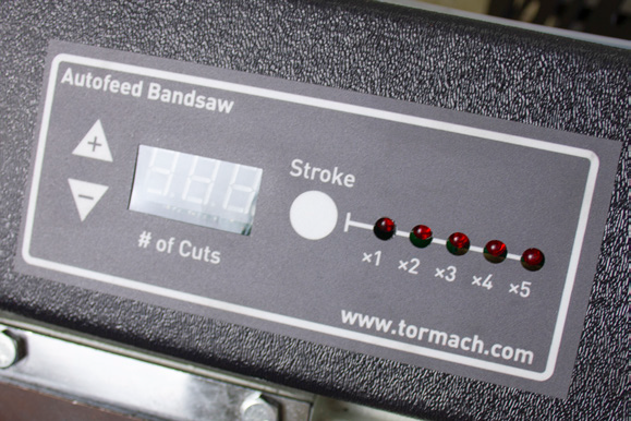

While troubleshooting error codes, examine the Stroke LEDs on the control panel, which correspond to the proximity sensors on the bandsaw. If the LED light is illuminated, the proximity sensor is active.
x1 LED: Infeed (advance) proximity sensor
x2 LED: Outfeed (retract) proximity sensor
x4 LED: Saw down proximity sensor
x5 LED: Saw up proximity sensor
