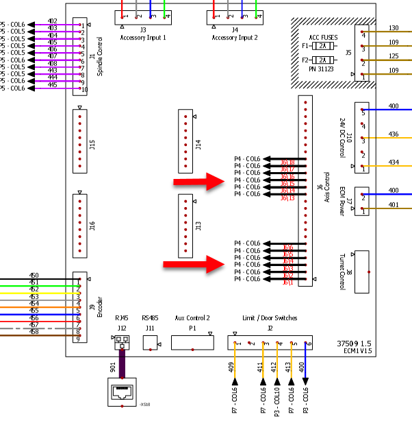

Reseat the connectors on the machine control board and motors
  1. Inspect the stepper driver controller lights.
    1. Some lights are on: One Axis Won't Move (or Only Moves in One Direction), and Other Axes Move - 8L.
    2. All the lights are off: Continue to the next step.
  2. Power off the machine.

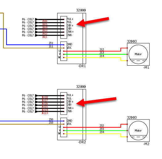

  3. Examine the data cables at the machine control board and the servos/motor removing then re-connecting them to ensure they are seated.
    2. Stepper driver controller: 10 pin IDC (ribbon cable)
8L Stepper Drivers
8L ECM Board

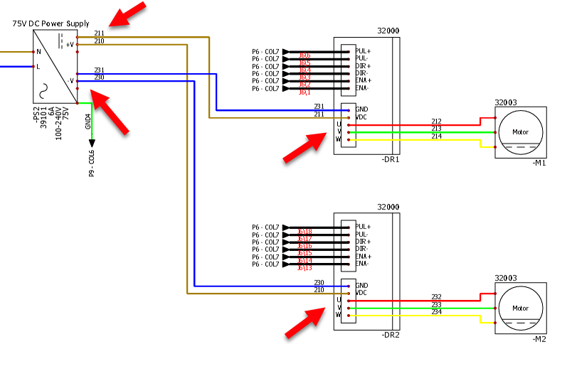

  1. Examine the power cables at the DC Power supply and the servos/motor removing then re-connecting them to ensure they are seated.
    1. DC Power Supply:
      1. 210/211 (X-axis)
      2. 230/231 (Z-axis)
    2. Stepper: Degson style
      1. 210, 211, 212, 213, and 214 (X-axis)
      2. 230, 231, 232, 233, and 234 (Z-axis)
8L Stepper and Motor Power

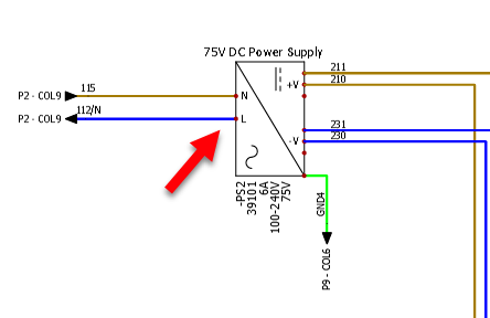

Inspect the DC power supply
Reason: The DC-BUS or DC power supply is malfunctioning.
  1. Inspect the DC power supply for power by determining if the green power light is illuminated.
    1. If it does: The stepper driver controllers will be illuminated.
  2. Ensure the machine is powered on the machine and measure the Vac entering the DC power supply on:
    1. 112/N (N)
    2. 115 (L)
If there is no power to the DC Power Supply, see: Machine Won't Power On - 8L | Reset the CB1 and/or CB2 circuit breaker
8L DC Power Supply Incoming Power

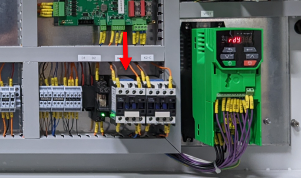

Check the K1 Contactor
Reason: The K1 is defective.
  2. Inspect the K1 center bar.
    1. If the bar is in: The K1 is latched. Using a digital multimeter set to Vac, measure for 120 Vac between:
      1. 114N
      2. 115
    2. If the bar is not in: Continue to the next step.
  1. Press and hold the Reset button on the operator box and observe the K1 bar. Then release the Reset button and observe the K1 bar.
    1. If the bar only stays in when the button is pressed: There is a loose coil wire, short, or the K1 has malfunctioned.
    2. If the bar never comes in: See Machine Won't Power On - 8L
