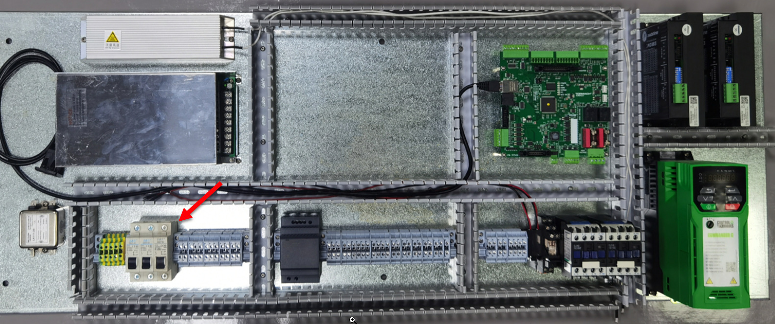

  • If the monitor and the controller both don't have power:
    • Examine the power cables for damage or exposed wires and replace if needed.
    • Reset the CB3 circuit breaker.
CB3 location in 8L electrical cabinet
