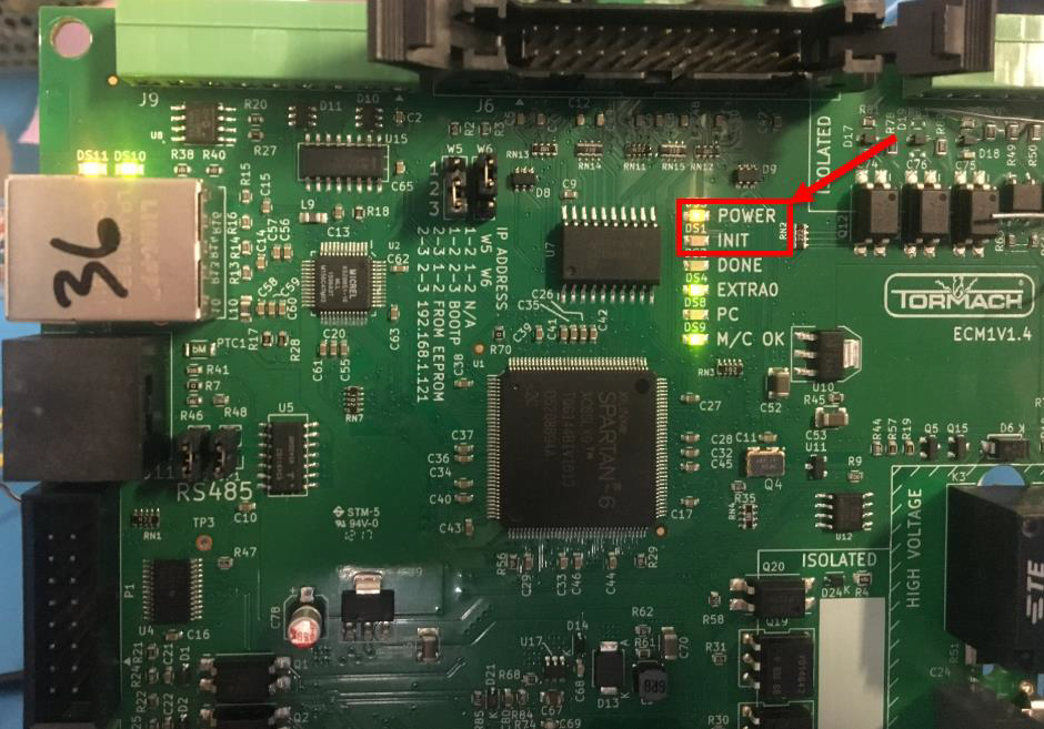

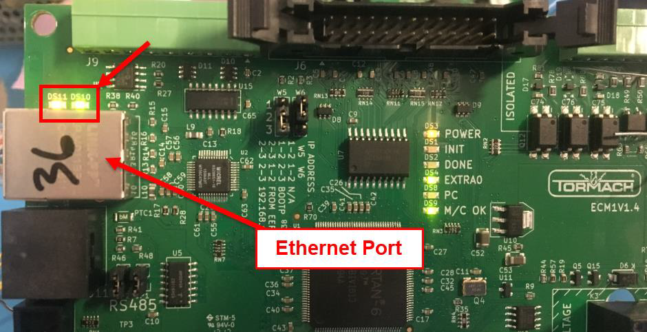

ECM Board
    If it is not lit at power up but lights up later, that means that there was a successful connection to the controller, but it has since disconnected. Go to Step #4.
ECM Board
Orange LED
Green LED
Action
OFF
OFF
Go to Step #4
Blinking
N/A
Go to Step #4
ON
OFF
Go to Step #6
ON
ON
Go to Step #6
ON
Blinking
Go to Step #6
  2. Grab a laptop, another computer, or a router, and try to use a known working ethernet cable to plug your device directly into the Machine Control Board. If the lights don’t turn on at the control board, or the orange light doesn’t stop blinking, then the Machine Control Board needs to be replaced (PN 52931). Otherwise if you are seeing lights you should be able to plug that ethernet cable directly into the PathPilot Controller from the machine control board and get rid of the error, if not continue.

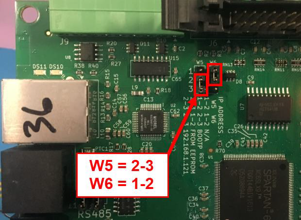

ECM Jumper Location

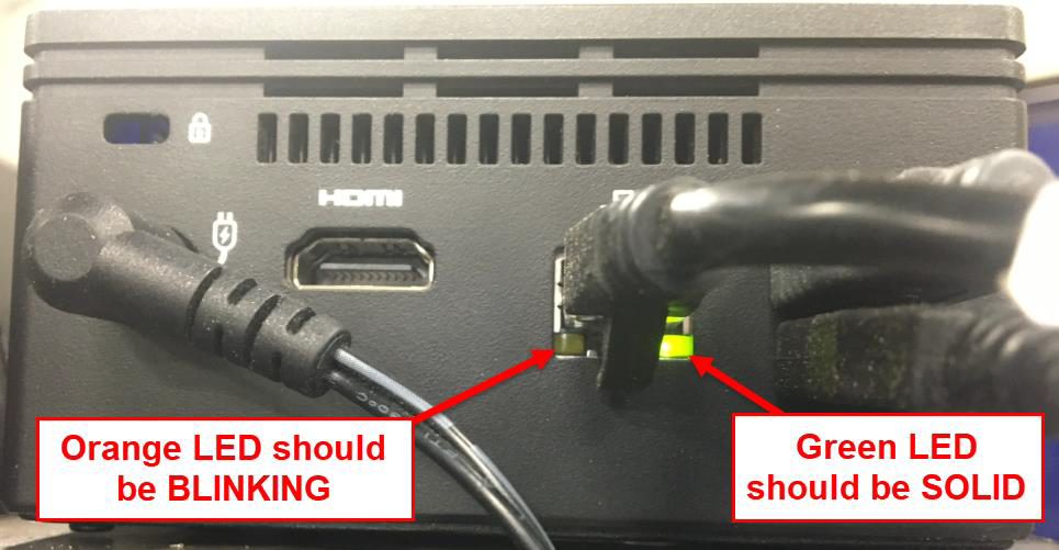

  1. Use a laptop, another computer, or a router to plug a known working cable from your device directly into the PathPilot Controller. If the orange light on the PathPilot Controller ethernet port isn’t blinking after ~15 seconds or no lights at all, then there is a configuration issue with ethernet port on the controller and continue to Step # 8. Otherwise skip to Step # 9.
Back of PathPilot Controller
