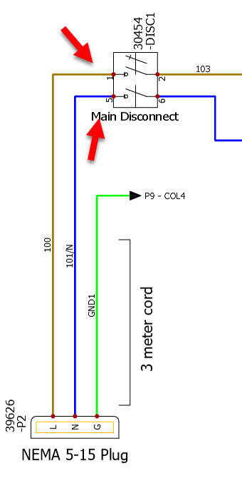

  • The main disconnect switch
  • Digital Multimeter

Inspect the power entering the machine
  2. Measure the indicated wires in the table below.
Machine
Wires
Measure for…
8L
101 and 100/N
115 Vac nominal

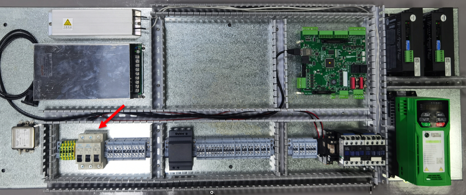

Reset the CB1 and/or CB2 circuit breaker
Reason: The CB1 and/or CB2 circuit breaker tripped.
  1. Measure the wires as indicated in the table below.
  2. If required, power off the machine and reset the tripped breaker.
Machine
Wires (CB1 and CB2)
Measure for…
8L
105 and 100/N
and
107 and 100/N
115 Vac nominal

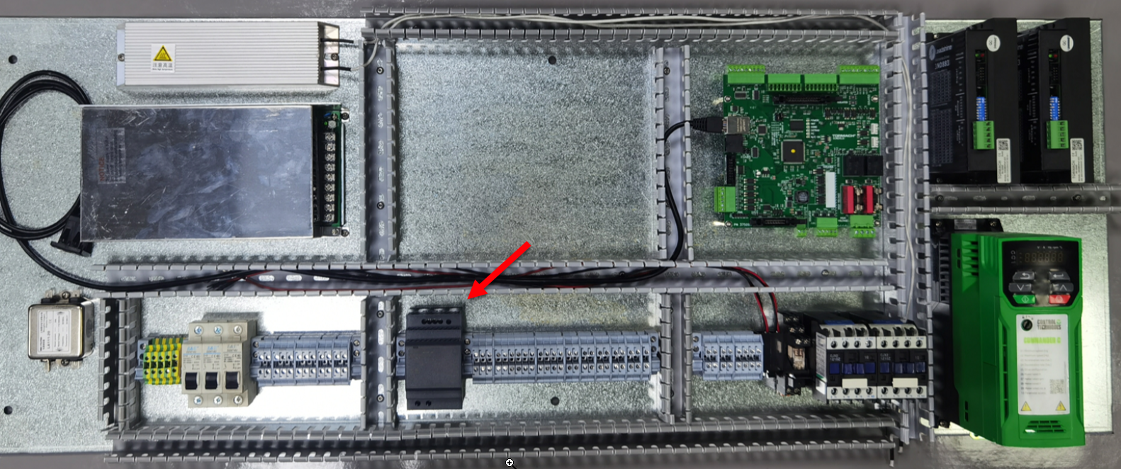

Inspect the DC power supply (PS1)
Reason: The DC power supply PS1 is defective.
  1. With a multimeter measure the Vdc between 400 and 401.
  2. If the digital multimeter reads below 22 Vdc, with a multimeter measure between 112/N and 113 for the input Vac.
    If the input Vac is correct, replace the DC power supply.
Machine
Wires
Measure for…
8L
400 and 401
24 Vdc nominal
Machine
Wires
Measure for…
8L
112/N and 113
115 Vac nominal

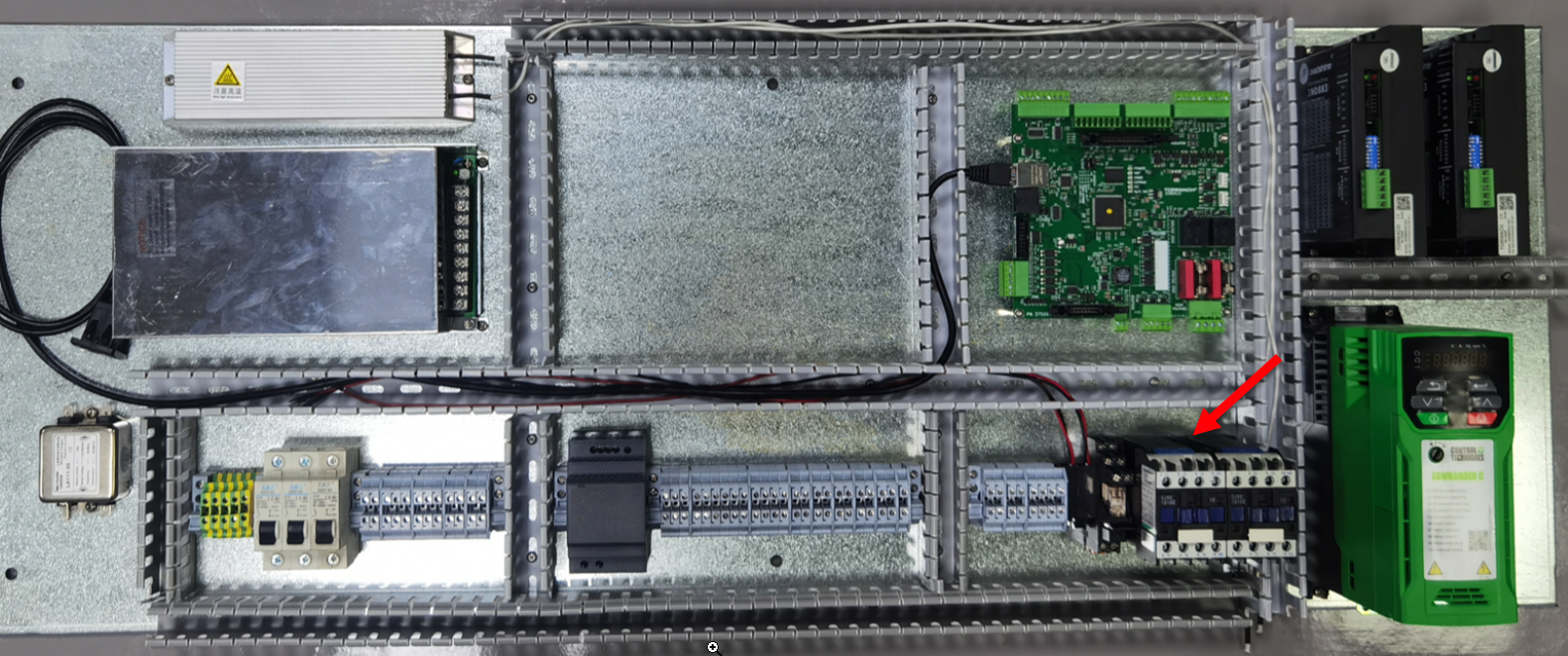

Inspect the K1 contactor
Reason: The contactor K1 is defective.
  1. Press and hold the Reset button on the operator box and observe the K1. Then release the Reset button and observe the K1.
    1. If the bar only stays in when the button is pressed: There is a loose coil wire, short, or the K1 has malfunctioned.
    2. If the bar never gets pulled in: Go back to the previous troubleshooting topics to ensure your machine is receiving power.
