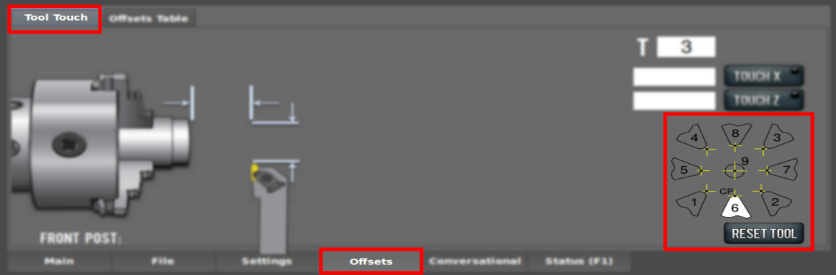

There are nine possible orientations for the cutting point, identified by numbers shown in the following image (with orientation code 3 illustrated).
Figure 1: Cutting point orientation graphic.
  • Tools with orientations 2 and 3 turn to size and face. Their controlled points are the intersection of tangents to the cutting tip radius so the radius has no effect on the diameter or length of the part made.
    If, however, the cut is angled, then the radius means it does not cut the expected part but one a little larger than required.
    To machine a part corresponding to the angled tool path defined in the G-code, it is necessary to use tool-tip radius compensation (i.e., G41 or G42).
  • Tools with orientation 6 turn diameters to size and are often used for making profiles. It is difficult to accurately estimate their controlled point in the Z-direction.
  • Tools with orientations 5 and 7 turn on the face of stock and are unusual. It is difficult to accurately estimate their controlled point in the X-direction without a test cut.
  • Tools with orientation 9 are used when tool-tip compensation is applied in all moves.
Some orientations seem unusual at first glance, like a parting or grooving tool in the front tool post has orientation 1. This is because the program defines the part to the right of the tool. The size of the waste left in the chuck is unimportant.

Dynamic Cutter Compensation (G41.1 and G42.1)
To program dynamic Cutter Compensation to the left of the programmed tool path, program: G41.1 D~ L~
To program dynamic Cutter Compensation to the right of the programmed tool path, program: G42.1 D~ L~
  • D~ is the tip radius multiplied by two
  • L~ is the tool orientation
G41.1 and G42.1 function the same as G41 and G42, with the added scope of being able to ignore the tool table and to program the tool diameter.
It's an error if:
  • Cutter Compensation is commanded to turn on when it is already on
  • The L word isn't in the range from 0 to 9 inclusive
