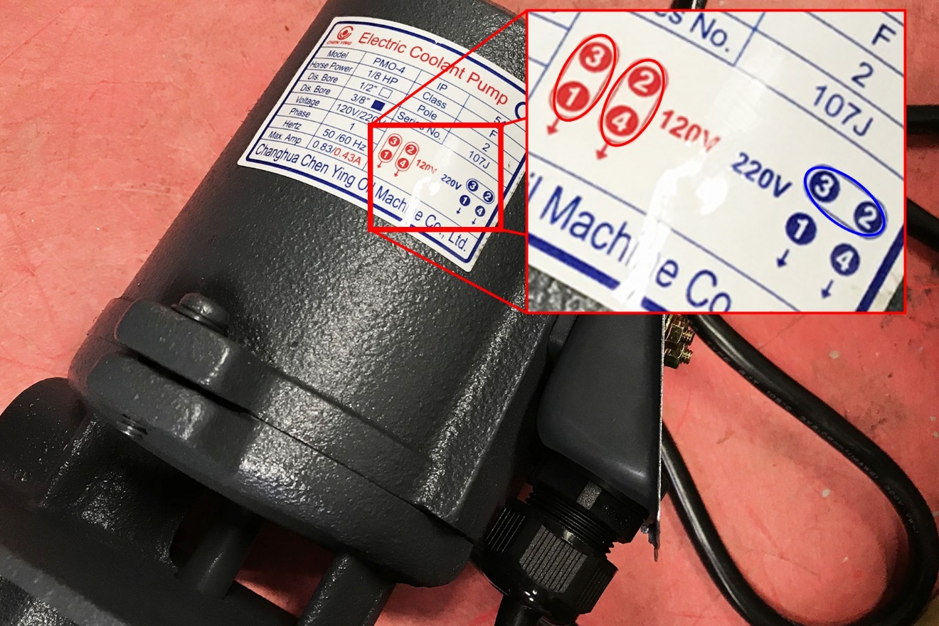

  1. Because the coolant pump is dual voltage, you must verify that the motor strapping is correct before you install it:
    1. Remove the access cover on the coolant pump, and then identify the jumper configuration diagram.
Figure 1: Coolant pump motor jumper configuration diagram.
b. Verify that the jumpers are in the correct configuration (120 Vac or low volt) for your installation. If necessary, adjust the configuration. Go to "Adjust the Coolant Pump Motor Strapping".
Because the coolant pump is dual voltage, you may need to adjust the motor strapping.
  1. Identify the jumper configuration diagram.
Figure 2: Coolant pump motor jumper configuration diagram.
  1. Remove the access cover on the coolant pump.
  2. Reference the configuration diagram and move the jumper to the 120 Vac (low volt) position. Don't change the position of any wires – just the jumper that connects the terminals.
Figure 3: Coolant pump motor strapping adjusted for 120 Vac.
