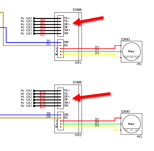

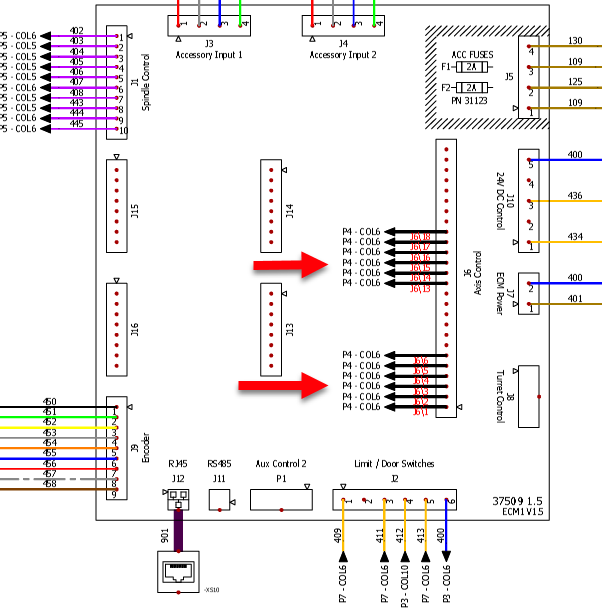

Reseat the connectors on the machine control board and motors
  1. Power off the machine.
8L Stepper Drivers
8L ECM Board

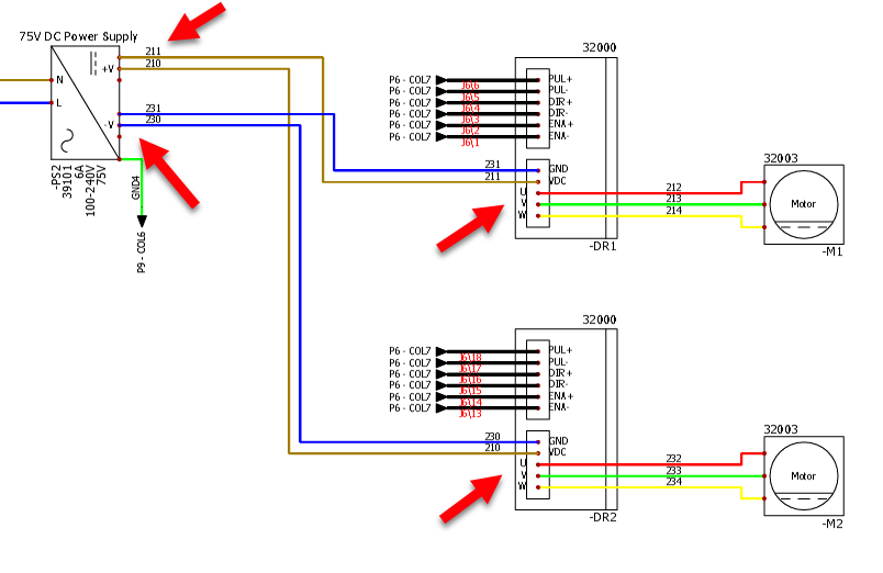

  1. Examine the power cables at the DC Power supply and the servos/motor removing then re-connecting them to ensure they are seated.
    1. DC Power Supply:
      1. 210/211 (X-axis)
      2. 230/231 (Z-axis)
    2. Stepper: Degson style
      1. 210, 211, 212, 213, and 214 (X-axis)
      2. 230, 231, 232, 233, and 234 (Z-axis)

Inspect the motor’s drivers
Assess the state of the motor or stepper driver controller
Reason: There's a defective or malfunctioning axis driver/cable.
Full stepper driver controller swap (full driver swap)
    Note: There will be no change to how to jog the swapped axis.
  4. Power on the machine.
Half stepper driver controller swap (half driver swap)
    Warning! The axis jog control swaps, with the half swap. A X axis command will move the ZZ and vice versa.
Inspect the DC power supply
Reason: There's no voltage coming from the DC power supply.
  1. Inspect the DC power supply for power by examining if the green power light is illuminated.
    1. If it does: The stepper driver controllers or motors will be illuminated.
    2. If it doesn’t: Go to All Axes Won't Move When Commanded - 8L.

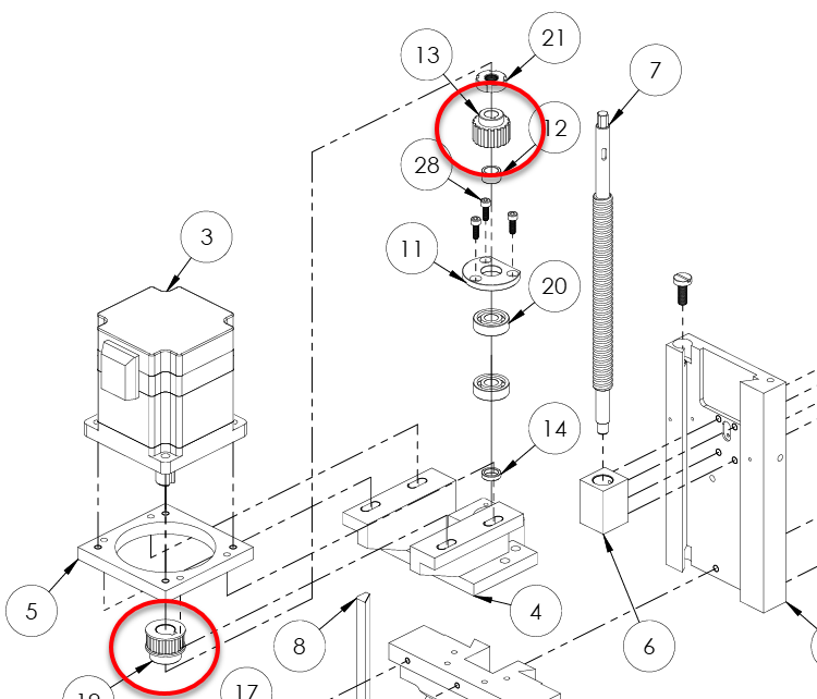

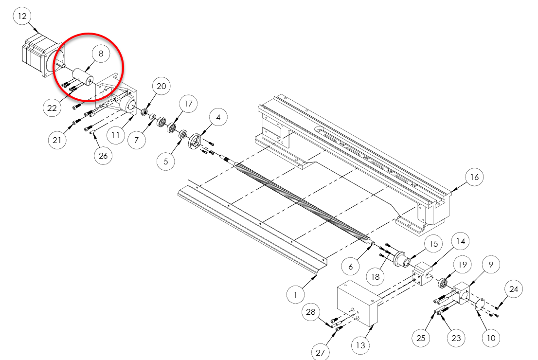

Inspect the motor coupling
Note: the X axis on the 8L is belt driven.
8L Z Axis Coupler
8L X Axis Pulleys
