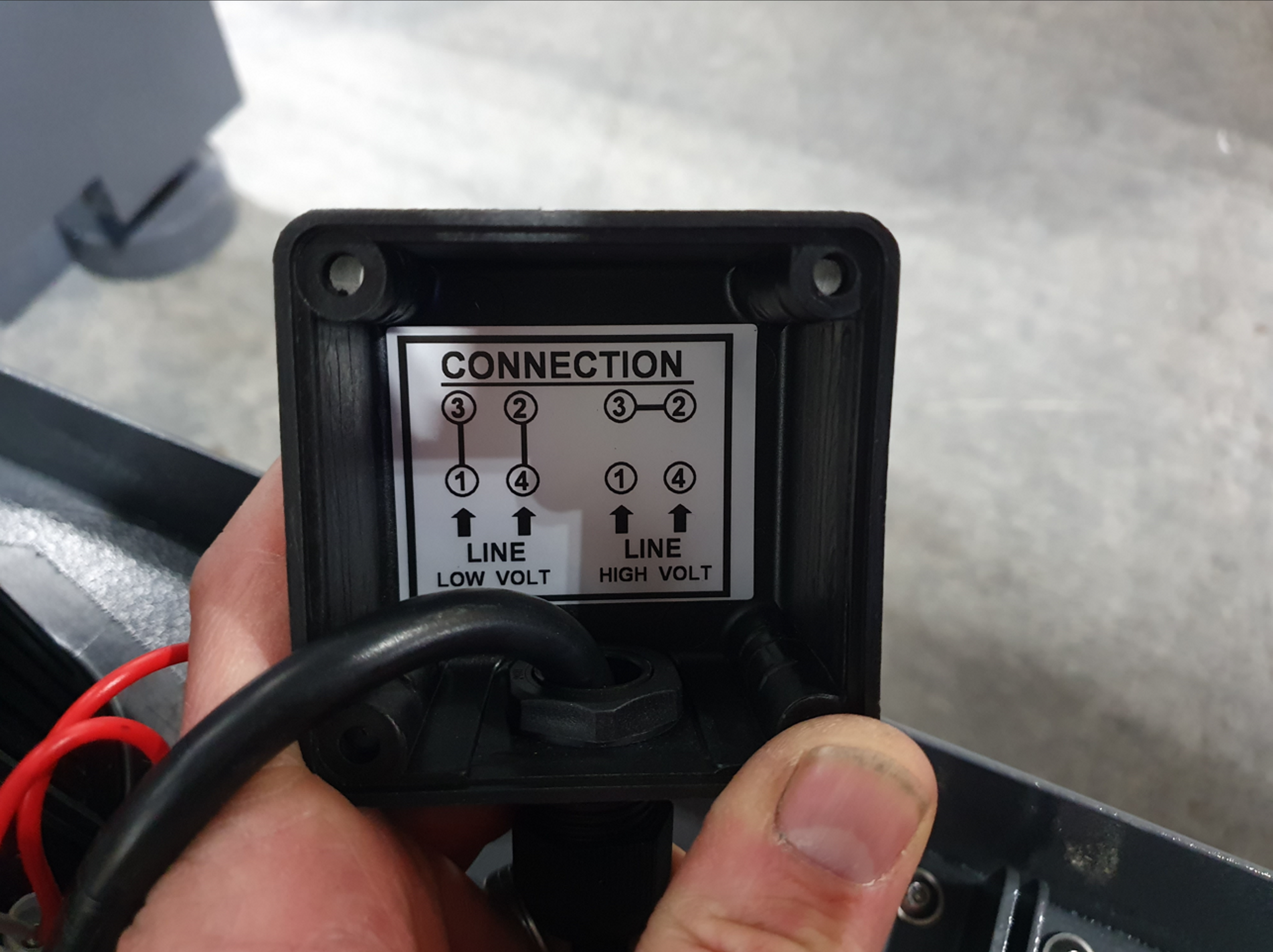

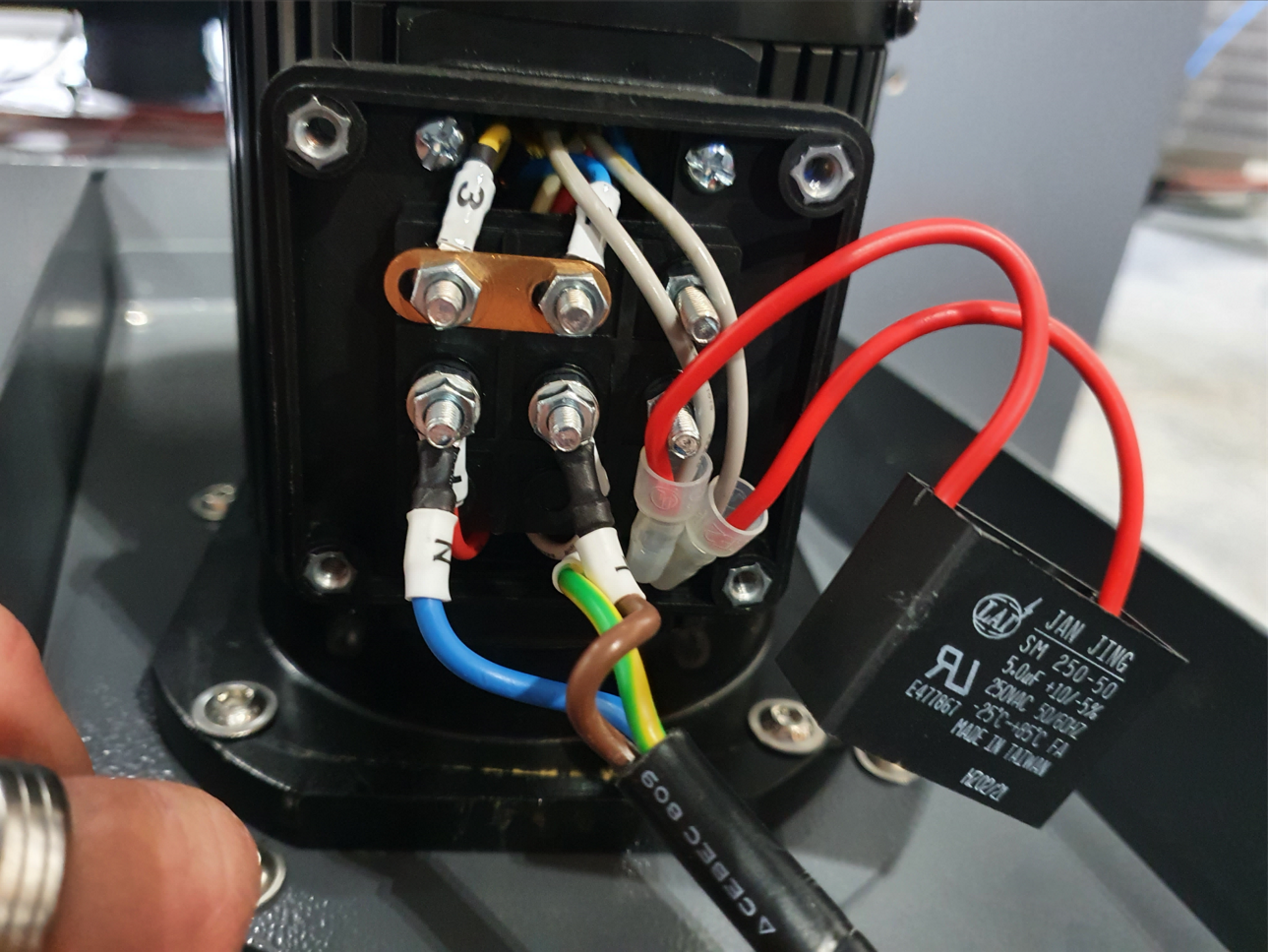

Reseat the Coolant Pump Power Cord
Inspect the Coolant Pump Strapping

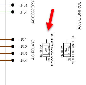

Inspect Fuse F1 on the ECM Board
Reason: Fuse F1 on the machine control board is blown.
  1. Power off the machine.
  2. Locate and remove the F1 fuse from the machine control board.
    2. If the fuse measure 0-5 Ω, reinstall it into the machine control board.
8L ECM Board
