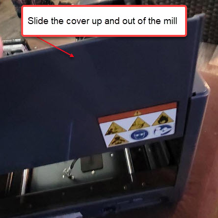

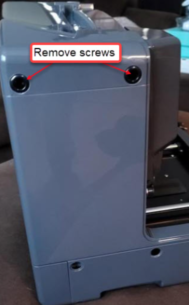

Step 1: Remove the top cover
Remove the 2 Phillips Screws and 2 black screw inserts on both the top left and top right of the mill cover and pull the cover off.

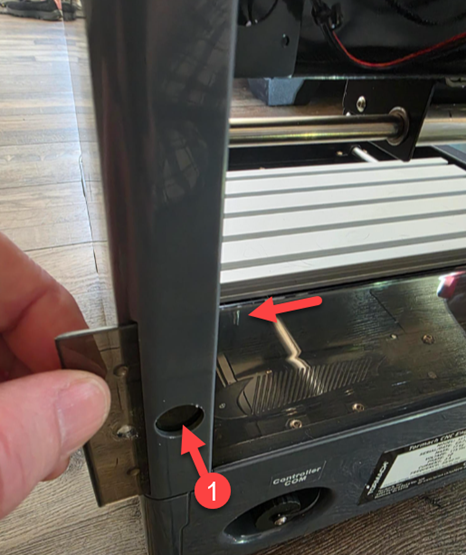

Step 3: Remove the lower plastic shield retainer screw and slide out the lower panel

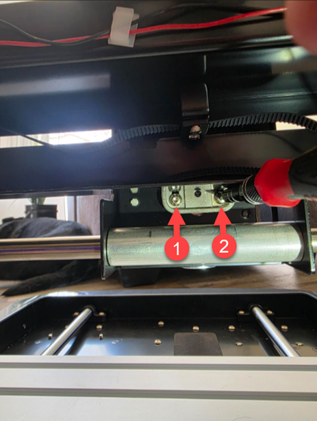

Step 4: Loosen the belt tension bracket (two screws) using a 2.5 mm Allen wrench

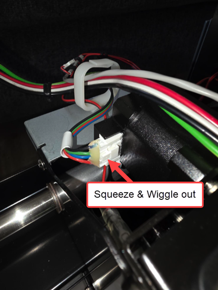

Step 5: Gently squeeze the plug clip and unplug the motor

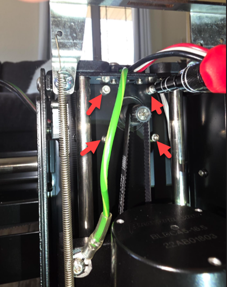

Step 6: Remove the (4) screw securing the motor and slide the motor out
Step 7: Re-assemble in reverse and be sure to slide the belt onto the pulley before securing the motor screws.
