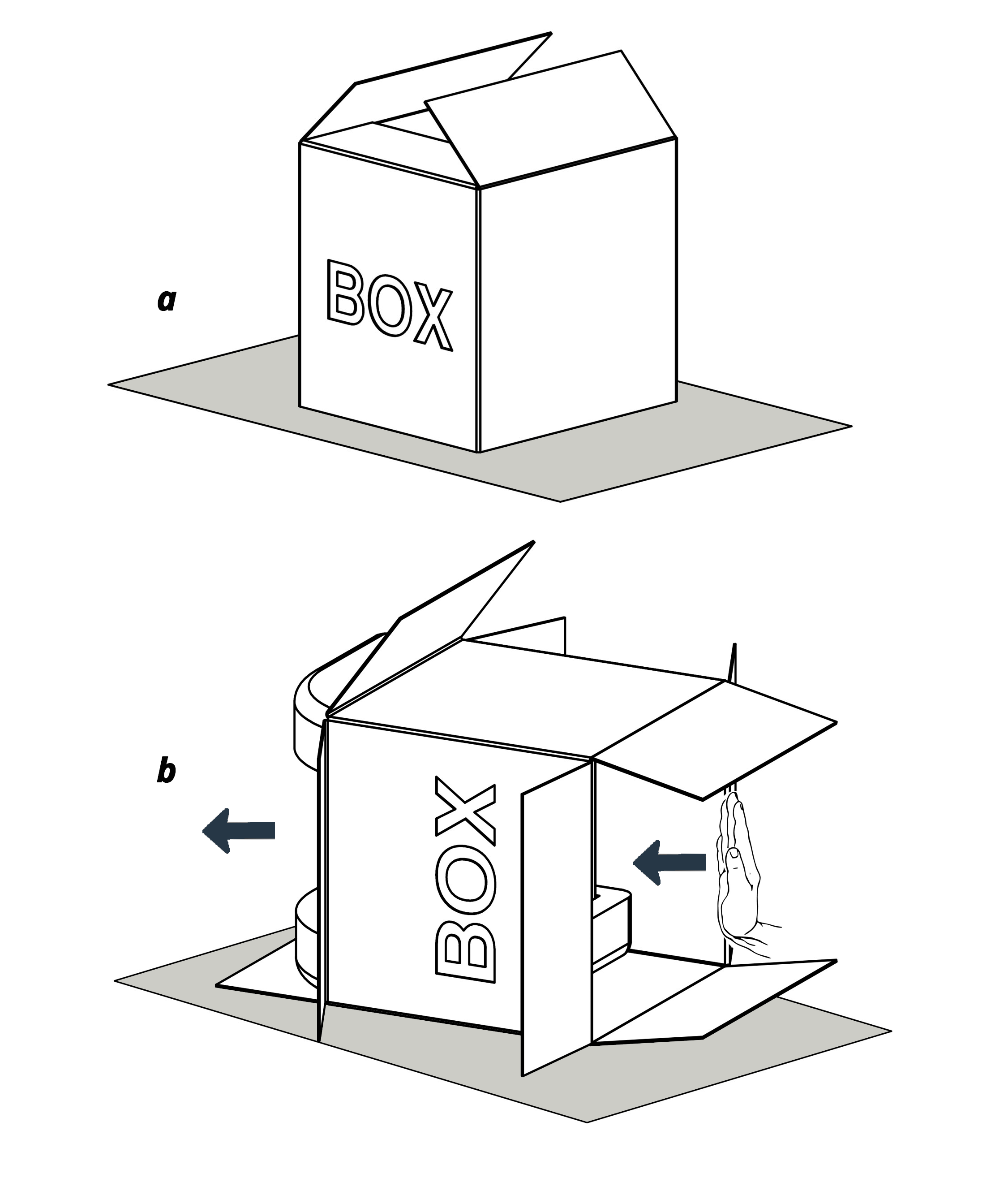

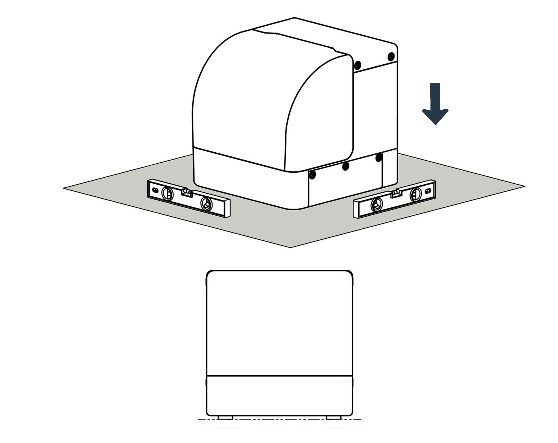

  1. The xsTECH is packed tightly inside the box. You may find it easier to push the unit out from the bottom of the box, as shown below.
  1. Place your xsTECH on a sturdy work surface. You can make minor adjustments by threading the feet in or out if required.

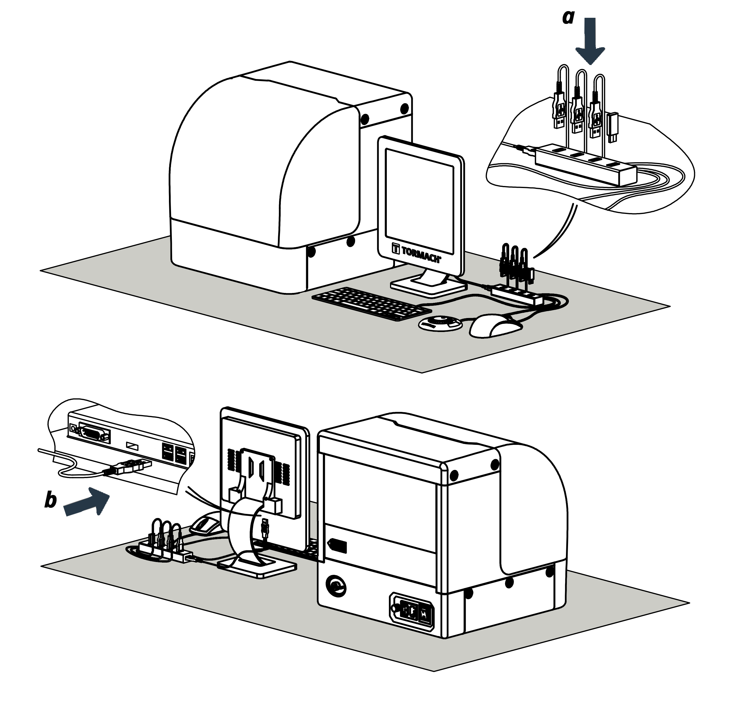

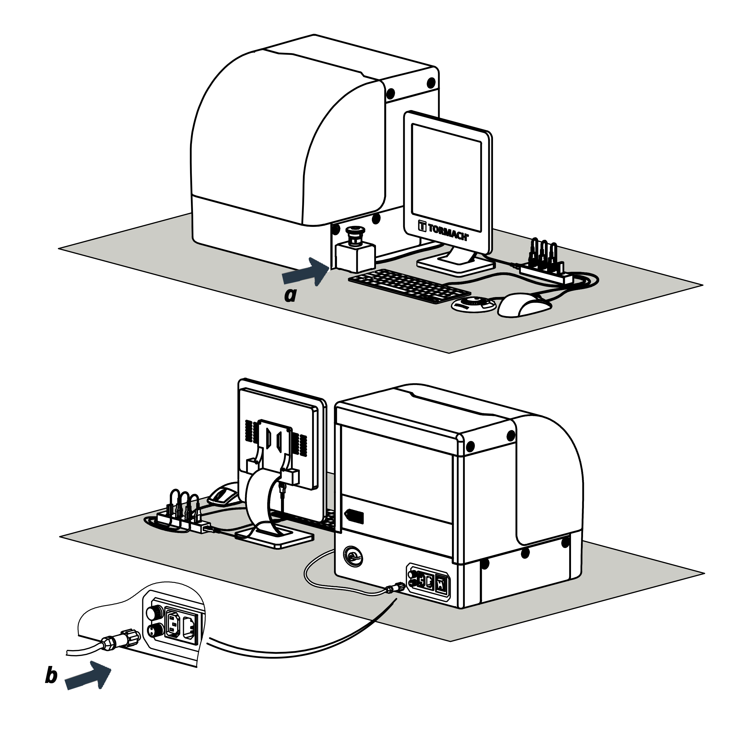

  1. Plug the keyboard, mouse, jog shuttle, and WiFi adapter in the USB hub. Then, plug the USB hub into one of the USB connections on the underside of the controller.

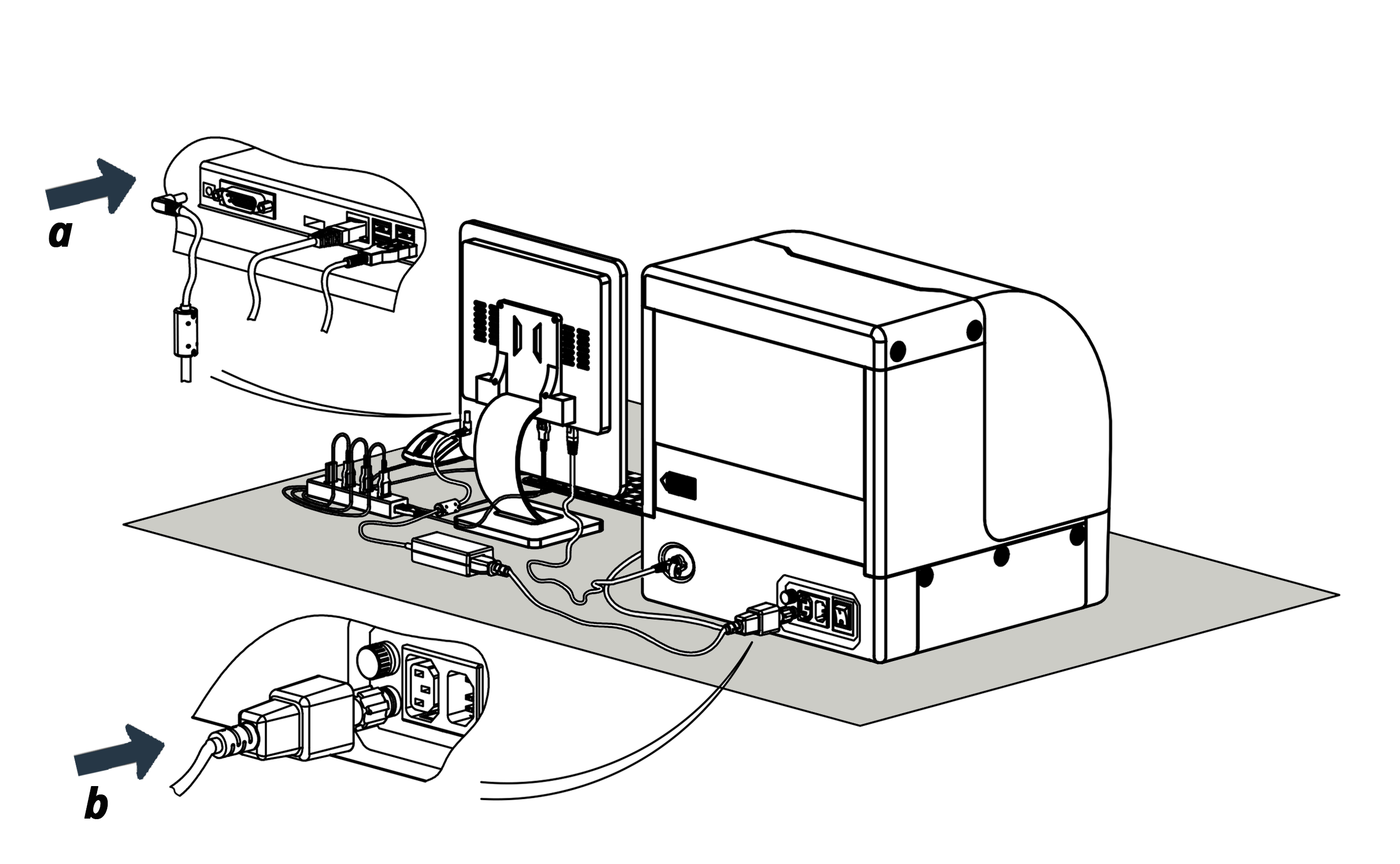

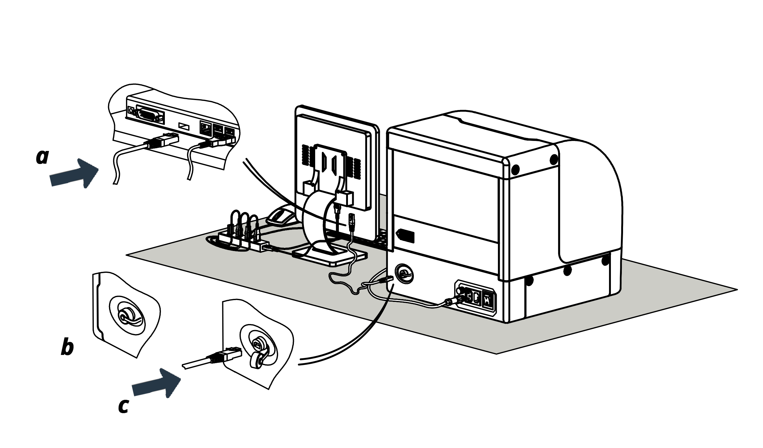

  1. The E-stop connects to the rear of the xsTECH. Align the connector and screw into place to secure.
  1. Connect the RJ-45 communication cable (also known as an ethernet cable) between the controller and the xsTECH as shown below.

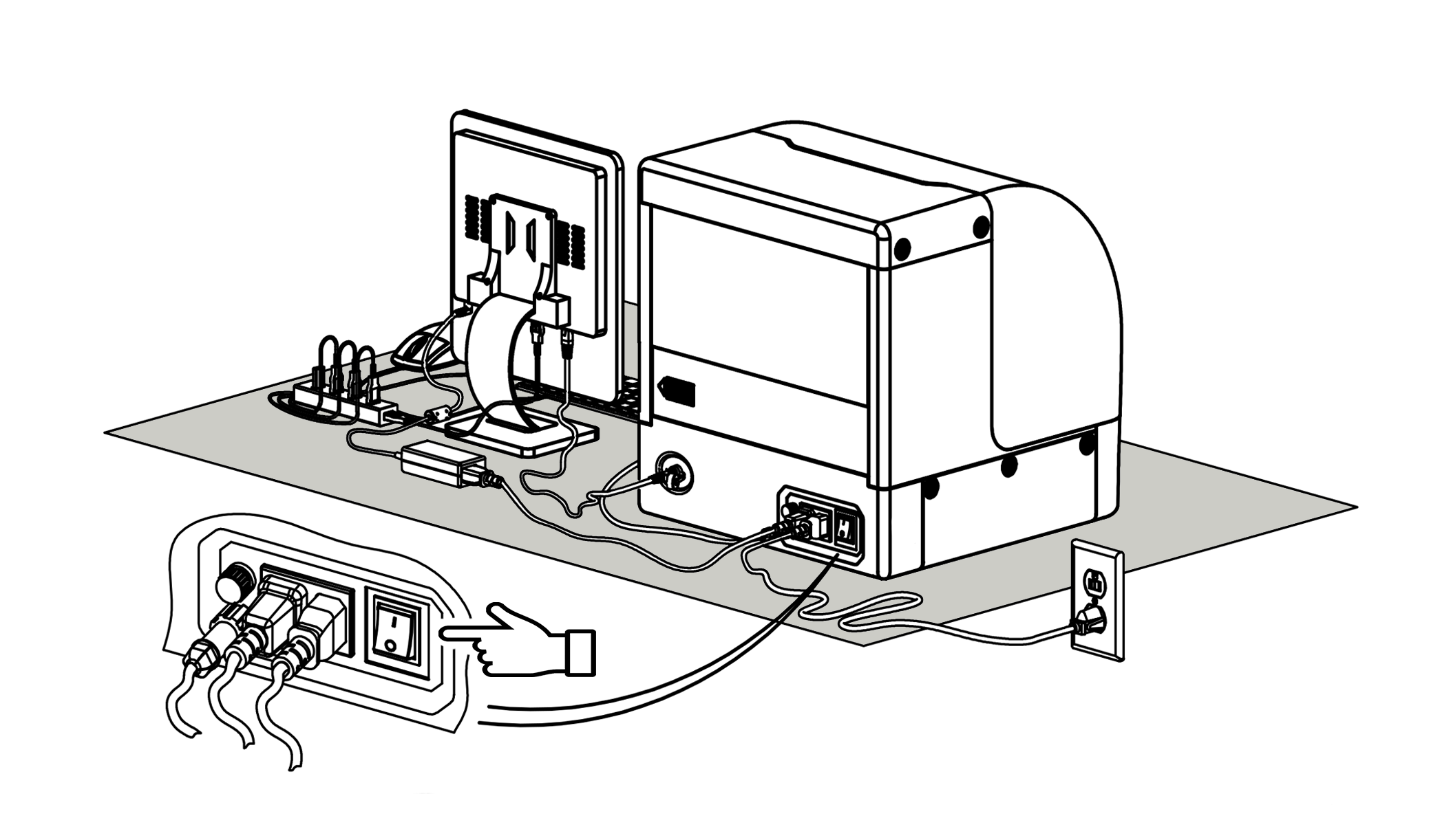

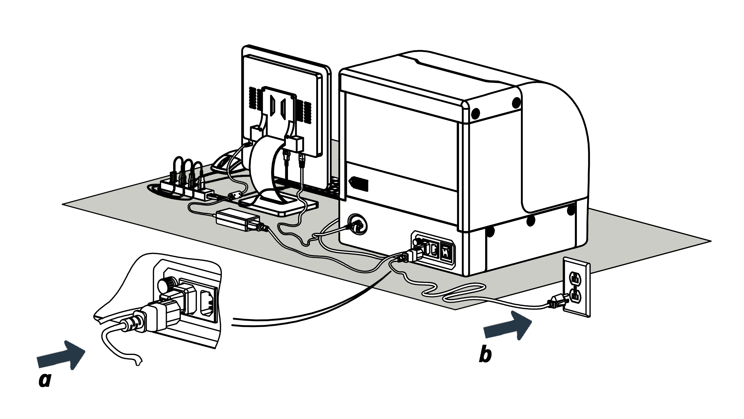

  1. Connect the power cable for the controller to the xsTECH.
  1. Connect the xsTECH to wall power.

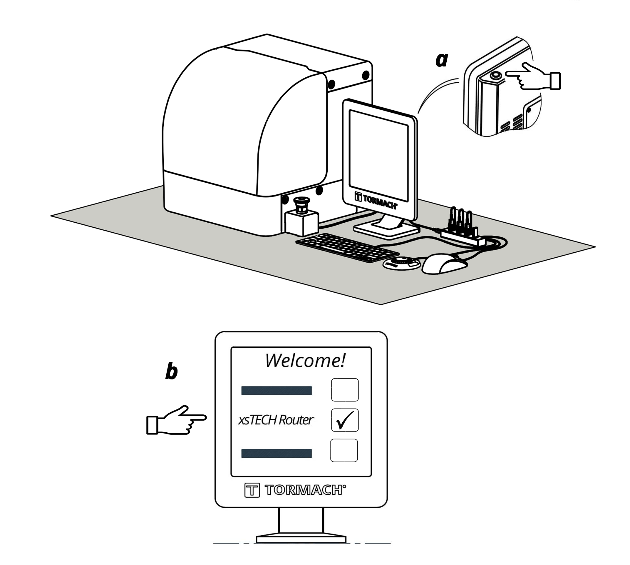

  1. Turn on the main unit with the switch in the back.
  1. Press the button on the top of the controller. After the initial boot-up, choose “xsTECH Router” to configure the controller and follow the instructions on the screen.
