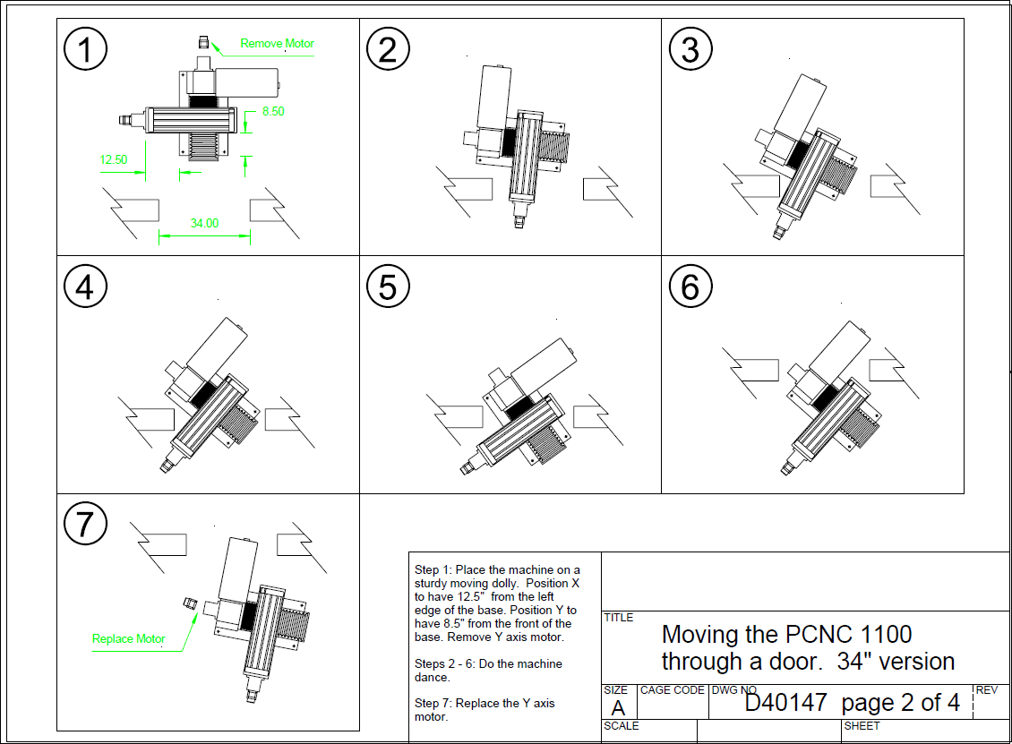

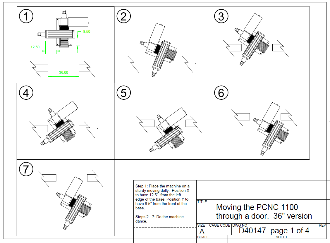

The following illustrations demonstrate how to move a PCNC 1100 (or M/MX) through different doorway widths.
  • High-capacity furniture dollies
36 in. Doorway
34 in. Doorway

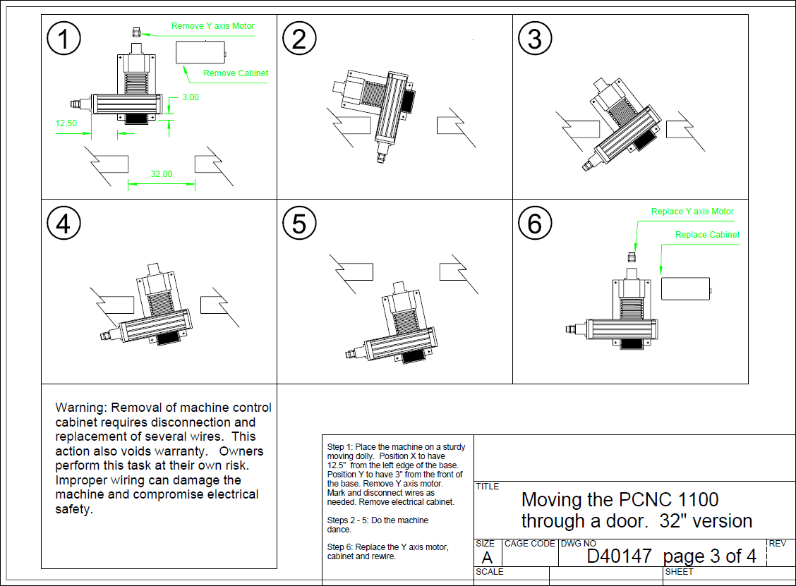

32 in. Doorway
https://tormach.atlassian.net/wiki/s/-813001308/6452/17b5d0ae2ede2362fa8d1e732dc89744e3e532f6/_/images/icons/emoticons/warning.png REMOVING CONTROL CABINET VOIDS WARRANTY! https://tormach.atlassian.net/wiki/s/-813001308/6452/17b5d0ae2ede2362fa8d1e732dc89744e3e532f6/_/images/icons/emoticons/warning.png

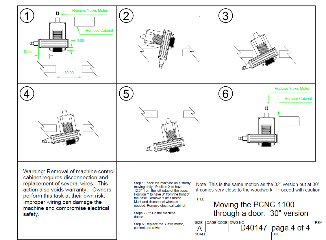

30 in. Doorway
