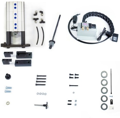

Purpose:
This document details the installation and use of the power drawbar on a PCNC 770® mill.
Qty.
PCNC 770 Power Drawbar
PN
1/4 inch Plastic Tube: 112 mm
31457
105A Wire Label
Air Fitting: Elbow
35924
Air Fitting: T-connector
35923
Control Assembly
Cylinder Assembly
Drawbar
31911
Drawbar Flange
31912
Eccentric Pivot Mount
32095
Hex Bolts
32455
Jam Nuts
32341
Latch Plate Adjustment Set Screw
32342
Latch Plates
32271
Left Sub Plate
31983
M8 Lock Washer
32339
M12 Flat Washer
32473
M12 Lock Washer
31379
M16 Flat Washer
31445
Mount Screws
31895
Mounting Screw
32338
Pendant
31471
Plastic Mount Tab
31460
Quick Release Pin
32353
Right Sub Plate
31984
Screw
32340
Sheet Metal Screw
31718
Spring Washer
31319
Thread Seal Tape
Wire Tie
31719
Required Tools

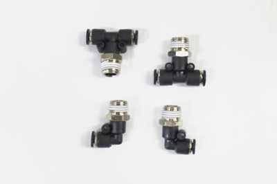

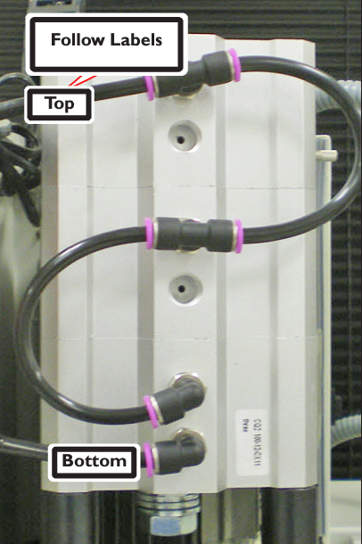

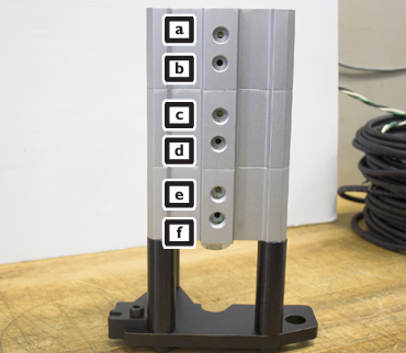

  1. Identify four air fittings included with this kit (see Figure 1).
Figure 1
  1. Using thread seal tape (included with this kit), completely wrap the threads of the four air fittings.
  2. Put the power drawbar cylinder on a flat surface as shown in Figure 2.
  3. Install air fittings in the power drawbar cylinder in the order specified, from top to bottom (see Figure 2 and Figure 3):
    1. T-connector
    2. Empty
    3. T-connector
    4. Empty
    5. Elbow connector
    6. Elbow connector
Figure 2
When complete, make sure your power drawbar cylinder matches Figure 3.
Figure 3

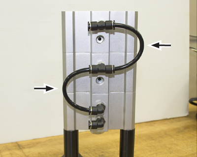

  1. Identify two 112 mm 1/4 inch Plastic Tubes included with this kit.
  2. While facing the power drawbar cylinder, put one plastic tube between the left sides of both T-connector air fittings as shown in Figure 3.
  3. Put the remaining plastic tube between the right sides of the T-connector air fitting and the elbow connector air fitting in as shown in Figure 3.

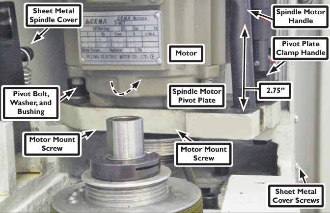

NOTE: The following steps may be more easily accomplished by first removing the sheet metal spindle cover. The spindle cover is attached to the spindle head by five screws. If you remove the spindle cover, you must make sure that the lubrication manifold, lubrication lines, and spindle power cable are not damaged in the process.
  1. Remove the Pivot Plate Clamp Handle (see Figure 5) and discard.
  2. Remove the wire connection cover on the spindle motor.
  3. Make note of the position of the wires, and then disconnect the motor and remove the Pivot Bolt (see Figure 5); discard.
NOTE: Keep the Pivot Washer and the Pivot Bushing (see Figure 5).
  1. Remove the Motor and the Spindle Motor Pivot Plate assembly (see Figure 5).

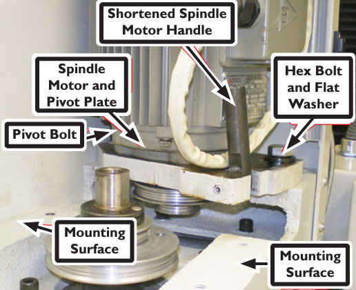

  2. Using a hack saw or cut-off saw, shorten the Spindle Motor Handle to 2.75 inches (see Figure 5).
  3. Remove the four Motor Mount Screws (see Figure 5); set aside.
  4. Rotate the Motor 90˚ counterclockwise (relative to the Spindle Motor Pivot Plate) and reinstall the four Motor Mount Screws set aside earlier (see Figure 5).
  5. Reinstall the Motor and the Spindle Motor Pivot Plate assembly using the following components:
    1. Use one Hex Bolt to replace the discarded Pivot Bolt; reinstall the Pivot Bushing and Pivot Washer (see Figure 5).
    2. Use one Hex Bolt and one Flat Washer in place of the Pivot Plate Clamp Handle (see Figure 5).
    3. Re-wire the Motor using the original wire positions you made note of earlier in this section.
Figure 5

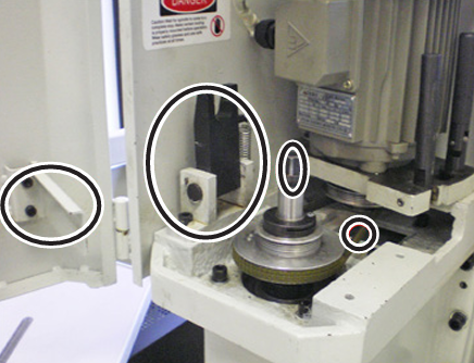

  1. Make sure the Mounting Surfaces are free of burs and debris (see Figure 6). If necessary, clean the surfaces.
Figure 6

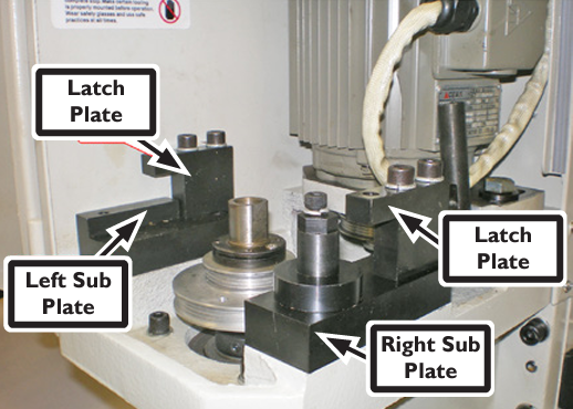

  1. Using four Mount Screws, mount the Left Sub Plate and the Right Sub Plate) as shown in Figure 7.
  2. Using four Mount Screws and four Lock Washers, mount two Latch Plates as shown in Figure 7.
Figure 7

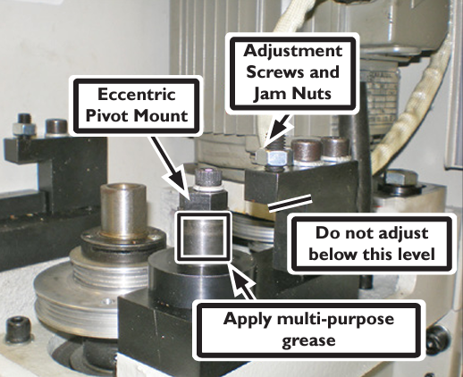

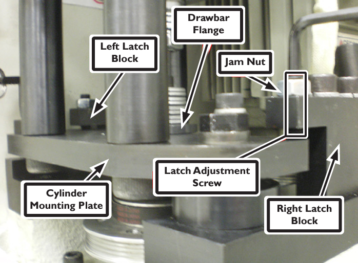

  1. Mount two Latch Plate Adjustment Set Screws and two Jam Nuts into the Latch Plates.
  2. Screw the Latch Plate Adjustment Set Screws into the Latch Plate tab so that the flat tips are flush with the underside of the Latch Plate tab.
  3. Mount the Eccentric Pivot Mount with one Screw and Lock Washer. Put a dab of multi-purpose grease in the location indicated in Figure 8.
NOTE: Do not fully tighten the Eccentric Pivot Mount; it will be loosened later in this section.
Figure 8

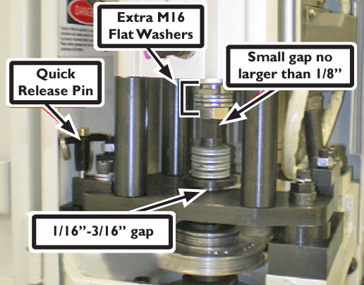

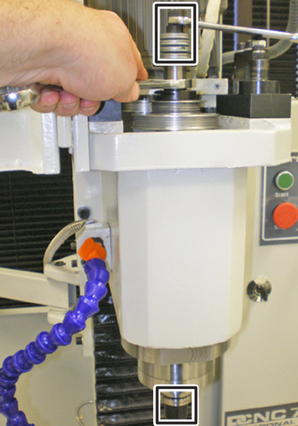

  1. Put a dab of multi-purpose grease on the Spring Washers.
  2. Install the Power Drawbar with Spring Washers and the Drawbar Flange into the Tormach Tooling System (TTS)® collet.
  3. Install an empty TTS tool holder in the collet and hand-tighten the drawbar.
  4. Using a 13/16” wrench and a drawbar wrench, tighten the Power Drawbar approximately two full turns past hand-tightened (see Figure 9).
This is the starting pre-load.
IMPORTANT! After the initial installation, you must complete a final pre-load adjustment. Failure to do so could result in tool pull-out.
Figure 9

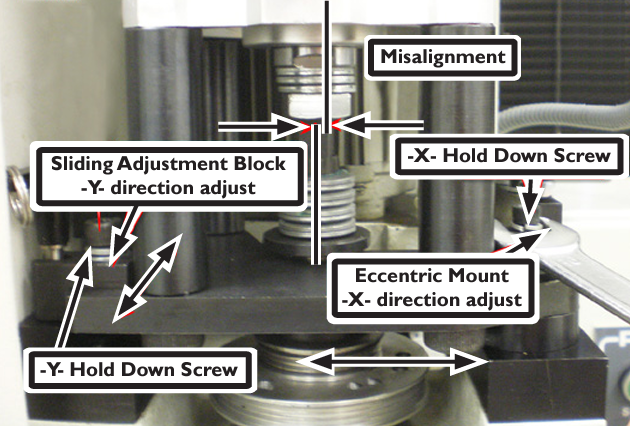

  1. Mount the Cylinder Assembly over the Eccentric Pivot Mount and swing it into position. Use the Quick-release Pin to secure assembly. Note the 1/16 inch to 3/16 inch gap between the cylinder mounting plate and the Drawbar Flange as shown in Figure 10.
NOTE: Gap variations are a result of the mill’s acceptable manufacturing tolerances. The gap between the cylindrical rod hex bolt and the top of the drawbar should be no larger than 1/8 inch when the cylinder is in the fully retracted position. To make sure the gap is less than 1/8 inch (see Figure 10), extra M16 Flat Washers (included) can be added to the hex bolt if needed.
Figure 10
  1. To prevent premature wear on the cylinder and maximize the holding capability of the system, you must align the cylinder concentrically with the drawbar. This is a two step process. Before starting, make sure that the screws indicated in Figure 11 are sung, but not tight.
    1. Adjust the position in the -X- direction by using the back end of a drawbar wrench (or adjustable wrench) and turning the Eccentric Pivot Mount. There should be enough throw to visually align the cylinder and the drawbar. Tighten the -X- Hold Down Screw (see Figure 11).
    2. Adjust the position in the -Y- direction by pivoting the Cylinder Assembly and allowing it to slide under the adjustment block. After the cylinder is visually aligned with the drawbar, tighten the -Y- Hold Down Screw (see Figure 11).
Figure 11

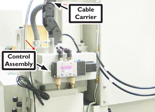

Control Assembly
Figure 12

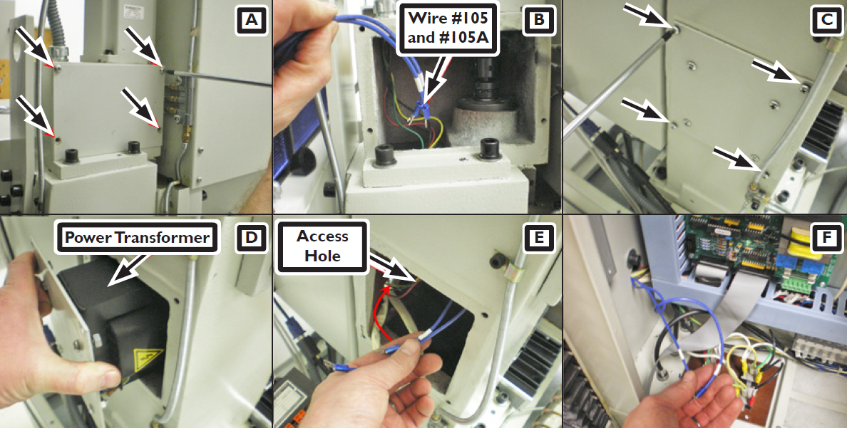

NOTE: It may be it easier to perform the following steps with the mill moved away from walls and other obstructions.
  1. Remove four screws securing the Z-axis motor coupling cover plate (see Figure 12A); set aside.
  2. Locate the blue interlock wires (wire #105 and #105A) on the Power Drawbar control box assembly and route them down the mill column casting (see Figure 12B).
NOTE: The following steps may also require removing the backsplash, if installed, in order to facilitate electrical access.
  1. Remove the four screws securing the cover plate on the back of the mill column (see Figure 12C) and the Power Transformer (see Figure 12D).
IMPORTANT! Do not rest the weight of the Power Transformer on its wires.
  1. Locate the blue interlock wires and continue to route them into the Access Hole connecting the inside of the column with the electrical cabinet (see Figure 12E); pull them through into the electrical cabinet (see Figure 12F).
  2. Remount the Power Transformer, cover plate, and, if necessary, backsplash.

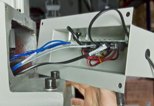

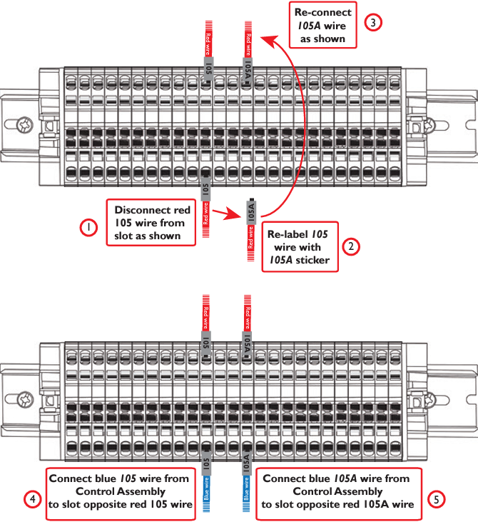

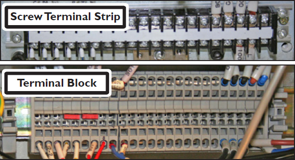

Electrical Connections
  1. Older machines are equipped with a Screw Terminal Strip, while newer machines have a Terminal Block. Identify the connection type in electrical cabinet specific to your machine as shown in Figure 13.
Figure 13
NOTE: For both the terminal block and strip, the wiring numbers and layout shown in Figure 14 are the same.
  1. Follow the step-by-step instructions in Figure 14 to put the new spindle door wires in series with the spindle door switch circuit. Some wiring configurations may appear different than shown, but wire numbers and layout are all the same.
NOTE: It may be useful to make a note of the wiring changes in the operator manual.
Figure 14

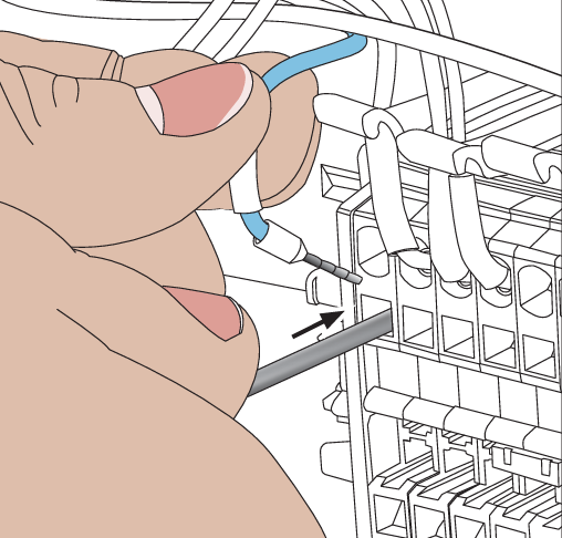

  1. If your machine has a terminal block, connect the wires as follows:
    1. Slowly insert the end of a small, flat-head screwdriver into the slot above or below the selected wire connection site (see Figure 15).
Figure 15
b. Pry the terminal clip open carefully. Then, insert the wire into the terminal block.
c. Slowly remove the screwdriver.

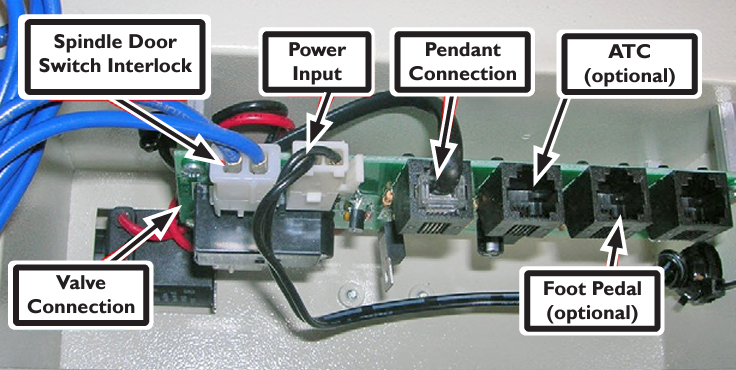

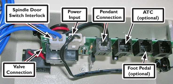

  1. Connect the blue wires to the inside of the Power Drawbar control box (see Figure 16). This photo is for reference only; units are pre-wired.
NOTE: If installing an Automatic Tool Changer (ATC), the power input cord may be removed at this time.
Figure 16
  1. Using the screws removed earlier in this section, mount the Control Assembly as shown in Figure 17.
Figure 17

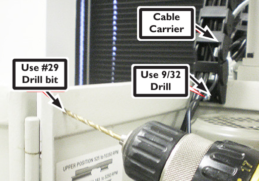

  1. Position the Cable Carrier as shown in Figure 18 and mark the location of one of the mounting holes. Using a 9/32 drill bit, make a hole through the two sheet metal layers of the spindle cover. Using the 1/4 inch screw, nut, and washer, mount the Cable Carrier to the spindle cover.
  2. Using a #29 drill bit, make a hole though just one layer of the spindle cover in the position shown in Figure 18.
Figure 18

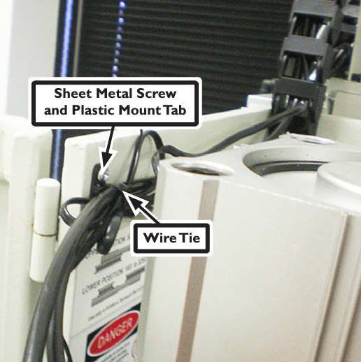

  1. Using a Phillips screwdriver, mount the Plastic Mount Tab with one Sheet Metal Screw as shown in Figure 19. This will be used to bundle the Pendant wire and air tubes securely.
Figure 19

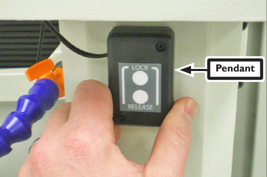

  1. Using pre-installed double-sided tape on back of the Pendant, mount the Pendant to the spindle head (see Figure 20).
Figure 20

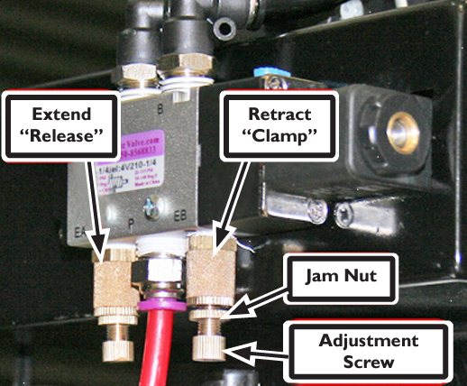

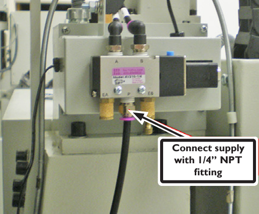

  1. Connect the air lines as shown in Figure 21.
NOTE: Do not cut air lines shorter than provided. The cylinder needs to pivot out and away in order to gain access for belt changes, and the tube needs to be long enough to do this without disconnecting the lines.
Figure 21
  1. Bundle the air tubes and Pendant wire so that they are up and out of the way. Using a Wire Tie, mount them to the Plastic Mount Tab installed earlier in this section (see Figure 19).
  2. Connect air supply to the air valve as shown; the port requires a 1/4” NPT fitting (see Figure 22).
Figure 22

Pendant Control
image-20241211-204924.png WARNING! Ejection Hazard: Tooling could become a dangerous projectile. Do not press Pendant buttons before spindle has come to a complete stop; do not press Pendant buttons without one hand on the tool holder. Failure to do so could result in death, serious injury, and/or machine damage.
With one hand on the tool holder, press and hold Release to activate the power drawbar and release the tool holder in the spindle (see Figure 23); insert a new tool holder. Release the button to clamp the new tool holder in the spindle. The power drawbar automatically reverts to clamp mode when the button is released.
Figure 23
It is best to either:
  • Leave the tool in the collet wile the power drawbar is in the clamped position
  • Leave the power drawbar in the unclamped position while there is no tool in the collet
Retracting the power drawbar to the clamped position with no tool in the collet will eventually fatigue the collet, and may shorten its service life.
The Lock button is used in the event that two hands are needed to insert a tool holder. The Lock button works much like a lock button on a hand drill – when activated, it holds the Power Drawbar in the release position without the need to hold the Release button. To activate the lock, push and hold Release, then push and release Lock. To deactivate the lock, push Lock.
NOTE: The power drawbar reverts to the clamped position in the event of an air pressure loss and in the event of a power loss.

  1. Insert TTS® collet and thread in the Power Drawbar.
  2. Install an empty TTS tool holder in the collet.
  3. Using a standard drawbar wrench and a 13/16 inch wrench, tighten the Power Drawbar to approximately the same torque normally used to tighten a manual drawbar system.
  4. Actuate the Power Drawbar by pushing the Release button. If the tool releases, go to Step 5; if the tool does not release, go to Step 6.
  5. If the tool holder releases, tighten the Power Drawbar using a standard drawbar wrench and a 13/16 inch wrench in quarter-turn increments, pushing the Release button after each increment until the tool holder does not release.
  6. Loosen the Power Drawbar a quarter-turn using two large adjustable wrenches; push Release. The tool holder releases.
NOTE: If the tool holder does not release, repeat Steps 5-6.
  1. Using a paint pen or similar, put witness marks on the Power Drawbar head and the spindle body to maintain a visual reference of proper adjustment.
Latch Height Adjustment
On some installations it is possible that when the spring washers are compressed by the cylinder, the TTS® collet remains embedded in the spindle even though the clamping tension in the Power Drawbar has been released. This happens from friction between the TTS collet and the side walls of the spindle bore. The air cylinder can only remove tension on the Power Drawbar, and, save for its own weight pushing down on the drawbar, does not exert any additional downward force. This can also be seen on a manual drawbar set-up where the top of the drawbar may require tapping to get the tool to drop out. The purpose of the Latch Plates is to utilize a small portion of cylinder force to act as a tapping action.
  1. Make sure that the Latch Adjustment Screws are fully retracted into the left and right Latch Plate (see Figure 24).
Figure 24
  1. Using the Pendant, push the RELEASE and the LOCK buttons to activate and hold the Power Drawbar.
  2. Place a block of wood or similar under the spindle and collet. Then, slowly lower the Z-axis to the block.
  3. When the collet contacts the bock, it will push up on the drawbar and Cylinder Assembly. Continue to slowly bring down the Z-axis until the collet bottoms out in the spindle.
IMPORTANT! This condition represents what might happen if a collet gets stuck while actuating the Power Drawbar. To avoid damage to the collet and the mill, do not over travel during this step.
  1. Using a hex wrench, tighten the Latch Adjustment Screws until they just touch the Cylinder Mounting Plate (see Figure 24).
  2. Push the LOCK button to release the Power Drawbar and raise the Z-axis up off the wooden block.
NOTE: Access will likely be easier to swing the cylinder out of the way. Tighten the Latch Adjustment Screws one additional turn and then, without turning these screws, further tighten the Jam Nut (see Figure 19).
  1. Re-engage the cylinder and test it.
NOTE: If the Cylinder Mounting Plate engages the set screws before it engages the Drawbar Flange, then the adjustment screws have been tightened too much. Repeat this adjustment procedure, loosening the adjustment screws 1/4 turn.

Exhaust Valve Adjustment
The air valve in this system has two adjustable choked exhaust ports. Adjusting these ports changes the rate at which air will exit the system. Tightening the screw slows air flow (and motion); loosening increases the flow (and motion). Retract can be adjusted for fast motion, but Extend should be a bit slower (see Figure 25).
Figure 25
If this is adjusted too tight, no flow occurs and the cylinder will likely not move. If these are adjusted too loose, the cylinder moves too fast and impacts the drawbar with more speed than is needed, increasing wear on the system. Proper adjustment results in smooth and solid motion with no banging and no sluggishness.
NOTE: Make sure that the jam nuts are tightened when the adjustment is complete.

  • To provide smooth motion during actuation and prevent premature component failure, use pressurized air that has been lubricated with common air tool oil.
  • There are two places on the system that require greasing once every 5000 cycles or six months, whichever comes first:
  1. Top of the Power Drawbar (under the drawbar flange and the spring washers)
  2. Eccentric pivot mount
  • Spring washers are wear items; inspect all spring washers once a month for cracks. Replacements available for purchase at www.tormach.com include:

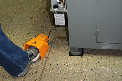

Power Drawbar Foot Pedal Kit
The Power Drawbar Foot Pedal Kit (PN 31728) provides foot activation of the Power Drawbar for hands-free operation.
  1. Remove the Power Drawbar electrical housing (see Figure 26).
Figure 26
  1. Plug the foot pedal cable into the foot pedal connector port on the Power Drawbar control board (see Figure 27).
Figure 27
  1. Place the foot pedal in a position that allows for easy access during mill operation (see Figure 28).
Figure 28

Visually inspect that cylinder hex bolt is aligned concentrically with the drawbar. Refer to Mechanical Assembly section earlier in this document for more information.
It is ideal to pass 100 percent of the available cylinder force directly down into the spring washers. Any misalignment will result in some side loading and a reduction of downward force. Component damage can also occur in cases of extreme misalignment.

Cylinder is stroking out (running out of travel) before compressing the spring washers fully
Low
There should be no more than a 1/8” gap between the cylinder hex bolt and the top of the drawbar. If gap is too large, cylinder will stroke out (run out of travel).
This will primarily be an issue found only during installation. Should this occur, add a flat washer under the cylinder rod hex bolt to reduce gap. For more information, refer to Mechanical Assembly section earlier in this document.
