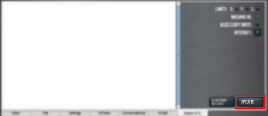

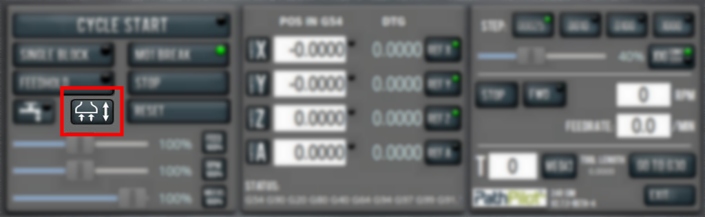

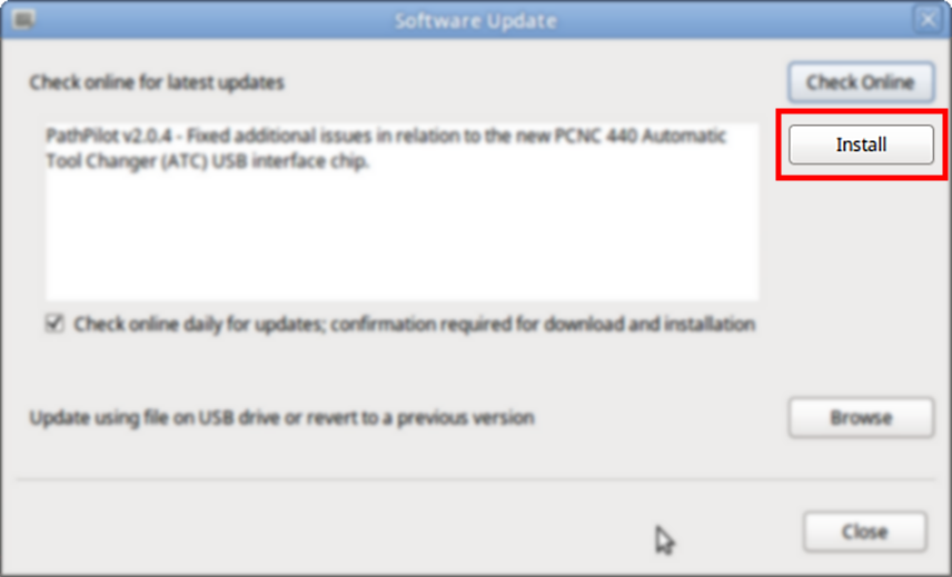

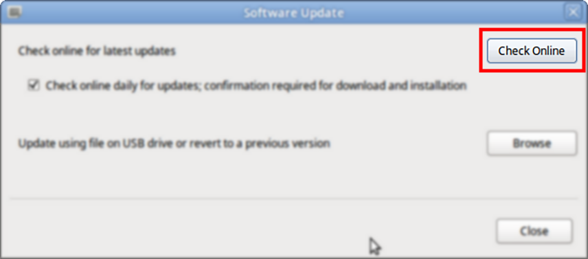

Update PathPilot
If you haven't yet done so, you must update your controller to at least version 2.9.0 of PathPilot.
Figure 2: Update button on the Status tab.
Figure 3: Software Update dialog box.
  1. Select Install.
Figure 4: Install button on the Software Update dialog box.

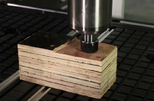

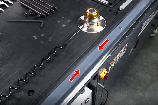

  2. Put a block of wood below the spindle on the machine table. Then, slowly jog the Z-axis down until the spindle is resting on the block of wood.
Figure 1: Wood block to support the spindle.

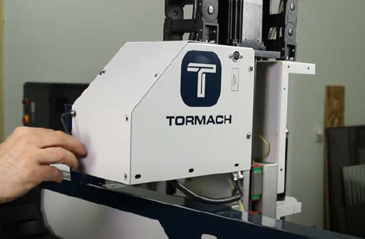

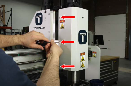

  2. Remove the six M5 button head cap screws that secure the front spindle cover with a 3 mm hex wrench. Set aside the screws and the cover.
Figure 2: Removing the M5 screws that secure the front spindle cover.

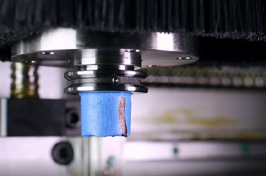

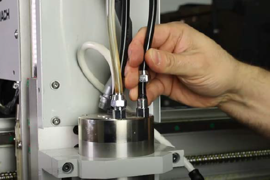

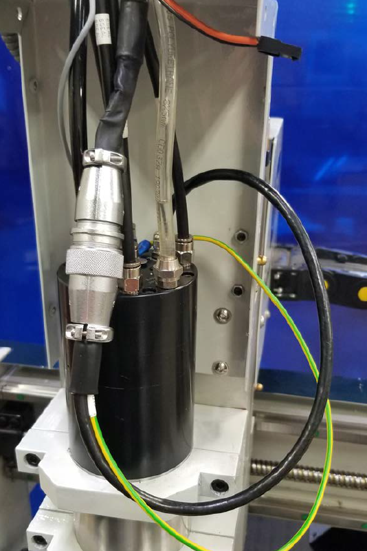

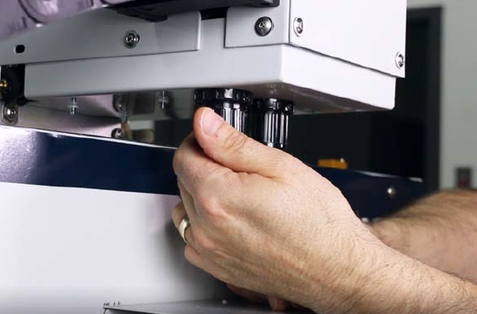

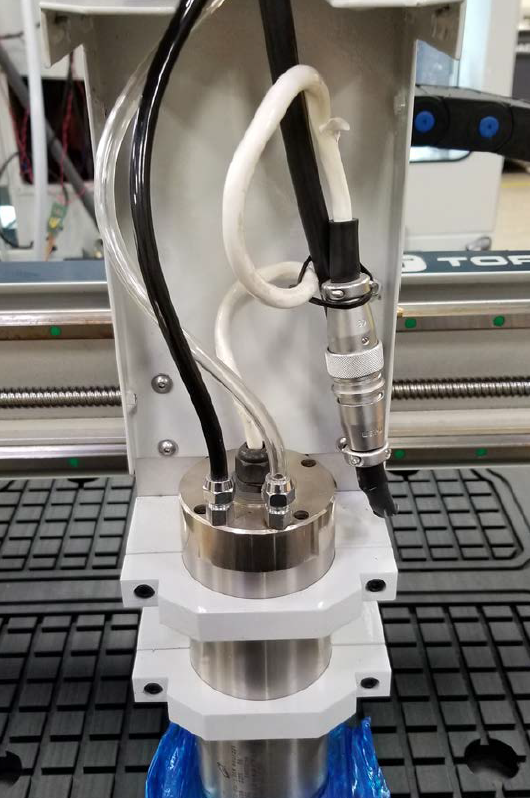

  1. From the top of the spindle, disconnect the two water lines with a 14 mm wrench.
Figure 4: Two water lines on the existing spindle.

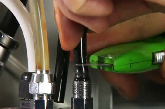

NOTE: We recommend that you put a piece of tape or a black mark on the clear water line. There's another clear line involved in this procedure, so marking this line helps to prevent confusion.
  1. If the water lines are difficult to remove from the fitting, cut them with a knife about 1/2 in. above the fitting.
Figure 5: Cutting the water lines from the fitting.

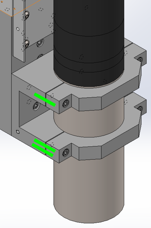

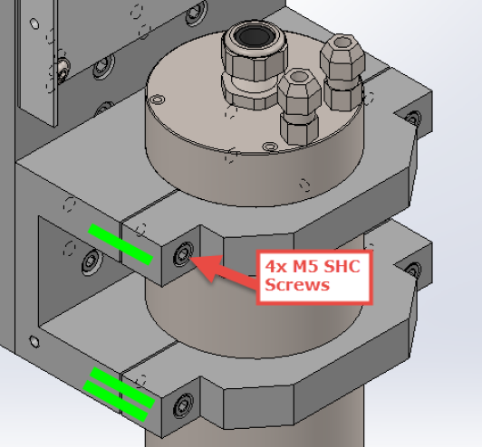

  1. Mark each of the spindle clamps, as shown in the following image, to indicate which is the top and which is the bottom. You'll use the marks later to correctly realign the spindle clamps to the spindle mount.
Figure 6: Spindle clamps marked to indicate the top and bottom.
  1. Use one hand to support the spindle, and use your other hand to remove the four M5 socket head cap screws that secure the spindle clamps. Set aside the screws and the spindle clamps.

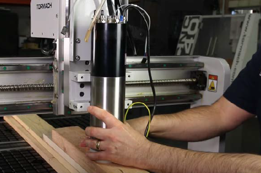

Install the New Spindle (ISO20)
Before You Begin: A Note About Spindle Heights
You can adjust the installation height on the 24R spindle to fit your project. For example, you can install it lower to be able to machine thin parts with short tools or you can raise the spindle up to give yourself more clearance for thicker parts and long tooling.
As a good starting point, we recommending starting low and keeping the black portion of the spindle flush or slightly above the top clamp.

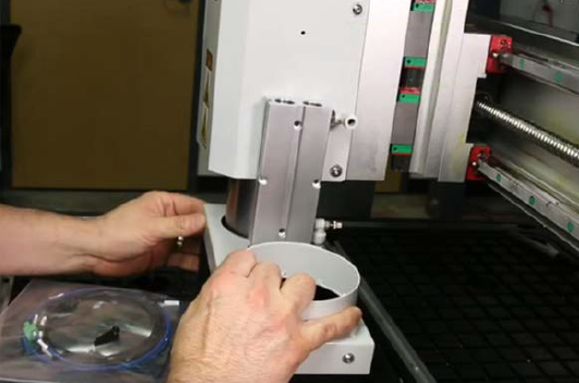

  1. Put the ISO20 spindle onto wood blocks on the machine table, and then put the spindle into the spindle mount. Orient the spindle so that the coolant ports are pointing toward the front.
Figure 7: Putting the spindle into the spindle mount.
  1. If necessary, use additional pieces of wood or cardboard to raise the spindle higher in the spindle mount. Don't mount the spindle too low — verify that both clamps are clamped on the main body (the silver section) of the spindle, and that the clamps are spaced evenly on each side.
  2. Mount the ISO20 spindle with the spindle clamps and screws (that you set aside earlier) and a 4 mm hex wrench. Align the top and bottom mounts, as shown in the following image, using the marks that you made on the spindle mount before you removed the clamps.
Figure 8: Mounting the ISO20 spindle.
Tip! It may be useful to have an assistant help support the spindle while you're installing the clamps.

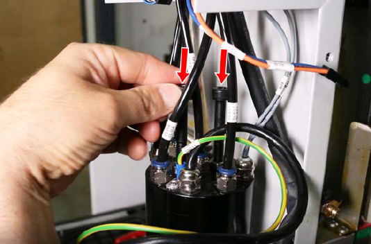

  1. Remove the cap from the coolant ports with a 14 mm wrench. Then connect the water lines to the fittings on the top of the spindle in the following order:
  • Connect the black line to the Water Inlet.
  • Connect the clear line to the Water Outlet.
Figure 10: Water line connections.
  1. Identify the spindle power connector on the spindle, and connect it to the machine's spindle power connector.
Figure 11: Spindle power connector.

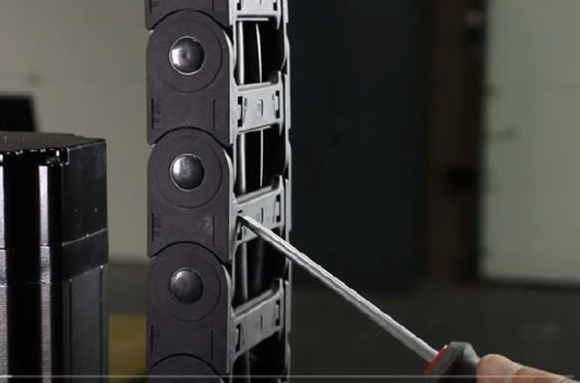

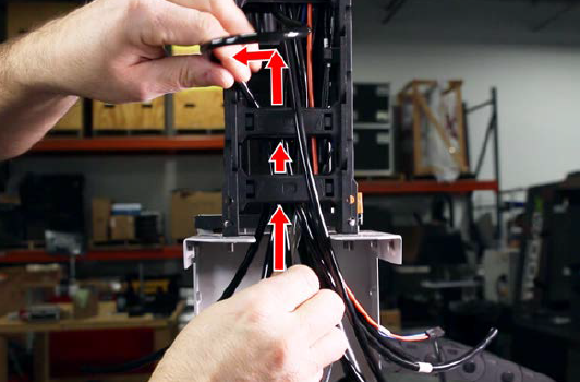

  1. Remove some pieces from the energy chain by gently prying them with a small, flat-blade screwdriver.
Figure 12: Removing pieces of the energy chain.
Tip! We recommend leaving a few of the energy chain pieces installed to help keep the wires and tubes organized while you route the new lines.

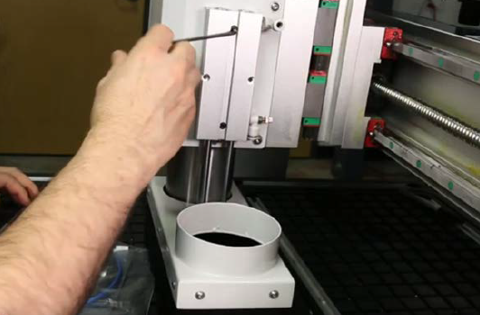

  1. Remove the eight M5 screws that secure the rear Z-axis access panel with a 3 mm hex wrench. Set aside the screws and the panel.
Figure 13: Rear Z-axis access panel.

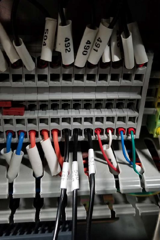

Rewire the ATC Cable

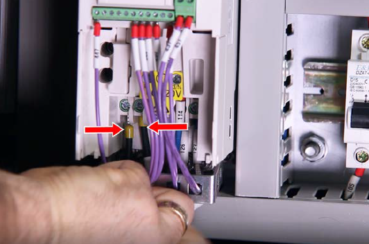

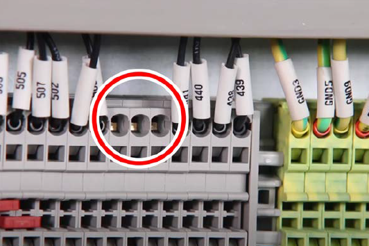

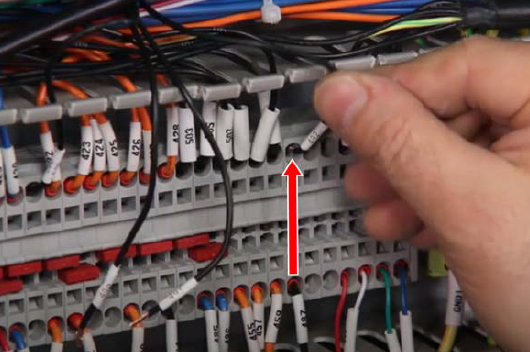

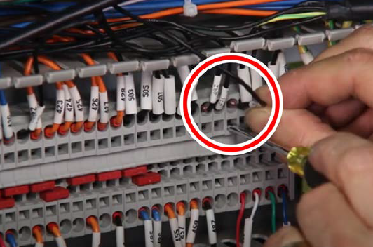

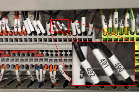

IMPORTANT!  On earlier machines, the ATC cable wasn't installed on the inside of the electrical cabinet. Follow this procedure to verify this connection before installing the solenoid tray.
  1. To determine if you need to connect your ATC cable, open the electrical cabinet and, on the terminal strip, find wires 490, 491, and 492.
Figure 14: Wires 490, 491, and 492 connected.
  • If the wires aren't connected, as shown in the following image, proceed to the next step in this section.
Figure 15: Wires 490, 491, and 492 not connected.
  1. Remove the wire trough covers and set them aside.
  2. In the electrical cabinet, locate the ATC cable — it's a black cable with six black wires and one green/yellow wire. The cable is in one of two places:
  • The left-most wire trough
  • The bottom wire trough
  1. From the end of the ATC cable, measure 6 in. (15 cm) and make a mark.
  2. Carefully strip away and remove the cable's main insulation all the way back to the mark with a knife or an insulation stripping tool.
  3. Push the metal sleeve back so that it bunches up at the bottom, and carefully cut away at the material with wire cutters.
  4. Trim away the extra plastic and paper from inside of the cable, and clean any talcum powder from the wires.
  5. Strip 1/4 in. (6 mm) from the ends of the six black wires with a wire stripper.
  6. In the rear Z-axis cover, find the round ATC connector on the ATC cable.
  7. Use a multimeter to perform a continuity test between each pin on the ATC connector and each of the six black wires at the other end of the cable inside the electrical cabinet. Use the following table to identify each wire, and then apply a wire number label 2 in. from the end of each wire.
ATC Connector Pin
ATC Cable Wire
Pin 1
Wire 492
Pin 2
Wire 490
Pin 3
Wire 491
Pin 4
Wire 508

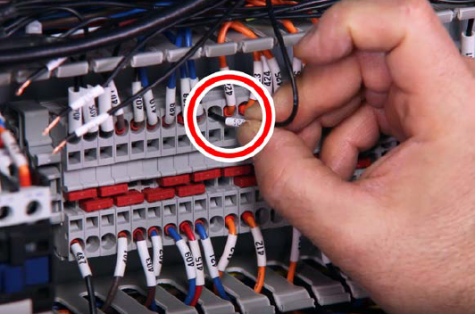

  1. Trim the remaining three black wires and one green/yellow wire back to the main insulation with a pair of cutters. Because these wires aren't used for any connections, you can clean up any remaining metal sheathing and tape the wires back with electrical tape.
  2. On the terminal strip, find the three open terminal blocks that you identified earlier.
  3. Connect wire 492 to the terminal block by inserting it into the open part of the terminal block across from wire 487.
Figure 16: Connecting wire 492 to the terminal block.
  1. Connect wire 490 and wire 491 into the open ports on the terminal block next to wire 492.
Figure 17: Connecting wire 490 and wire 491 to the terminal block.

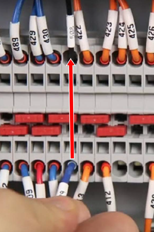

  1. Connect wire 508 to -24 Vdc by connecting it to one of the open terminals as shown below.
Figure 18: Connecting wire 508 to the terminal block.

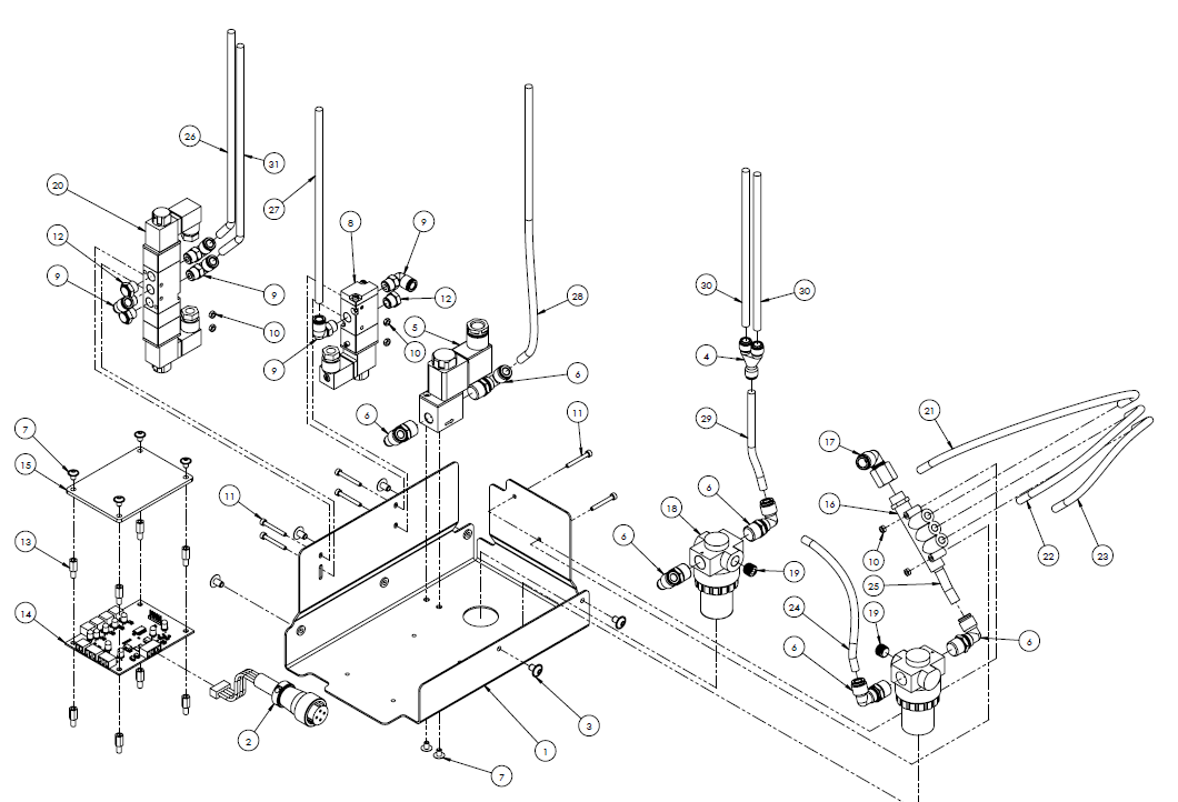

Install the Solenoid Tray
  1. Route the extra length of air supply line back through the energy chain and to the solenoid tray.

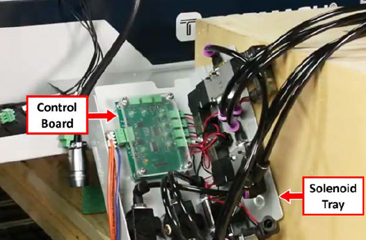

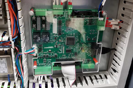

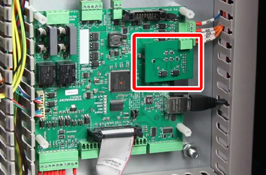

  2. Find the solenoid tray provided with this kit, and then identify the ATC control board mounted in it.
Figure 19: Control board in the solenoid tray.

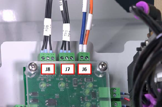

  1. Make the connections to the ATC control board as detailed in the following table.
Identify the...
Connect to...
BTN power drawbar button wires (from the Z-axis energy chain)
J6 connector
TPS wire cable (from the spindle)
J7 connector
PDB wire cable (from the spindle)
J8 connector
Figure 20: ATC control board connections.

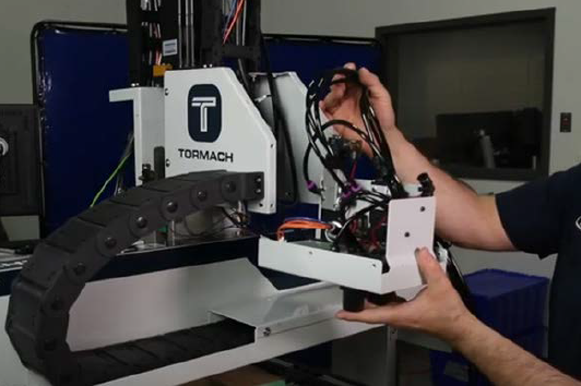

  1. Identify the pre-installed ATC cable in the rear Z-axis cover. Then, connect it to the ATC power connector on the ATC solenoid control assembly.
  2. Lift the ATC solenoid control assembly up into the bottom of the rear Z-axis cover. Align the threaded holes on the side of the tray with the horizontal slots in the rear Z-axis cover.
NOTE: Be careful to not pinch wires while lifting the tray into position.
Figure 21: Solenoid control assembly.
  1. Find five M5 screws provided with this kit, and use them to secure the solenoid control assembly to the rear Z-axis cover.
  2. Identify the pre-installed 8 mm air hose in the rear Z-axis cover. Then, trim the length and connect it to the 8 mm push-to-connect fitting on the ATC solenoid control assembly.
NOTE: You may need to pull the air line back from within the inside of the Z-axis energy chain.
  1. Reinstall all of the energy chain links that you removed earlier in this procedure.

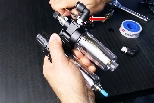

Connect the Filter-Regulator-Lubricator (FRL) to the Rear of the Machine

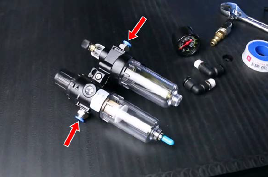

  1. Remove the two 1/4 in. push-to-connect fittings on either side of the FRL with a 14 mm open socket wrench.
Figure 22: Preinstalled push-to-connect fittings on the FRL.
  1. Install the two included 5/16 in. push-to-connect elbows to either side of the FRL with a 14 mm open socket wrench. Teflon tape is preinstalled on these elbows.
Figure 23: Installing the included push-to-connect elbows on the FRL.

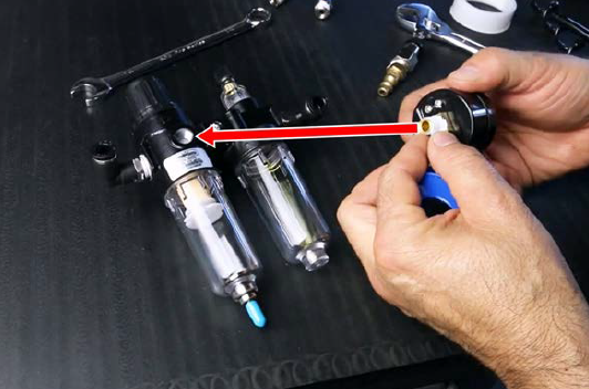

  1. Wrap Teflon tape onto the threads of the included dial. Then, install the dial on the FRL. Do not overtighten.
Figure 24: Preparing the dial for installation on the FRL.

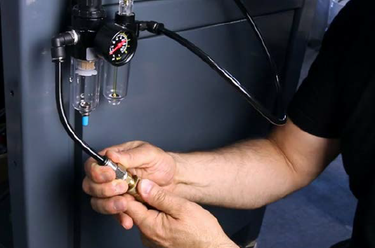

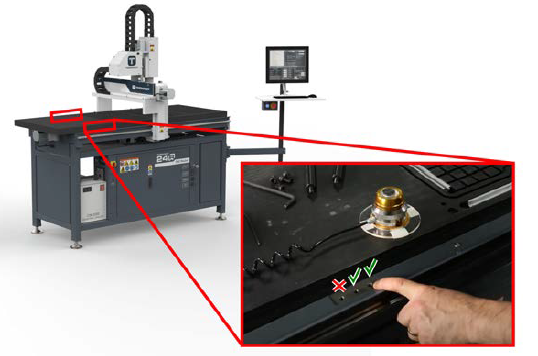

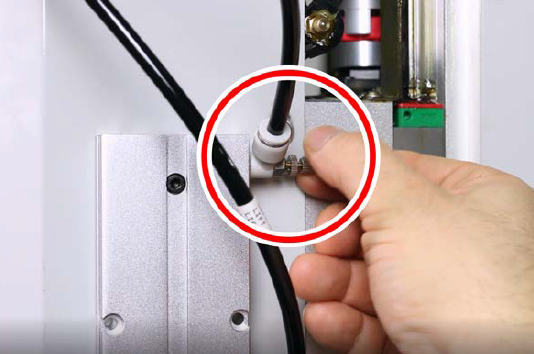

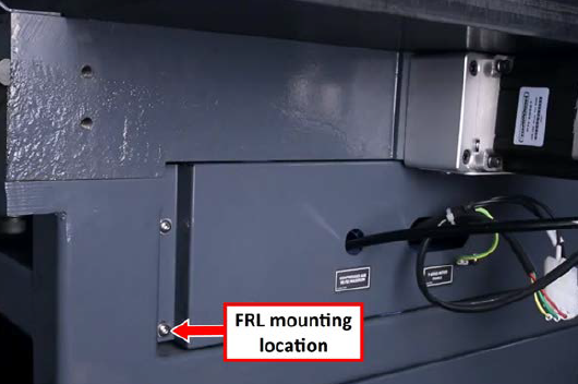

  1. On the rear of the machine, remove the bottom hex screw on the panel shown in the following image with a hex wrench.
Figure 25: Hex screw to remove for mounting the FRL.
  1. Slide the included socket head cap screw into the top FRL bracket, and slide the spacer onto the backside of the screw. Then, secure the socket head cap screw to the machine with a 3 mm hex wrench.

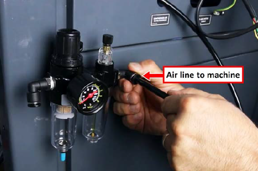

  2. Attach the air line going into the machine to the right push-to-connect elbow on the FRL.
Figure 26: Connecting the machine's air line to the FRL.
  1. Connect the loose end of the 6 in. air line (with the air fitting) to the left push-to-connect elbow on the FRL.
IMPORTANT! Don't connect the fitting to your shop's air supply yet. You'll do so later in this procedure.

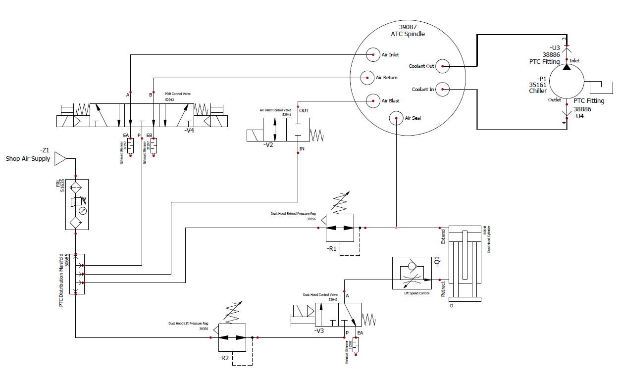

Connect the Air Lines to the Spindle
  1. Route the loose ends of the air lines from the solenoid panel assembly, through the Z-axis energy chain, and toward the spindle.
  2. Identify the two air lines labeled Lift and EXT. Route the air lines toward the spindle and out the front of the Z-axis energy chain two links before the spindle cover. You'll connect the air lines later in this procedure.
Figure 27: Pulling the dust shoe air lines through the energy chain.

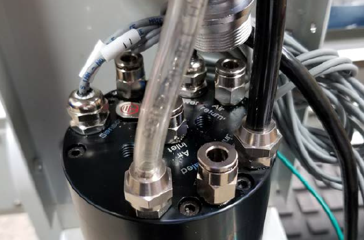

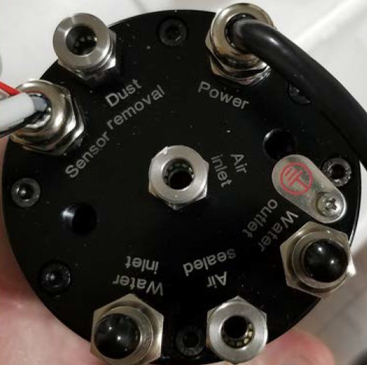

  1. Identify and connect the following air lines to the push-to-connect fittings on the top of the spindle.
Air Line
Fitting
Blast
Dust Removal
Open
Air Inlet
Seal
Air Sealed
Close
Air Return
Figure 28: Air line connections.
Tip! If the air lines are too long, trim them to length.

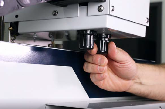

Install the Power Drawbar Button

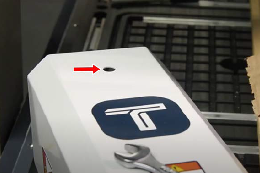

  1. Unplug the power drawbar button at the connector near the spindle from the wires previously routed up through the Z-axis energy chain.
  2. Put the power drawbar button into the hole on the spindle cover, and tighten the lock washer and nut onto the button.
Figure 29: Power drawbar button hole on the spindle cover.
NOTE: Earlier machines (RA10001-RA10036) didn't include a hole for the power drawbar button. If you have one of these machines, use the new Spindle Cover (PN 39086) provided in this kit.
  1. While holding the spindle cover up to the spindle head, identify the power drawbar button wires from the Z-axis energy chain, and plug them in to the power drawbar button.
  2. Attach the spindle cover to the spindle head with the six M5 screws from earlier in this procedure and a 3 mm hex wrench.

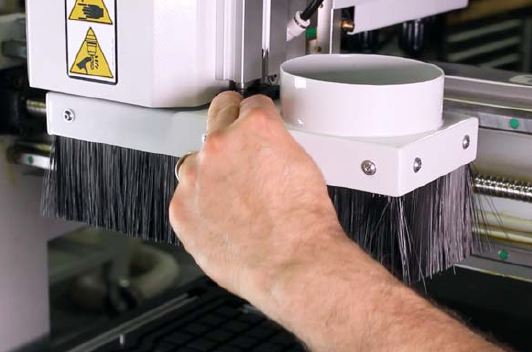

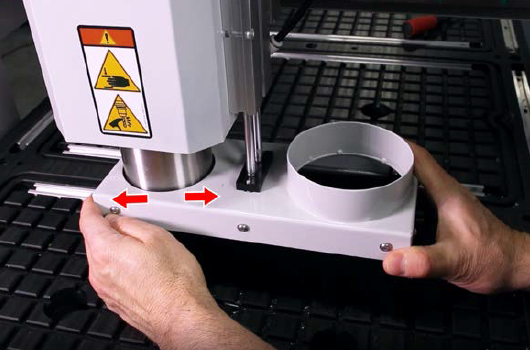

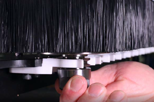

Install the Lifting Dust Shoe

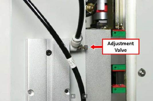

  1. Verify that the top push-to-connect fitting on the dust shoe has the adjustment valve. If it's installed on the bottom, remove it with a wrench and switch it to the top location. Securely tighten both fittings.
Figure 30: Adjustment valve on the top push-to-connect fitting of the dust shoe.
  1. Slide the non-flanged end of the dust shoe onto the spindle. Then, align the center dust shoe holes on the spindle cover.
Figure 31: Sliding the dust shoe onto the spindle.
  1. Mount the dust shoe to the spindle cover with the two socket head cap screws and a 3 mm hex wrench.
Figure 32: Mounting the dust shoe onto the spindle cover.
  1. Install the air line labeled LIFT to the push-to-connect fitting into the lower port on the double rod cylinder (nearest to the dust shoe).
  2. Install the air line labeled EXT to the push-to-connect fitting into the upper port on the double rod cylinder (furthest from the dust shoe).
  3. Lift and lower the dust shoe, and observe the motion to determine if it rubs on the spindle. If it does, loosen the Phillips head screws a quarter-turn to adjust the position of the shoe until it's clear of the spindle. Then, re-tighten the Phillips head screws.
Figure 33: Adjusting the position of the dust shoe.
Install the ATC Communication Board

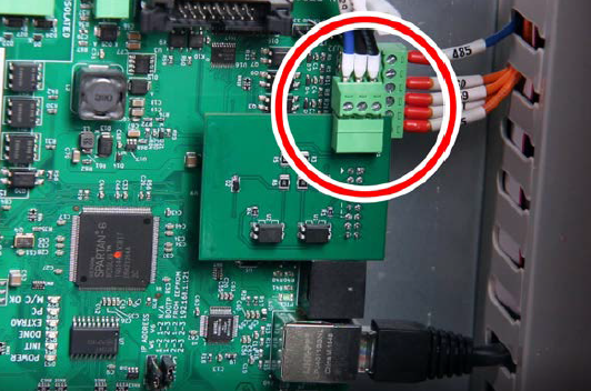

  1. In the electrical cabinet, from the machine control board, remove the four screws securing the acrylic board shield with a 2.5 mm hex wrench. Set aside the shield and the screws.
  2. Find the ATC communication board provided in this kit. Then, plug the black connector on the ATC communication board into the P1 auxiliary port on the machine control board.
Figure 34: ATC communication board installed onto the machine control board.
Locate the wire harness for the ATC communication board with wires labeled 530 and 531. Connect them as follows:
  • Connect the loose end of wire 530 to the open port of the terminal block connected to wire 490.
  • Connect the loose end of wire 531 to the open port of the terminal block connected to wire 491.
Figure 35: Wires 530 and 531 connected to the terminal block.
  1. Connect the loose end of wire 529 to the open port of the terminal block connected to wire 508.
Figure 36: Wire 429 connected to the open port of wire 508.

  1. On the machine table, near the back end (Y+) of the machine, locate the three M8 threaded holes on each side of the machine. You'll use these to mount the ATC rack. If you don’t see the three threaded holes, you must remove the linear rail cover punch-outs.
Figure 39: Linear rail cover punch-outs.
Remove Linear Rail Cover Punch-Outs
NOTE: If your machine has punch-outs on the linear rail covers, you must remove them before you mount the ATC rack.

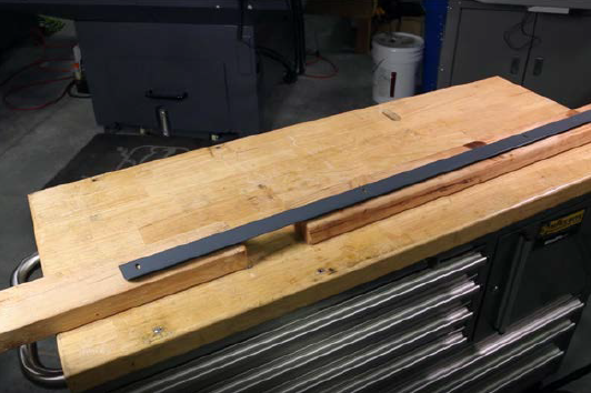

  1. Remove the five M5 button head cap screws securing the left and right linear rail covers to the bed casting with a 3 mm hex wrench.
  2. Put a short and a long wood block onto a secure work surface and align the first linear rail cover in the open space.

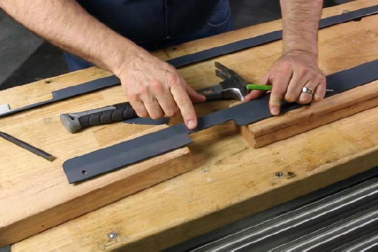

  3. Support one of the linear covers with two wooden blocks, aligning the punch-out between the blocks.
Figure 40: Linear rail cover on two wooden blocks.

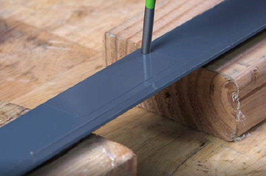

  1. Break the tabs securing the punch-out to the linear rail cover with a punch and a hammer. Start with one of the tabs closest to the edge of the linear rail cover.
Figure 41: Using a punch to break the tab closest to the edge of the linear rail cover.
  1. Break the remaining tabs one-by-one, working your way around the punch-out until all of the tabs are broken. Remove the punch-out.
Figure 42: Linear rail cover with punch-out removed.
  1. Repeat Steps 2 through 4 with the punch-out on the other linear rail cover.
  2. Re-attach the linear rail covers to the bed of the machine with a 3 mm hex wrench and the five M5 button head cap screws that you set aside in Step 1.

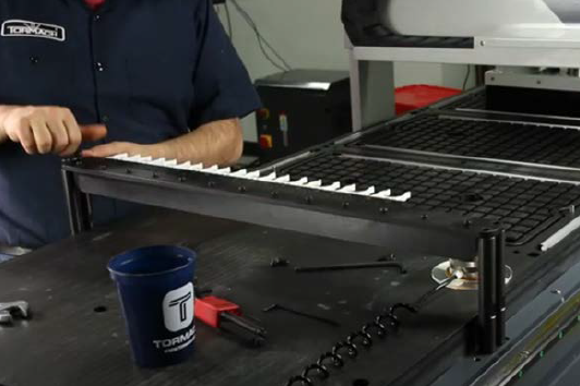

Mount the ATC Rack

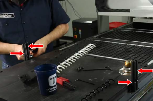

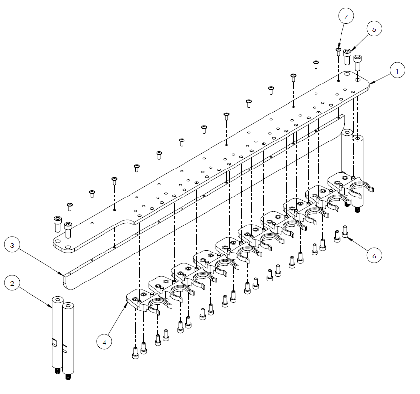

  1. Find the ATC rack provided with this kit. Then, remove the four M8 bolts securing the standoffs to the bottom of the ATC rack with a 6 mm hex wrench and a 16 mm wrench. Set aside the M8 bolts.
  2. Identify the two sets of three holes on either side of the machine table. You'll install the ATC rack's two standoffs into two of the holes (the hole that's furthest to the left is unused and remains open).
Figure 43: ATC rack standoff holes.
  1. Install the standoffs into the two holes with a 16 mm wrench.
Figure 44: Installing the standoffs onto the machine.
  1. Turn the rack so that the mounting screws for the tool forks are on the bottom of the rack, and then mount the ATC rack to the top of the standoffs with the four M8 bolts that you set aside earlier.
Figure 45: Installing the rack onto the standoffs.

  2. If you haven't yet done so, you must update your controller to at least version 2.9.0 of PathPilot. From the PathPilot interface, on the Status tab, select Update.

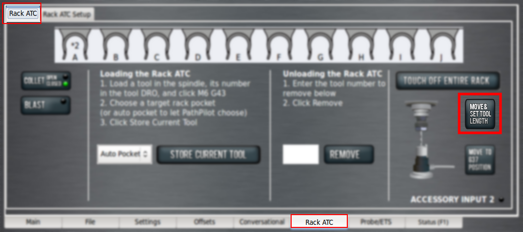

  3. Once PathPilot has been updated, from the Settings tab, select Rack Tool Changer.
    The Rack ATC tab displays next to the Status tab.

Adjust the ATC Air Pressure Settings
The ATC has three air pressure control settings that you must adjust before operation.
Pressure Control Settings Overview
The three air pressure control settings are:
  1. Spindle Nose Seal and Dust Shoe Extend Pressure Regulator (closest to the operator side of the machine (X-))
  2. Dust Shoe Lift Pressure Regulator (furthest from the operator side of the machine)
  3. Dust Shoe Lift Speed Control Valve
The Spindle Nose Seal and Dust Shoe Extend Pressure Regulator has two functions:
  • The ISO20 spindle has a positive pressure air seal around the spindle nose. The constant flow of air from the spindle nose keeps dust out of the spindle bearings during operation. The pressure regulator controls the flow rate of air that is purged from the spindle nose.
  • This pressure regulator also adjusts the downward force applied to the lifting dust shoe.
Both the spindle nose air seal and the downward force on the lifting dust shoe require the same amount of air pressure. The downward force on the lifting dust shoe should be enough to fully extend the dust shoe but not enough to fold the bristles in half when lifting the dust shoe with both hands.
The Dust Shoe Lift Pressure Regulator controls the upward force applied to the lifting dust shoe when in the up position. The pressure should be set such that the dust shoe fully lifts when commanded and the dust shoe can still be pushed downward with two fingers.
The Dust Shoe Lift Pressure Regulator should be adjusted after adjusting the Spindle Nose Seal and Dust Shoe Extend Pressure regulator.
The Dust Shoe Lift Speed Control Valve fitting is a one way flow control valve and it controls how quickly the dust shoe moves upward when it is lifted. This valve should be open when adjusting the Spindle Nose Air Seal and Dust Shoe Extend Pressure Regulator and then fine tuned after setting the pressure on the Dust Shoe Lift Pressure Regulator.

  1. At the back of the machine, connect the air line from the air compressor to the FRL's air fitting inlet that you connected earlier. Verify that the air compressor is set between 90 psi and 120 psi.
Figure 46: Connecting the air compressor's air line to the FRL.
  1. Identify the dust shoe lift speed control valve on the top of the lifting dust shoe cylinder. Loosen the locking nut. Then open the valve by turning the adjustment screw counterclockwise 1-3 full turns.
Figure 47: Loosening the dust shoe lift speed control valve.
  1. On the bottom of the ATC solenoid control panel, identify the spindle nose air seal and dust shoe extend pressure regulator, and pull down to unlock the pressure regulator.
Figure 48: Unlocking the dust shoe extend pressure regulator.

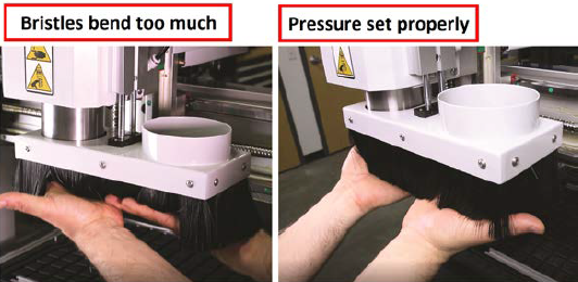

  1. Turn the knob clockwise to increase the air pressure until you begin to hear air coming from the air seal around the nose of the spindle.
  2. Place the palms of both hands below the bristles of the lifting dust shoe and lift the dust shoe upward. Then release the lifting dust shoe and allow it to extend.
    1. If the lifting dust shoe does not fully extend, turn the air pressure regulator clockwise to increase the pressure.
    2. If the bristles on the dust shoe bend too much when lifting the dust shoe with both hands, turn the pressure regulator counterclockwise to decrease the pressure.
  1. Once the pressure is set properly, push the knob back up to lock the pressure regulator.

  1. From the PathPilot interface, select Lift/Lower Dust Shoe.
Figure 49: Dust Shoe button.
  1. On the bottom of the ATC solenoid control panel, identify the dust shoe lift pressure regulator, and pull down to unlock the pressure regulator.
Figure 50: Unlocking the dust shoe lift pressure regulator.
  1. Turn the knob clockwise to increase the lifting pressure until the dust shoe lifts all the way up.
  2. Using two fingers, push the lifting dust shoe downward.
Figure 51: Pressing down on the dust shoe.
  1. If you can't push the lifting dust shoe downward with two fingers, turn the pressure regulator counterclockwise to decrease the pressure.
  2. From the PathPilot interface, select Lift/Lower Dust Shoe. The dust shoe goes back down.

  1. From the PathPilot interface, select Lift/Lower Dust Shoe to lift the dust shoe. Observe the speed of how quickly the dust shoe lifts.
  2. Select Lift/Lower Dust Shoe Button to lower the dust shoe.

  1. Remove the collet nut from an ISO20 tool holder and put a piece of tape onto the side of the tool holder. Draw a vertical line onto the tape. Then install the tool holder into the spindle.
Figure 53: Tape and line indicator installed into the spindle.

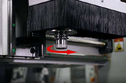

  1. From the PathPilot interface, on the Main tab, in the RPM DRO field, type 10,000. Then select the Enter key.
  2. While observing the spindle, select Fwd, and then select Stop.
    The spindle turns on, rotates counterclockwise, and turns off.
Figure 54: Spindle rotating counterclockwise.
  1. Depending on the direction in which the spindle rotated in Step 3, do one of the following:
  • Rotates Clockwise (Viewed from Above) You've completed the spindle function verification. Go to "Align the ATC Rack".
  • Rotates Counterclockwise (Viewed from Above) Power off the machine and, on the variable frequency drive (VFD), swap wire U and wire V. Then, power on the machine, and repeat Steps 2 through 3.
Figure 55: Wire U and wire V on the VFD.

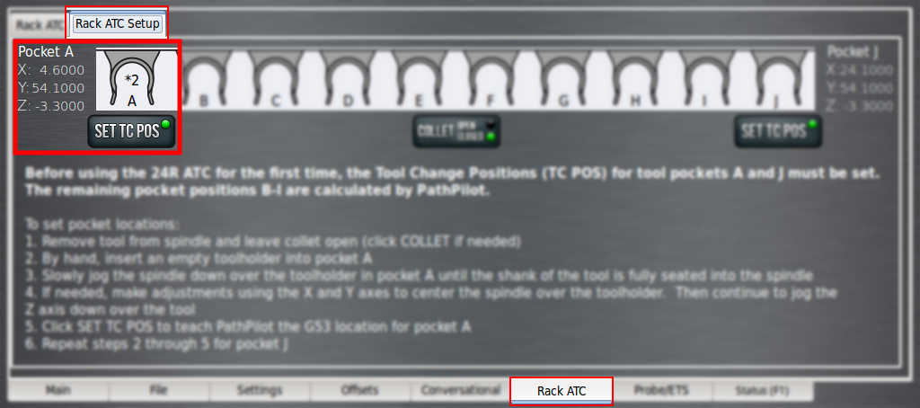

Before using the 24R ATC for the first time, you must set the tool change positions for tool pockets A and J to align the ATC rack to the machine's reference position.

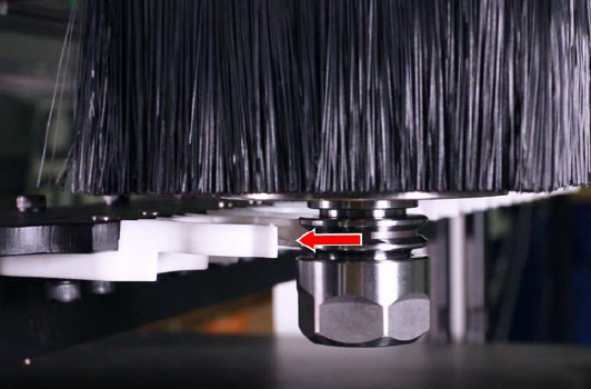

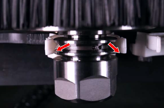

  1. Jog the machine in the Y+ direction to move the tool holder into the ATC rack while watching the tool fork. You want to see both forks start to bend out at the same time when the tool starts engaging the fork. Make any adjustments needed in the X direction.
Figure 57: Tool forks bending out together.
  1. Continue jogging the machine in the Y+ direction until the holder is seated in the ATC fork. You can determine this visually or by rotating the tool by hand. When the tool holder touches the back of the fork, you'll feel the drag increase.
Figure 58: Rotating the tool holder to feel when the drag increases.

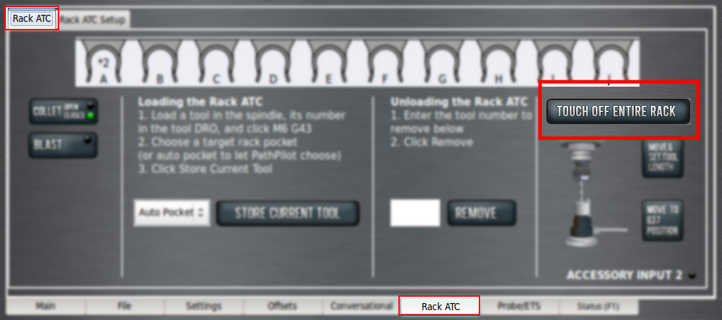

  1. From the PathPilot interface, select Set TC POS below pocket A to teach the location for Pocket A.
Figure 59: Set TOC POS button on Rack ATC Setup tab.

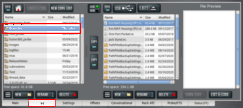

  3. From the PathPilot interface, on the File tab, open the Examples folder. Then, double click the program called 24R_spindle_breakin.ngc.
Figure 60: Examples folder on the File tab.
The program loads on the Main tab.
  1. Select Cycle Start.
    The spindle runs through the three-hour break-in procedure, where it rotates in increments of 10,000, 20,000, and 24,000 rpm. After the program finishes, the break-in procedure is complete.

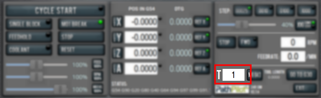

  4. From the PathPilot interface, in the Tool Number DRO field, type the tool number. Then select the Enter key.
Figure 62: Tool Number DRO field.

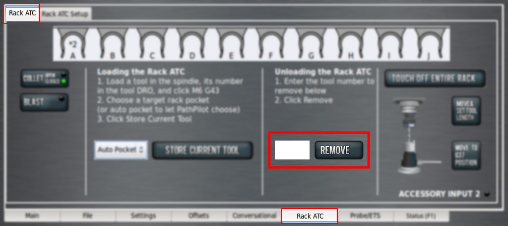

By default, the ATC is a random pocket ATC. This means that, to load and store a tool into the ATC rack, you only need to select the Store Current Tool button — PathPilot then finds an open pocket to use. However, you can also actively select a specific pocket by using the Selected Pocket drop-down menu.
Automatically Select a Pocket

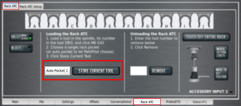

  1. If you haven't yet done so, load a tool into the spindle.

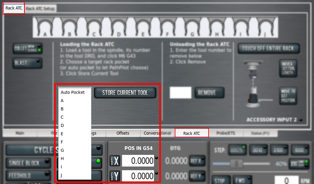

  2. From the PathPilot interface, on the Rack ATC tab, select Store Current Tool. The Selected Pocket drop-down menu selection defaults to Auto Pocket.
Figure 64: Store Current Tool button on the Rack ATC tab.
The machine moves to the first available ATC pocket and stores the tool in the ATC rack.
Select a Specific Pocket
  2. From the PathPilot interface, on the Rack ATC tab, select a pocket from the Target Rack Pocket drop-down menu.
Figure 65: Selected Pocket drop-down menu on the Rack ATC tab.
  1. Select Store Current Tool.
    The machine moves to the selected ATC pocket and stores the tool in the ATC rack.
Fetch a Tool from the ATC Rack
  1. From the PathPilot interface, in the Tool Number DRO field, type the desired tool number. Then select the Enter key.
Figure 66: Tool Number DRO field.
  1. In the Use ATC to fetch tool #? dialog box, select Yes.
    The spindle moves to the selected tool and loads it into the spindle.
Remove a Tool from the ATC Rack
  1. From PathPilot interface, on the Rack ATC tab, in the Remove DRO field, type the tool number. Then select the Enter key.
Figure 67: Remove DRO field on the Rack ATC tab.
  1. Select Remove.
    The machine fetches the selected tool from the ATC rack, deletes the tool number from the ATC, and returns to the tool loading position.
  2. With one hand, support the tool holder in the spindle.
  3. With the other hand, press and hold the power drawbar button of the front of the spindle head.
    The tool releases.
  4. From the PathPilot interface, in the dialog box, select OK.
    The dialog box closes and PathPilot changes the current tool number in the Tool Number DRO to 0.
Measure a Tool
  2. From the PathPilot interface, on the ATC tab, select Move & Set Tool Length.
Figure 68: Move & Set Tool Length button on the Rack ATC tab.
The machine moves to the tool setter, measures the tool, and applies the offsets in the Tool Table window (on the Offsets tab).

Touch Off Entire ATC Rack
Rather than loading and measuring each tool separately, you can instead use the machine and an Electronic Tool Setter (ETS) to measure all of the tools that are loaded in the ATC rack.
  1. If you haven't yet done so, load all of the desired tools into the ATC rack.
  2. If you haven't yet done so, set up the ETS. For information, see the operator's manual.
NOTE: Even if you've previously set up the ETS, you must repeat the procedure after installing the new ATC spindle.
  1. From the PathPilot interface, on the ATC tab, select Touch Off Entire Rack.
Figure 69: Touch Off Entire Rack button.
The machine fetches each tool from the ATC rack, measures the tool with the ETS, and then stores the tool back into the ATC rack. The machine repeats this process for all tools stored in the ATC rack.

ATC Solenoid Control Panel Assembly
ID
24R ATC Solenoid Control Panel (PN 50661)
2*
Circular Connector, Plug, PVC Jacket, 20 mm, 4-Pin Male, Solder (PN 35193)
Screw, Button Head Cap, Flanged M5 × 0.8 - 8, 18-8 Stainless Steel (PN 38889)
Fitting, Wye, 1/4 in. PTC (PN 38550)
Two Port, Two Way, Two Position, 24 Vdc, Single Solenoid Valve, 1/4 in. (inlet/outlet), Normally Closed (PN 38827)
Fitting, Elbow, 1/4 in. NPT (Male) - 1/4 in. PTC (PN 31324)
Screw, Button Head Cap, Flanged M4 × 0.7 - 6, 18-8 Stainless Steel (PN 20001)
Three Port, Three Way, Two Position, 24 Vdc, Single Solenoid Valve, 1/8 in. (inlet/outlet), 1/8 in. (exhaust) (PN 50647)
Fitting, Elbow, 1/8 in. NPT (Male) - 1/4 in. PTC (PN 34886)
Nut, Hex, M3, Zinc Plated (PN 31086)
11
Screw, Socket Head Cap, M3 × 0.5 - 25 (PN 50768)
12
Ftg, Muffler (Flat), 1/8 NPT (PN 37297)
13
Standoff, 10 mm, M4 × 0.7 - 8 mm Male, M4 × 0.7 - 5 mm Female, Steel (PN 50765)
14
PCB, 24R ATC Board (PN 50683)
15
24R ATC Board Shield, Acrylic (PN 50766)
16
Fitting, Male Manifold, 1/4 in. NPT - 1X 5/16 in. PTC Ports - 3X 1/4 in. PTC Ports (PN 50685)
17
Fitting, Elbow, 1/4 in. NPT (Female) – 5/16 in. PTC (PN 50840)
18
Pressure Regulator, 1/4 in. NPT × 1/4 in. NPT, 1/8 in. NPT Gauge Port, 7-125 PSI, 150 PSI (PN 39356)
19
Fitting, Plug (Internal Hex), 1/8 in. NPT (Male), Brass (PN 35892)
20
Five Port, Four Way, Three Position, 24 Vdc, Double Solenoid Valve, 1/8 in. (inlet/outlet), 1/8 in. (exhaust), Exhausted Center Position (PN 50705)
21
Tubing, Polyethylene Air Line, 1/4 in. OD, Black, 35 cm Long (PN 31457)
22
Tubing, Polyethylene Air Line, 1/4 in. OD, Black, 20 cm Long (PN 31457)
23
Tubing, Polyethylene Air Line, 1/4 in. OD, Black, 14 cm Long (PN 31457)
24
25
Tubing, Polyethylene Air Line, 1/4 in. OD, Black, 5 cm Long (PN 31457)
26
Tubing, Polyethylene Air Line, 1/4 in. OD, Black, 125 cm Long (PN 31457)
27
Tubing, Polyethylene Air Line, 1/4 in. OD, Black, 140 cm Long (PN 31457)
28
29
Tubing, Polyethylene Air Line, 1/4 in. OD, Black, 23 cm Long (PN 31457)
30
Tubing, Polyethylene Air Line, 1/4 in. OD, Black, 115 cm Long (PN 31457)
31

ATC Rack Assembly
ID
24R ATC Tool Holder Rack (PN 38337)
24R ATC Rack Supports (PN 39724)
Tool Holder Rack Reinforcement Rib (PN 50684)
ISO20 Tool Holder Fork (PN 38338)
Screw, Socket Head Cap, M8 × 1.25 - 20 (PN 31895)
Screw, Socket Head Cap, M6 × 1 - 14 (PN 51161)
20
Screw, Button Head Cap (Flanged), M4 × 0.7 - 12, 18-8 Stainless Steel (PN 38920)
