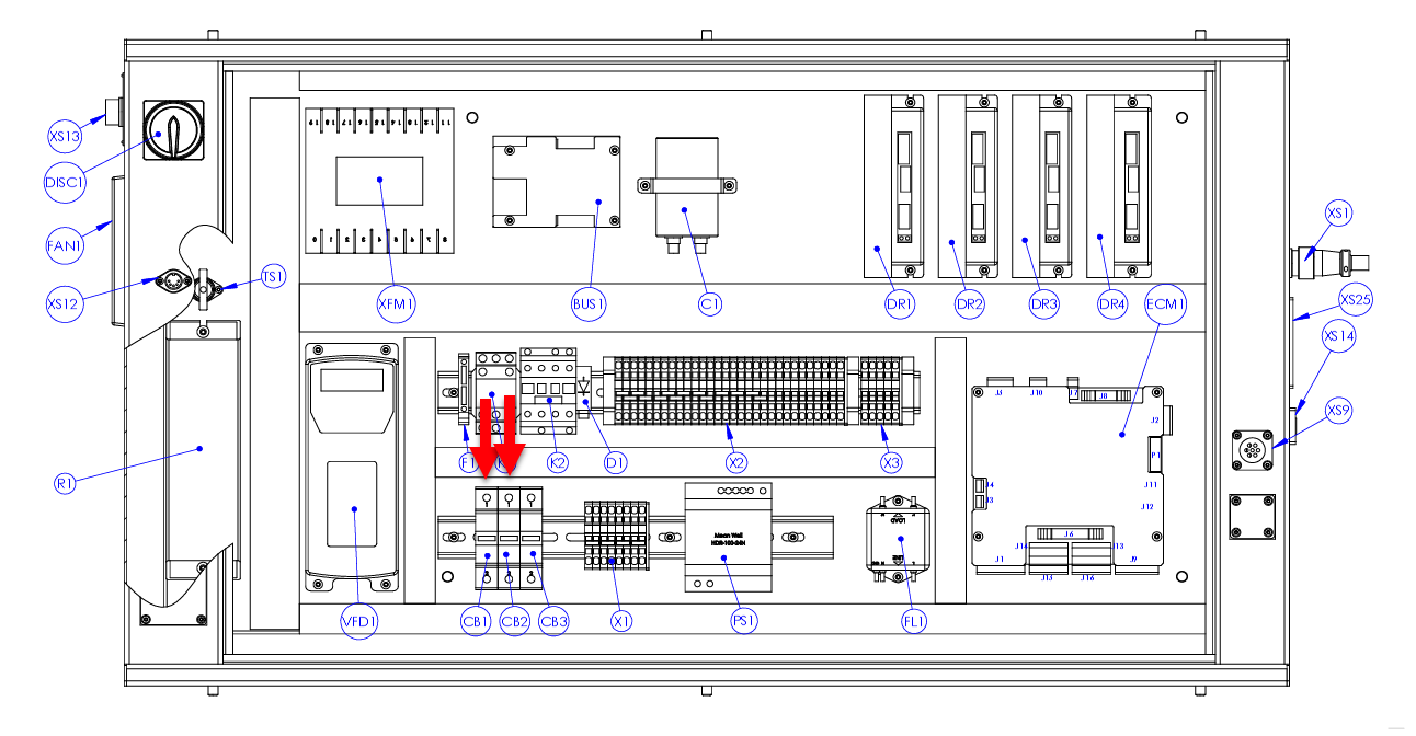

Reset the CB1 and/or CB2 Circuit Breaker
Reason: The CB1 and/or CB2 circuit breaker tripped.
  1. Measure the wires as indicated below.
  2. If required, power off the machine and reset the tripped breaker.
Machine
Wires (CB1 and CB2)
Measure for…
24R
105 and 104
and
111 and 108
115 Vac nominal

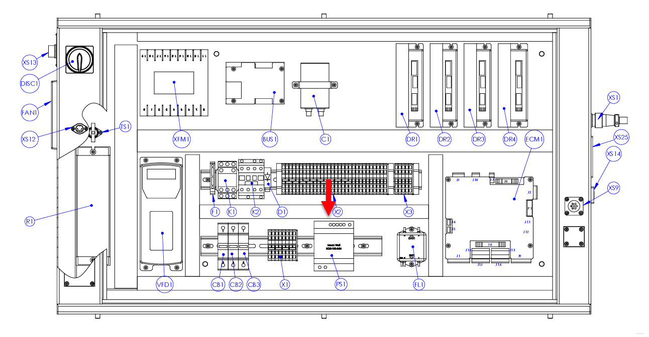

Inspect the DC Power Supply (PS1)
Reason: The DC power supply PS1 is defective.
  1. With a multimeter measure the Vdc between 401 and 402
  2. If the digital multimeter reads below 22 Vdc, with a multimeter measure between 115/N and 118 for the input Vac.
    If the input Vac is correct, replace the DC power supply.

24R PS1 Location
