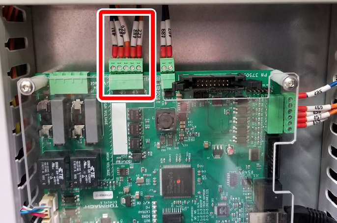

  2. In the electrical cabinet, on the top of the machine control board, identify the J10 connector.
Figure 1: Machine control board.
  1. Unplug the connector from the board. Remove wire 487 and wire 488 from the connector with a small, flat-blade screwdriver.

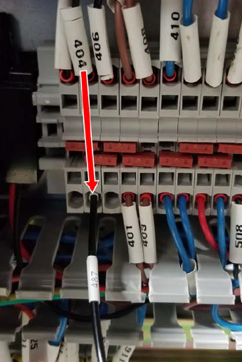

  3. Disconnect wire 488 from the terminal block with a small, flat-blade screwdriver. Discard the wire.
  4. Connect the loose end of wire 487 to the +24 Vdc by inserting it into the open port of the terminal block connected to wire 404.
Figure 2: Wire 487 connected to the open port of wire 404.

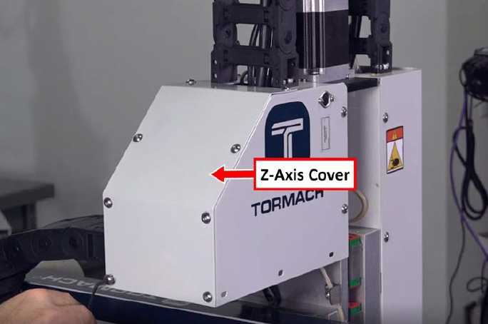

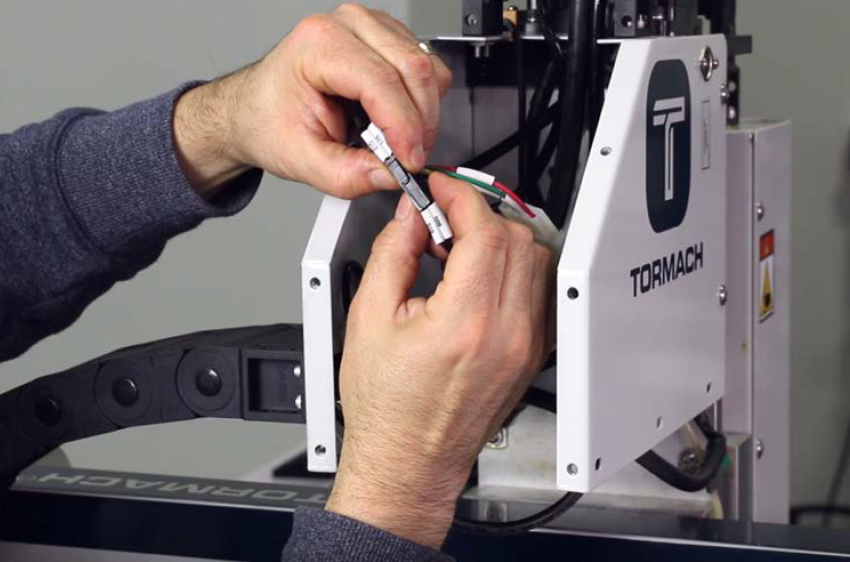

  3. From the back of the gantry, remove the screws securing the lid to the rear of the Z-axis cover with a 3 mm hex wrench. Set the cover and screws aside.
Figure 3: Z-axis cover.
  1. Remove the five M5 screws on the cable tray cover on the back of the gantry and the five M5 screws from the cable tray cover on the side of the gantry with a 3 mm hex wrench. Set the screws and covers aside.
  2. Find the 24R Z-Axis Brake Cable Assembly (PN 51138) provided in this kit.
  3. Wrap the ends of the cable together with electrical tape.

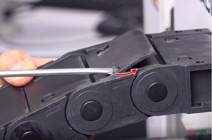

  4. To route the cable through the X-axis energy chain, you must remove every other energy chain cover. Put small, flat-blade screwdriver into the left rectangle opening and pry up. Then, pry up on the right rectangle opening. Lift the cover and set it aside.
Figure 4: Removing a cover on the X-axis energy chain.
  1. Repeat Step 7 for every other energy chain cover. The top and bottom energy chain covers are different sizes, so keep them separate for re-installation.
  2. Begin routing the brake cable through the X-axis energy chain and then down the side of the gantry.
  3. Replace the energy chain covers that you set side earlier by sliding them back into place and snapping both the top and the bottom to secure them.

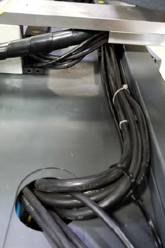

  4. Route the cable down the side of the gantry, through the cable tray on the bottom of the gantry, and then into the Y-axis energy chain closest to the electrical cabinet.
  5. Remove any necessary energy chain covers on the Y-axis energy chain with a short, small, flat-blade screwdriver. Set aside the covers.
  6. Route the cable through the Y-axis energy chain and then toward the hole on the top of the electrical cabinet.
Figure 5: Cable routing through the hole on the top of the electrical cabinet.
  1. Replace any energy chain covers that you set aside earlier.
  2. Route the cable through the hole in the top left of the electrical cabinet and then through the wire troughs.

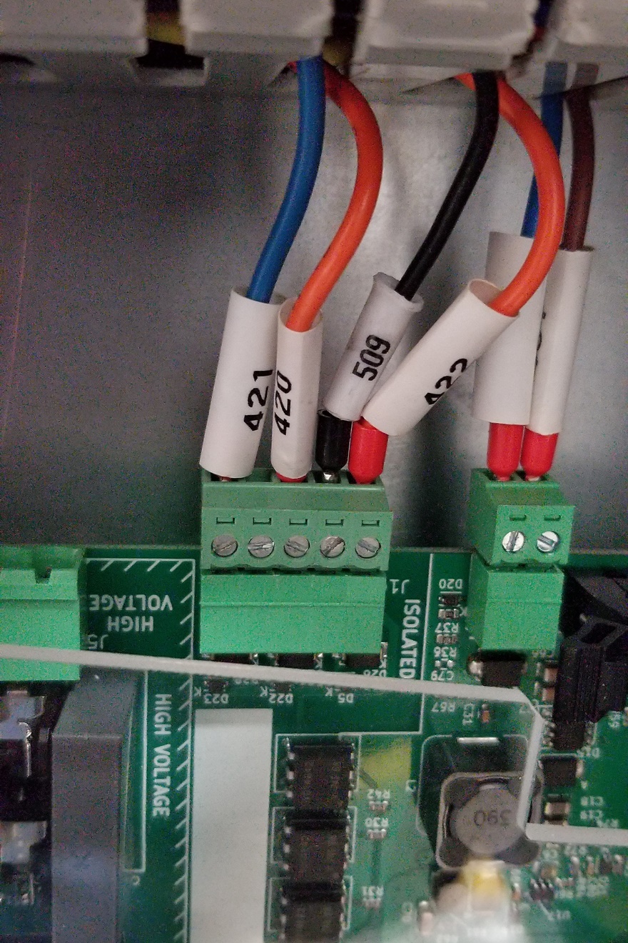

  1. Route wire 509 and wire 510 to the machine control board, and then unwrap the electrical tape.
  2. Connect wire 509 to pin 2 on the J10 connector with a small, flat-blade screwdriver.
Figure 6: Wire 509 on the J10 connector on the machine control board.

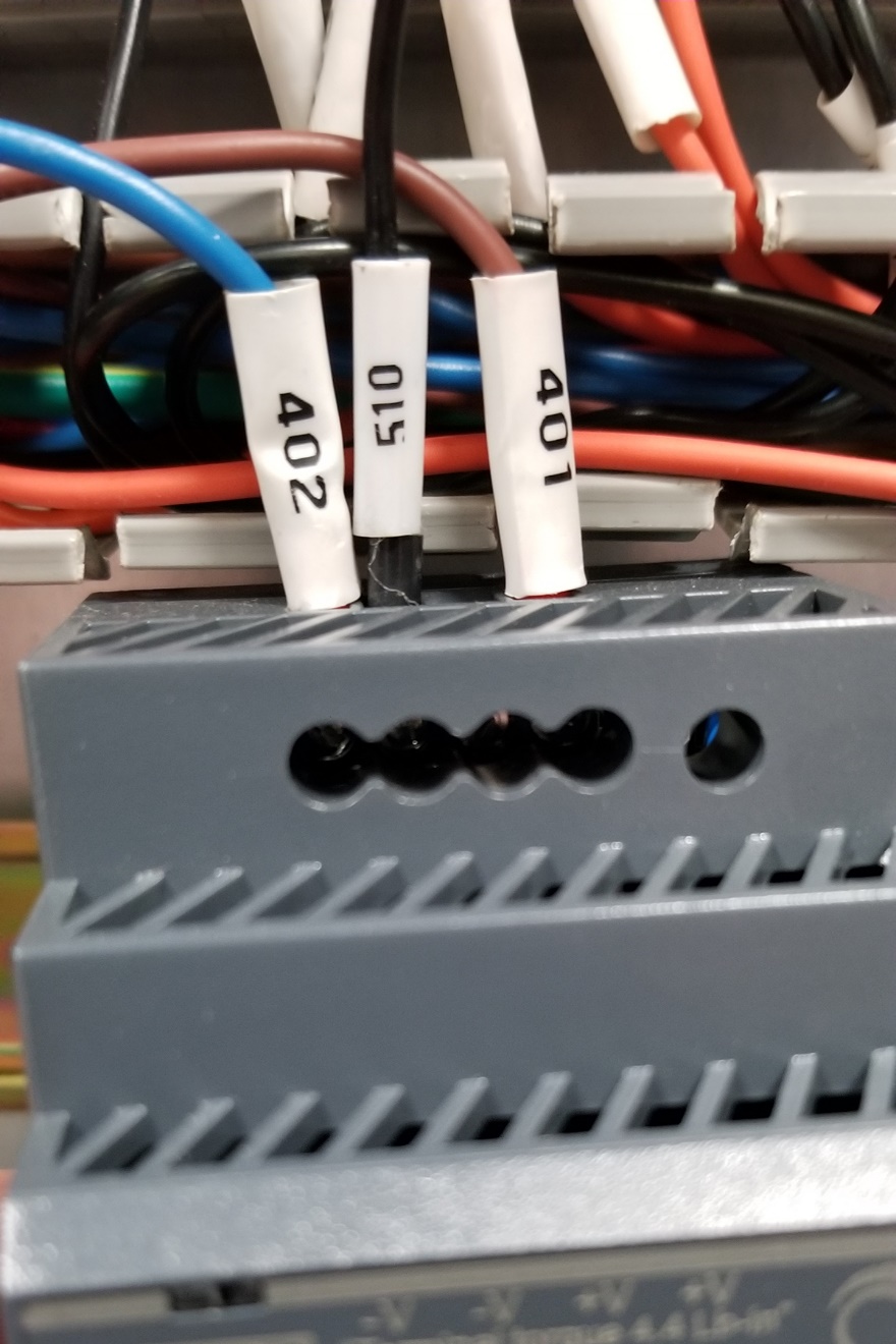

  1. Route wire 510 toward the top of the 24 Vdc power supply.
  2. Find the security pin on the bottom of the power supply, and release it with a small, flat-blade screwdriver. You can tsen lift the power supply off of the DIN rail to make the wire connections.
  3. Connect wire 510 to the empty V- terminal on the power supply with a small, flat-blade screwdriver.
Figure 7: Wire 510 on the V- terminal on the power supply.

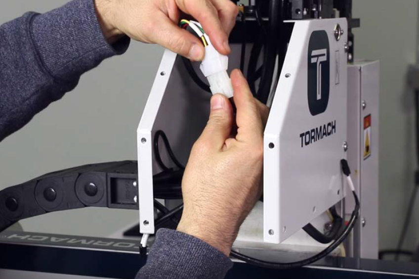

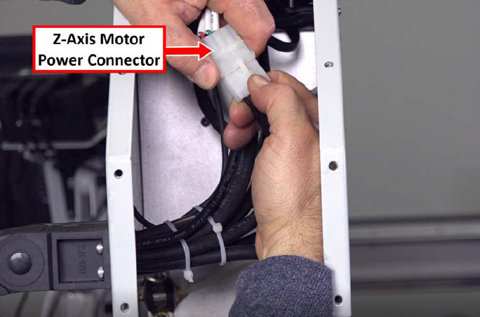

  2. Locate the Z-axis motor power connector in the rear of the Z-axis cover and disconnect it.
Figure 8: Z-axis motor power connector.

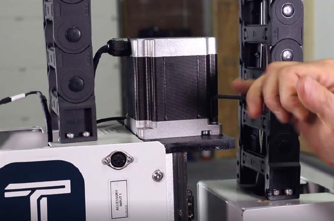

  1. From the Z-axis motor, remove the four M6 screws securing it in place with a 4 mm hex wrench. Set the screws aside.
Figure 9: Existing Z-axis motor secured to the machine.

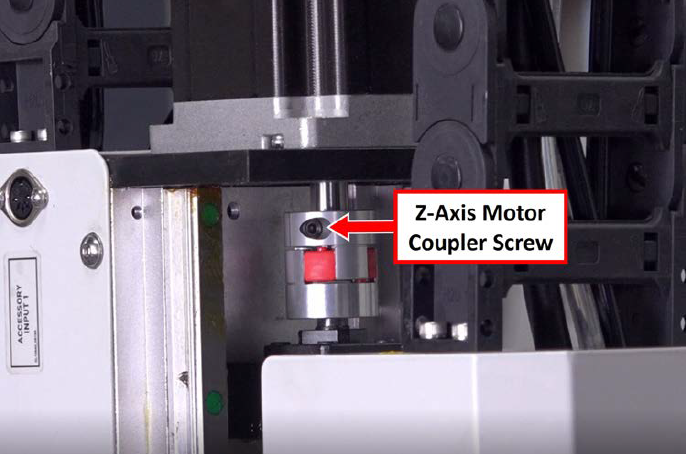

  1. Locate the Z-axis motor coupler. If you can access the screw securing the coupler to the Z-axis motor shaft, loosen it with a 4 mm hex wrench. If you can't access the screw, go to Step 6.
Figure 10: Existing Z-axis motor coupler.
  1. Put a 4 ft wood board under the spindle head. Slowly lift the board up to move the spindle head up and rotate the coupler. Put a shim under the board to keep it in place while you loosen the screw securing the coupler to the Z-axis motor shaft with a 4 mm hex wrench.
  2. Lift and remove the Z-axis motor and discard it.

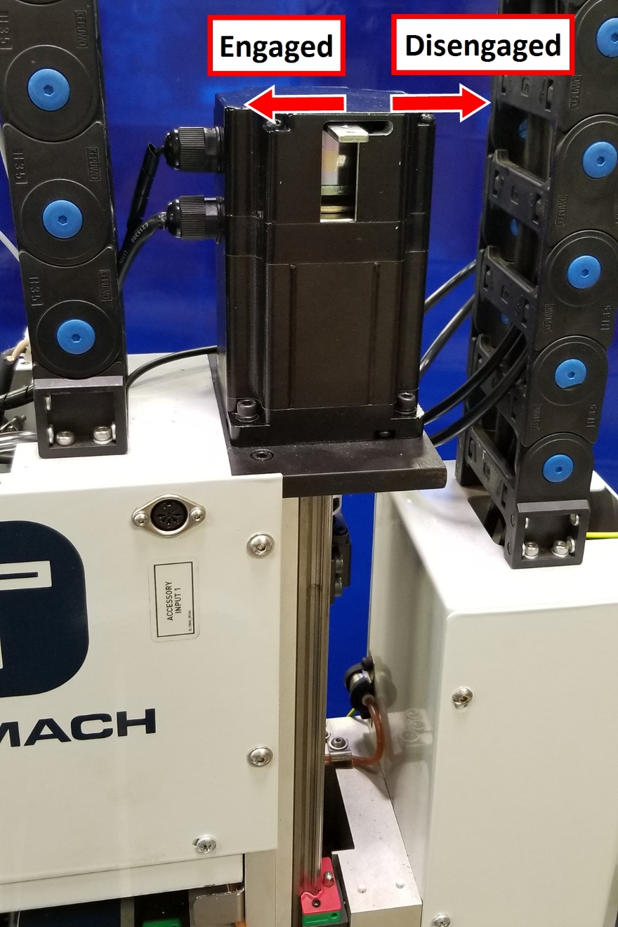

  2. Verify that the Z-axis brake's manual override lever is slid to the left (in the engaged position). If it's not, slide the lever to engage the brake.

  4. Identify the Z-axis motor power connector in the rear Z-axis cover and connect it to the motor.
Figure 12: Connecting the Z-axis motor power connector to the motor.

Problem: Spindle head falls after installing the new motor with brake when the machine is powered off.
Probability
How-To Steps
High
Power off the machine.
On the top of the Z-axis motor, push the manual break override lever to the left.
The brake switches into automatic mode, and engages the brake when the machine is powered off.

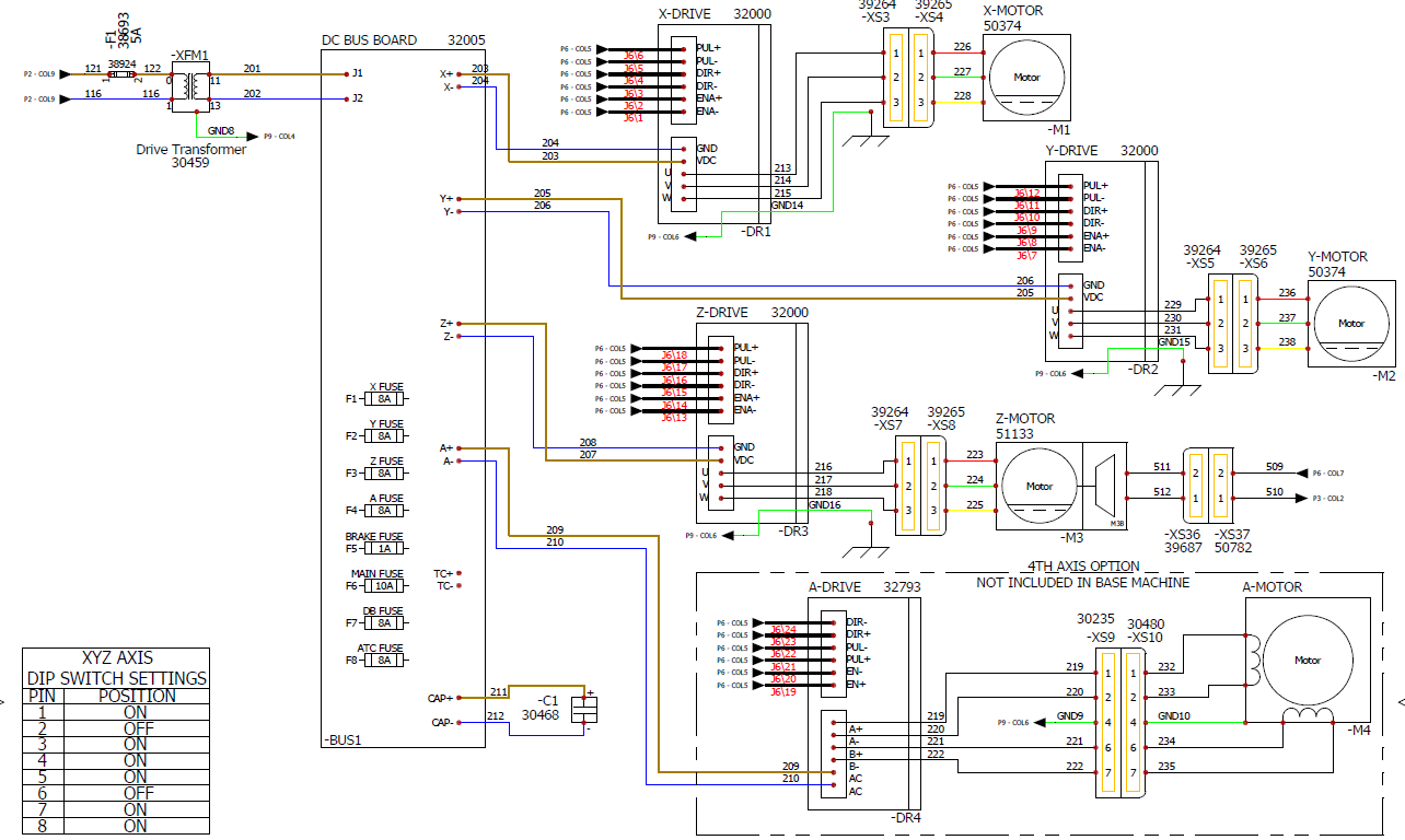

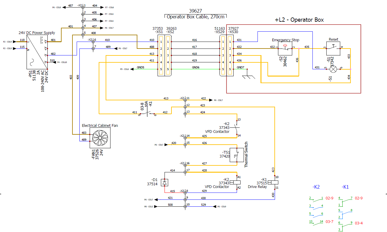

Electrical Schematics
24 Vdc Controls (Sheet 3)
Axis Drive Bus (Sheet 4)
