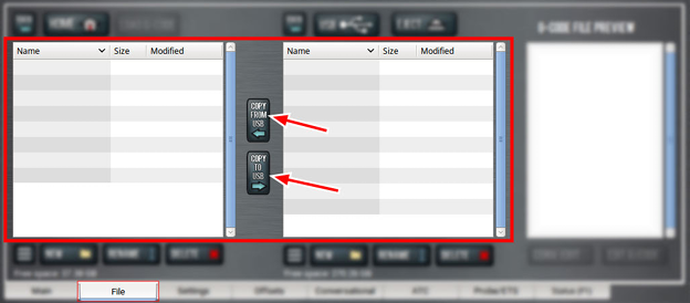

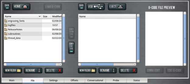

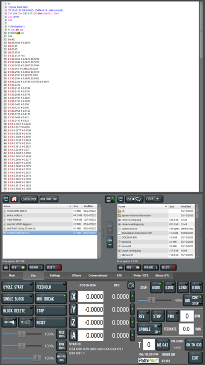

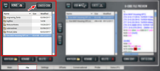

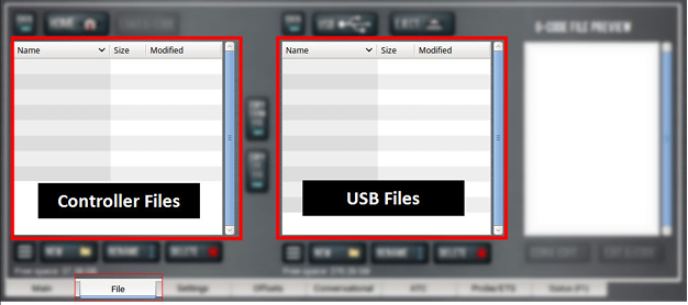

Load G-Code
To load G-code:
  2. Select Load G-Code.
Figure 1: Controller Files window on the File tab.
Figure 2: File tab.
Figure 3: File tab.
  1. If you’re using a USB drive, Select Eject.

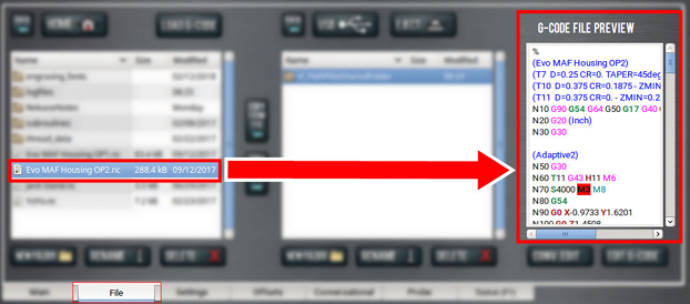

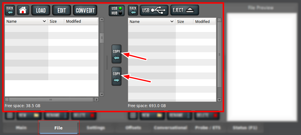

Preview G-Code Files
To preview G-code files:
Figure 4: File tab.
Access Recent G-Code Files
From the Main tab, in the G-Code tab, select the Recent Files menu.
Figure 5: Recent Files menu on the Main tab.
    The G-code program loads.

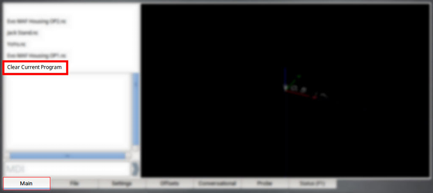

Close the Current Program
Figure 6: Recent Files menu on the Main tab.

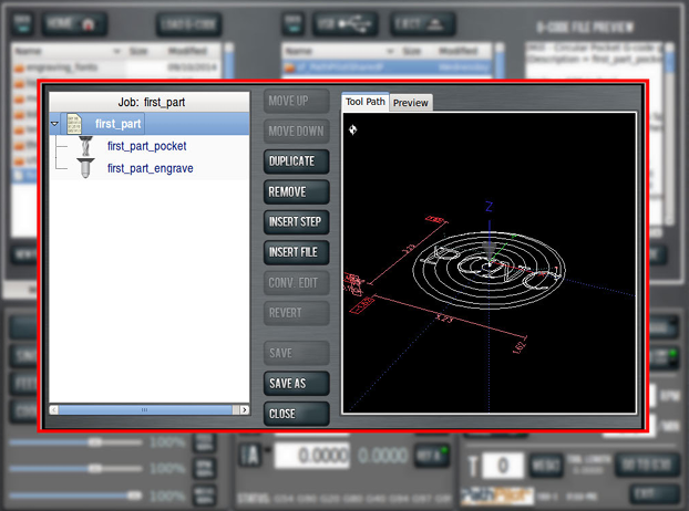

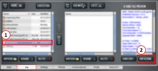

Edit G-Code
Figure 7: Edit G-code button on the File tab.
  2. Close the text editor.
  2. Select Conv. Edit.
Figure 8: Job assignment editor.
  1. Select Save.
Change the Step Order
Create a New Job Assignment
  1. Select Insert Step.
  3. Select Insert.
Load an Existing G-Code File
  3. Select Open.
Edit a Job Assignment
  1. Select the job assignment, and then select Conv. Edit.
  2. Edit the job assignment.
  3. Select Finish Editing.

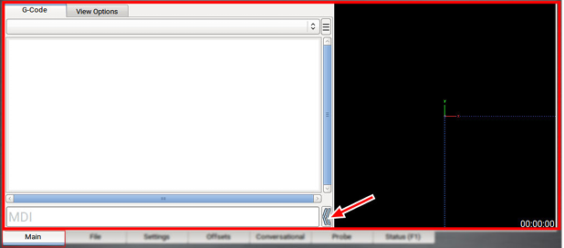

Read G-Code

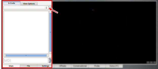

Expand the G-Code Tab
To expand the G-Code tab:
  • Select the Window Expander.
Figure 9: Window Expander on the Main tab.

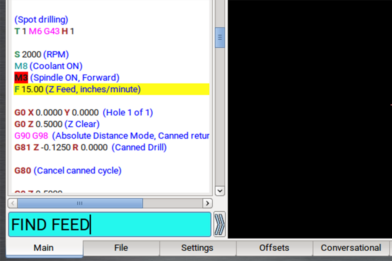

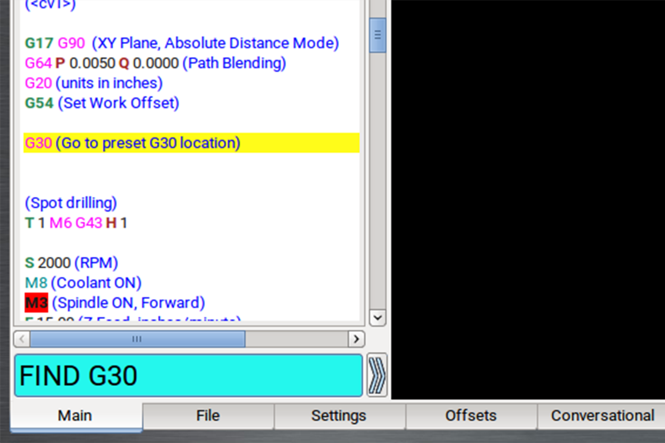

Search in the Code
To search in the code:
Figure 10: Search for a text command.
Figure 11: Search for a feed command.
  1. Select the Enter key.
  2. (Optional) Select Enter.

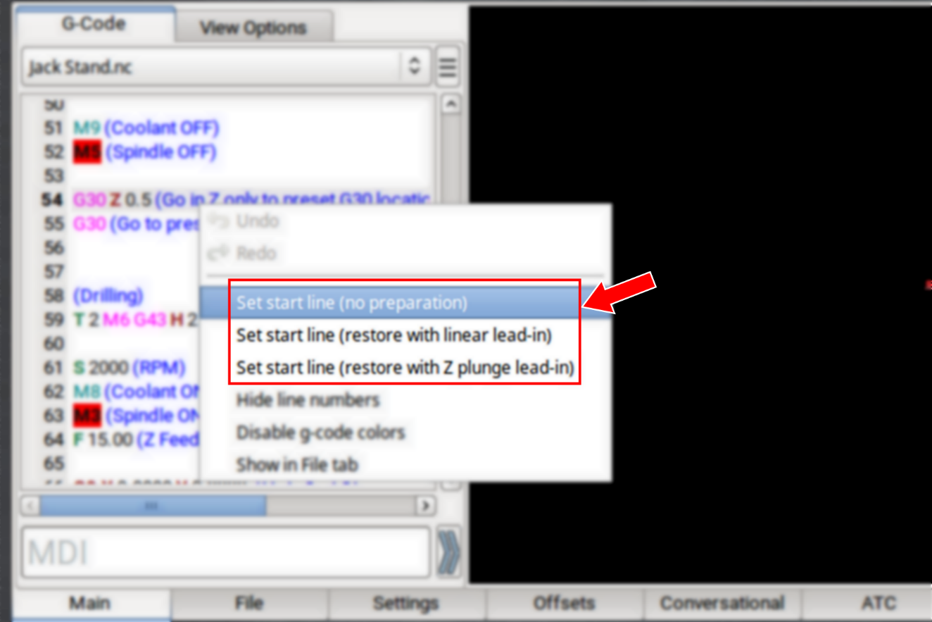

Set a New Start Line
To set a new start line:
    1. Right-click any line in the program.
Figure 12: Accessing the Options menu by right-clicking.
b. Tap the line. Then, select the Options menu.

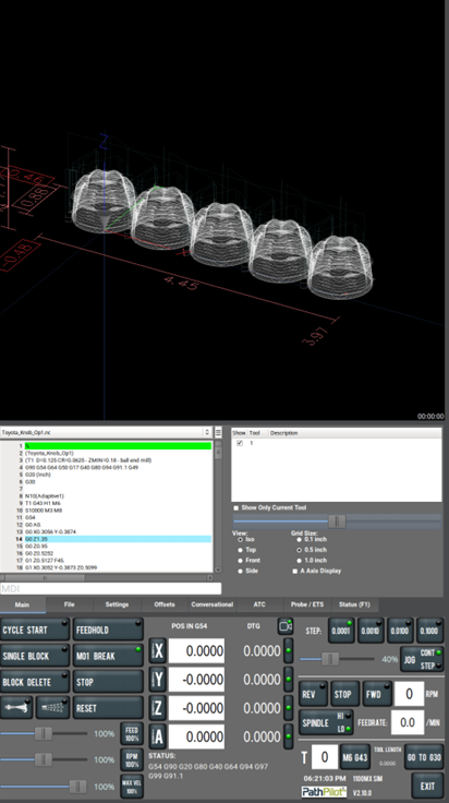

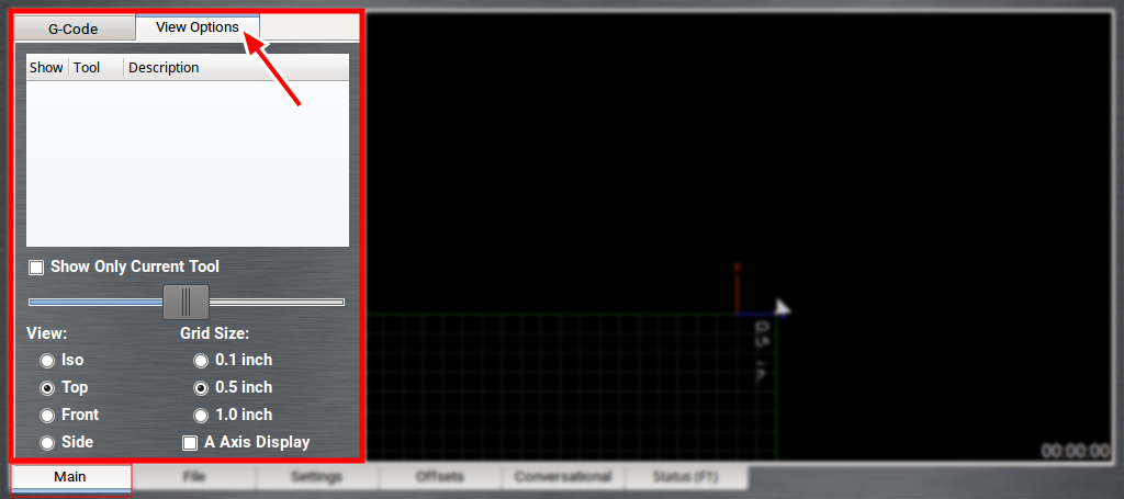

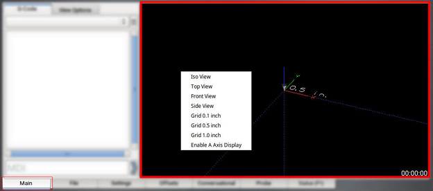

Figure 13: Tool Path display on the Main tab.
Figure 14: View Options tab on the Main tab.
  1. Select a new view.
About the Tool Path Display
  • Front
  • Iso
  • Side
  • Top
  • G20 Mode 1/2 in. intervals
  • G21 Mode 5 mm intervals
  • Select Reset.

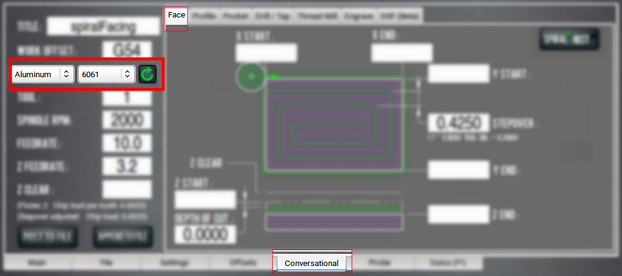

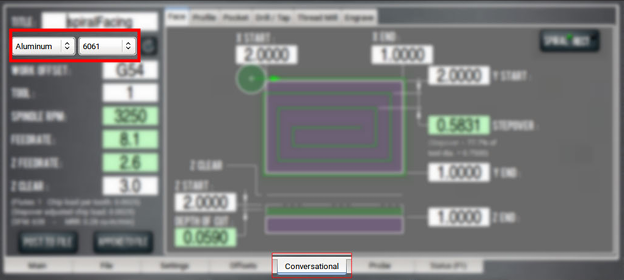

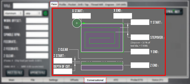

Create a Face on a Part
Using conversational programming, you can program PathPilot to take multiple cuts — each following the last — on an X/Y plane over a Z range. For information, see "About Facing".
  • The area from the rear, left corner of the workpiece to the rear, right corner of the workpiece must be clear of any obstructions from the Z Start position to the Z End position.
  • The top of the workpiece must be free of any workholding devices.
  • The value used in the Z End DRO field must be such that it is above the workholding device.
  • The value used in the Z Clear DRO field must be such that it is above any obstruction in the tool path between the end of one pass and the beginning of the next.
To create a face on a part:

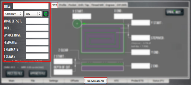

Figure 15: Conversational DROs on the Face tab.
    1. In the X Start DRO field and the X End DRO field, type the location of the workpiece edges. We recommend using the rear left corner of the part for the X Start value.
    2. In the Y Start DRO field and the Y End DRO field, type the location of the workpiece edges. We recommend using the front right corner of the part for the Y End value.
    3. In the Stepover DRO field, type the required distance between tool paths. To prevent uncut areas in the spiral corners, we recommend limiting this value to 80% of the tool diameter. For information, see "Facing Reference".
    4. In the Z Start DRO field and the Z End DRO field, type the location of the first and last Z passes. For a single Z pass at the location typed in the Z End DRO field, type a value of 0 or a full Z range value into the Depth of Cut DRO field.
    5. In the Depth of Cut DRO field, type the desired amount of material to remove.
NOTE: The depth of cut is later adjusted within the Z range so that each pass in the Z range has the same depth (rather than the last Z pass having a short depth of cut).
Figure 16: Program-specific DROs on the Face tab.

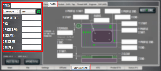

Create a Profile on a Part
Using conversational programming, you can program PathPilot to take multiple cuts — each following the last — on an X/Y plane over a Z range to form a boss. For information, see "About Profiling".
  • The value used in the Radius DRO field must be between 0 and either:
    • One half of the boss' narrow width, or
    • The full radii on the long ends of the boss
  • The value used in the Z Clear DRO field must be set to clear any obstructions between path changes.
To create a profile on a part:
  2. From the Conversational DROs group, set the parameters for the profiling operation.
Figure 17: Conversational DROs on the Profile tab.
    3. In the X Profile Start DRO field, the X Profile End DRO field, the Y Profile Start DRO field, and the Y Profile End DRO field, type the location of the profile's outer edges.
    4. In the Stepover DRO field, type the required distance between tool paths. If you want a single cut in the workpiece (to create a slot), type 0.
    5. In the Radius DRO field, type the required radius for the corners of the profile. For no corner radius, type 0.
    6. In the Z Start DRO field and the Z End DRO field, type the location for the first and last Z passes. For a single Z pass at Z End, type 0 — or a full Z range value — in the Z DOC DRO field.
    7. In the Z DOC DRO field, type the desired amount of material to remove.
Figure 18: Program-specific DROs on the Profile tab.

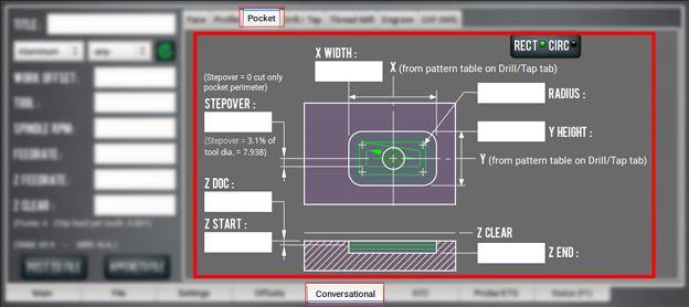

Create a Pocket on a Part
Using conversational programming, you can program PathPilot to take multiple cuts — each following the last — on an X/Y plane over a Z range to form a circular or rectangular pocket. For information, see "About Pockets".
    • One half of the pocket's narrow width, or
    • The full radii on the long ends of the pocket

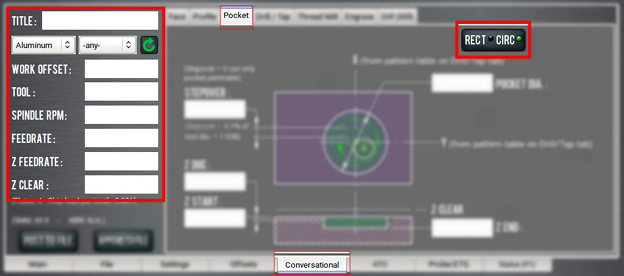

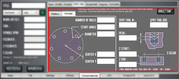

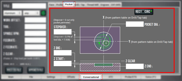

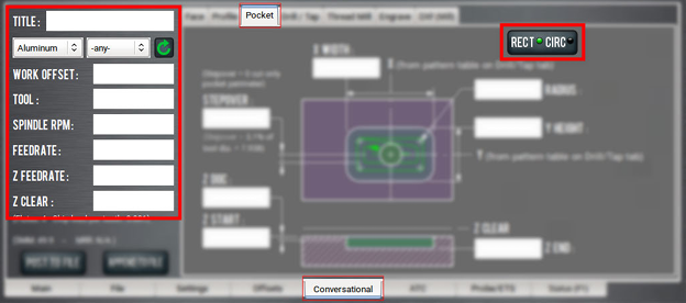

To create a circular pocket on a part:
  1. From the Conversational tab, select the Pocket tab.
  2. From the Conversational DROs group, set the parameters for the pocket operation.
Figure 19: Pocket tab.
    1. In the X Center DRO field and the Y Center DRO field, type the location of the pocket's center.
    2. In the Pocket Dia. DRO field, type the required diameter for the pocket.
NOTE: The radius of the tool is used to set the tool path diameter.
c. In the Stepover DRO field, type the required distance between each rotation of the spiral cut. For a single cut around the inside perimeter of the pocket (to create a slot), type 0.
d. In the Z Start DRO field and the Z End DRO field, type the location of the first and last Z passes. For a single Z pass at the location typed in the Z End DRO field, type a value of 0 or a full Z range value into the Depth of Cut DRO field.
e. In the Z DOC DRO field, type the desired amount of material to remove.
Figure 20: Pocket tab.
To create a rectangular pocket on a part:
Figure 21: Pocket tab.
    1. In the X Start DRO field, the X End DRO field, the Y Start DRO field, and the Y End DRO field, type the location of the pocket edges.
    2. In the Radius DRO field, type the required radius for the corners of the pocket. For no corner radius, type 0.
    3. In the Stepover DRO field, type the required distance between adjacent tool paths. For a single cut around the inside perimeter of the pocket (to create a slot), type 0.
    5. In the Z DOC DRO field, type the desired amount of material to remove.
Figure 22: Pocket tab.
About Pockets
A pocket program is usually used to remove a large amount of material from a part.
Creating Pockets in PathPilot
For more information about creating a pocket on a part using conversational programming, see of the following sections, depending on the shape of the pocket:
For information on using conversational programming in PathPilot to make a pocket on a part, see "Create a Pocket on a Part".
About Circular Pockets
PathPilot does one of the following, depending on the diameter of the tool:
  • Tool Diameter Larger Than Pocket Diameter PathPilot displays an error and does not create any G-code. You must select a different tool or edit the diameter of the pocket.
  • Tool Diameter Just Small Enough to Fit Within Pocket Diameter PathPilot does the following in the order listed:
  1. Uses a straight Z plunge into the pocket center. You must use a center-cutting end mill.
  2. Makes a single pass around the perimeter of the pocket at the adjusted Z depth of cut.
  3. Continues to make single passes around the perimeter of the pocket.
  • Pocket Diameter More Than Two Times Tool Diameter PathPilot does the following in the order listed:
  1. Uses a helical entry into the pocket center.
  2. Makes a hole that is two times the diameter of the tool diameter in the pocket center.
  3. Makes a spiral cut out from the pocket center to the pocket diameter.
  4. Makes a cut around the perimeter of the pocket.
About Rectangular Pockets
  • Tool Diameter Larger Than Pocket Width PathPilot displays an error and does not create any G-code. You must select a different tool or edit the width of the pocket.
  • Tool Diameter Just Small Enough to Fit Within Pocket Parameters PathPilot does the following in the order listed:
  • Length of Pocket More Than Two Times Diameter of Tool PathPilot uses a linear ramp entry.

To make a specific hole pattern of evenly spaced holes around a circumference (also know as a bolt pattern):
  1. From the Conversational tab, select the Drill tab.
Figure 23: Drill/Tap tab on the Conversational tab.
  1. From the Drill tab, select the Circular tab.
  2. In the Number of Holes DRO field, type the number of holes (greater than 0) required for the pattern.
  3. In the Start Angle DRO field, type the value of the angle from angle 0 (from -90 to 90).
  4. In the Diameter DRO field, type the size of the circular pattern (as defined by a line through the center point of each hole).
  5. In the Center X DRO field and the Center Y DRO field, type the location for the center of the hole.
  6. Go to "Create a Drilling Sequence".

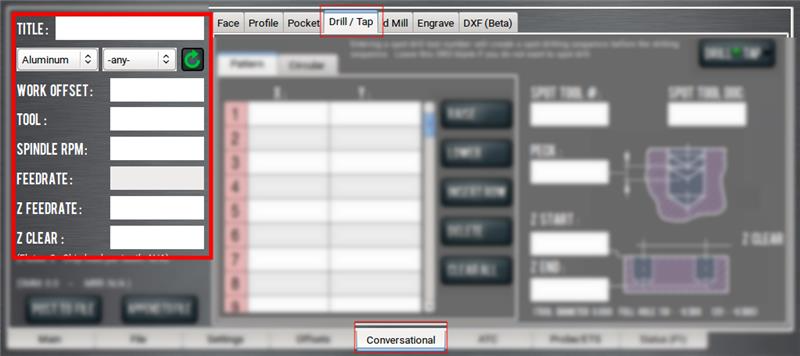

Use the Location table to make a list of X and Y locations for each hole using the same tool, the same Z location, and the same values in the Conversational DROs group.
NOTE: You can create holes using different tools or different parameters. You must first post the first group of hole locations, enter the second group of hole locations, and then append the second group to the existing posted file.
To make a hole pattern based on X and Y locations on a part:
Figure 24: Drill/Tap on the Conversational tab.
  1. From the Drill tab, select the Pattern tab.
  2. In the Location table, select the row, then select the cell to edit.
  3. Holes indicated in the Location table are completed from top to bottom.
Tips
  • To rearrange the row order, select a row, and then select Raise or Lower.
  • To clear all values in the table, select Clear All.
  • To make sure that the value is a valid number, leave the cell. If the value isn't a valid number, it's erased, and an error displays on the Status tab.

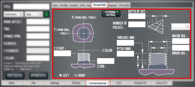

Create Threads on a Part
Using conversational programming, you can program PathPilot to take helical tool paths around a boss or inside a hole to create external or internal threads. For information, see "About Thread Milling".
  • The auto-filled DRO field values assume a full-form threaded tool. If you're using a fine-point threaded tool to cut coarse threads, you must modify the root diameter to account for the tool's smaller nose radius.
  • The value used in the Z Clear DRO field must be such that it can clear any blockages in the path between the end of one Z pass and the beginning of the next.
To create threads on a part:

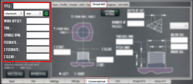

  1. From the Conversational tab, select the Thread Mill tab.
  2. From the Conversational DROs group, set the parameters for the thread milling operation.
Figure 25: Conversational DROs on the Thread Mill tab.
Depending on the type of threads, do one of the following:
  • For external threading (creating threads on a boss, for example), select External.
  • For internal threading (creating threads inside a hole, for example), select Internal.
    1. From the Quick Reference drop-down, select the thread size.
      The Threads/In DRO field, Pitch (In) DRO field, Major Dia. DRO field, and Minor Dia. DRO field auto-fill.
NOTE: The threads listed follow the current unit setting: either inches (G20) or millimeters (G21).
b. In the Z Start DRO field, type the location of the first Z pass (where you want the thread to start).
c. In the Z End DRO field, type the location of the last Z pass (where you want the thread to end).
NOTE: The tool actually goes beyond the value entered in the Z End DRO field, due to the cutting tip width and the Z component of the compound feed angle and thread depth.
d. In the Depth of Cut DRO field or the Number of Passes DRO field, type a value to represent the amount of material to remove in each helical pass. For information, see "Thread Milling Reference".
NOTE: The Depth of Cut DRO field and the Number of Passes DRO field are linked — after you type a value in one and press Enter on the keyboard, the other is auto-filled.
Figure 26: Program-specific DROs on the Thread Mill tab.
Thread milling is used to make helical tool paths on a part — either externally, like on a boss, or internally, like in a hole. The right-handed threads are based on pitch, diameter, and length.
Thread Milling in PathPilot
For information on using conversational programming in PathPilot to do thread milling, see "Create Threads on a Part".
PathPilot uses the following terms when creating a thread mill on a part using conversational programming:
  • Major Dia. and Minor Dia. Set the start and end diameter of the thread peak and valley.
  • Depth of Cut Sets the amount of material cut in each helical pass — the value is the distance (the change in radius) the tool is fed on the first pass. This first pass cuts a triangular area which is related to the chip load. Subsequent cut depths are set to cut the same amount of area, so the linear feed gets smaller for each pass. The tool is also fed in on a compound angle of 30 degrees, keeping the cuts to one face of the tool.

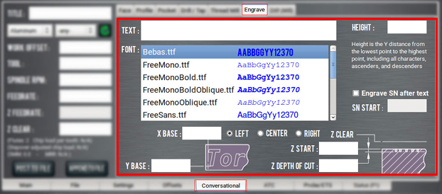

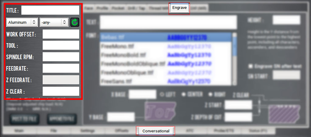

Create Text to Engrave on a Part
Using conversational programming, you can program PathPilot to engrave a single line of text on a part. For example, you could use this feature to engrave True Type stick or outline fonts into things like simple plaques, control panels, or data plates. For information, see "About Engraving" (page 27).
To create an engraving sequence on a part:
  1. From the Conversational tab, select the Engrave tab.
  2. From the Conversational DROs group, set the parameters for the engraving operation.
Figure 27: Conversational DROs on the Engrave tab.
    1. In the Text DRO field, type the desired text to engrave.
      The text appears in the Preview window.
b. From the Font list, select the desired font for the engraved text.
NOTE: To search the Font list, select a font and begin typing the font's name. PathPilot scrolls to the result.
The Preview window updates to display the font selected.
NOTE: You can add True Type font files to the PathPilot controller. For information, see "Transfer Files to and From the Controller".
c. Use the Alignment radio buttons to select the desired alignment of the text: either Left, Center, or Right.
d. In the Height DRO field, type the distance in the Y direction from the top of the text to the bottom of the text.
PathPilot uses the height value, along with font data, to calculate scale for character paths in the G-code program.
NOTE: The value typed in the Height DRO field includes ascenders and descenders, but no the tool cutting diameter. For a more accurate value, subtract the diameter from the overall height.
e. In the X Base DRO field and the Y Base DRO field, type the location of the left side of the first character’s baseline.
NOTE: If any characters in the text have descenders, like y or g, they extend below the baseline.
f. In the Z Start DRO field, type the location of the surface on which to engrave.
g. In the Z Depth of Cut DRO field, type the desired depth the that the cutting tool is fed into the workpiece.
h. In the Z Clear DRO field, type the value for the tool to move or retract to — in the Z direction — at the start and end of the engraving sequence and between characters.
Figure 28: Program DROs on the Engrave tab.
About Engraving
Engraving is used to engrave a single line of text cut in a single horizontal pass along the X-axis of a part.

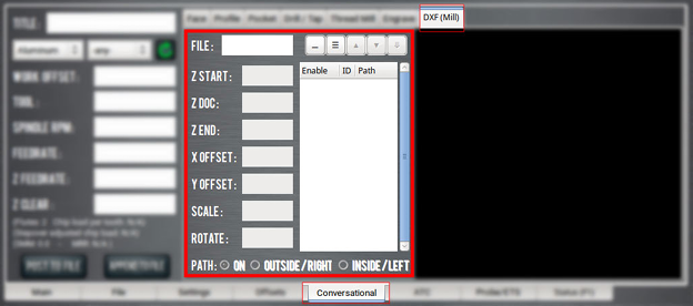

Import a DXF File
Figure 29: DXF tab on the Conversational tab.
  1. Select the File DRO field.
Example
Adjust the Tree View Window
  • Use the Fold and Unfold buttons to collapse and expand the layer and shape tree in the tree view window.
Working in the Preview Window
  • Cyan Selected paths
  • Gray Disabled paths
  • White Drawing path
  • Magenta Cut path
    • Red X-axis
    • Green Y-axis
    • Blue Z-axis

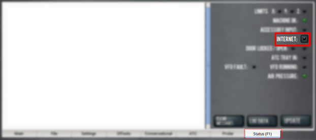

Enable an Internet Connection
If desired, you can enable an internet connection on your PathPilot controller. An internet connection allows you to receive automatic PathPilot updates and transfer files with PathPilot Hub instead of a USB drive.
Figure 30: Internet button on the Settings tab.
Figure 31: Network Configuration dialog box.
  1. Once connected, you can use the PathPilot Hub and automatic updates features.

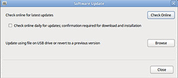

Enable Automatic Updates
To enable automatic updates:
Figure 32: Software Update dialog box.
  2. Select Close.

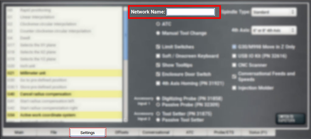

Change the Network Name
To change the network name:
Figure 33: Network Name field on the Settings tab.

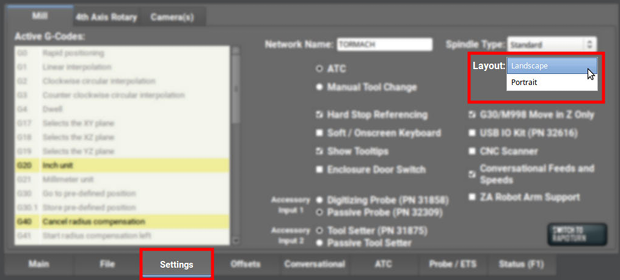

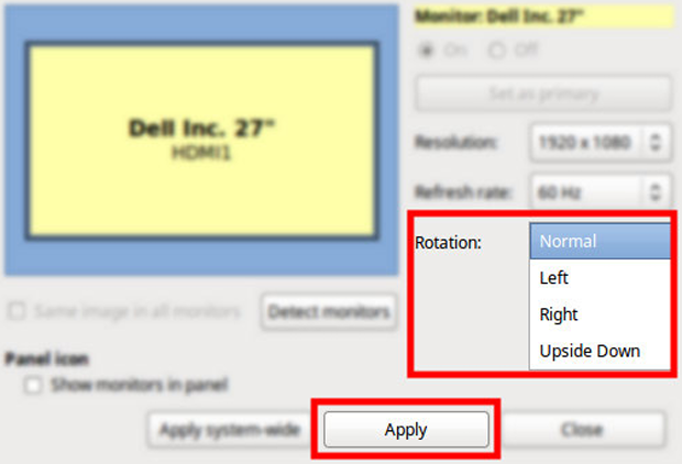

Change the Screen Orientation
Figure 34: Layout drop-down menu on the Settings tab.
Figure 35: Monitor configuration dialog box.
About Portrait Screen Layout
Figure 36: Tool Path window in portrait screen layout.
Figure 37: File tab G-code preview in portrait screen layout.

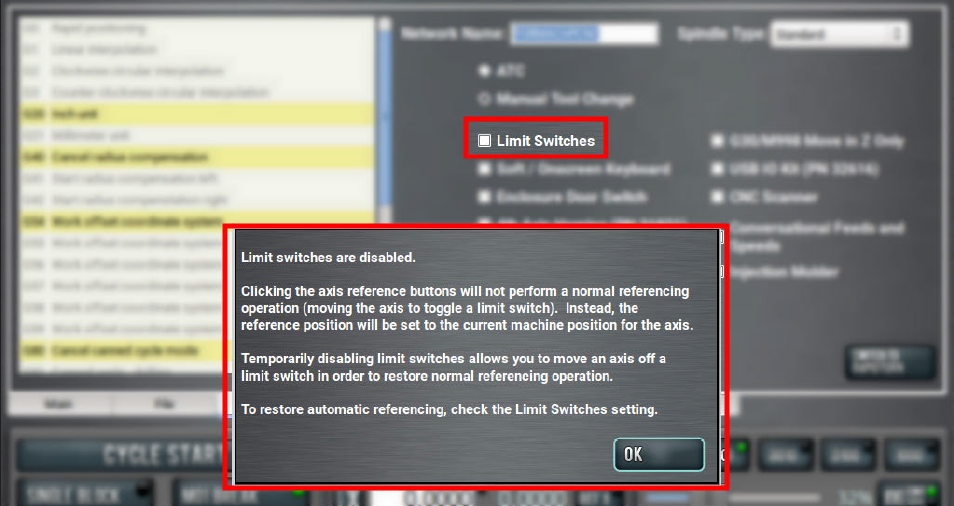

Disable Limit Switches
To provide a temporary workaround for a malfunctioning limit switch circuit, you can disable the limit switches. For information, see “About Limit Switches”.
NOTE: By default, the Limit Switches checkbox is selected.
To disable limit switches:
  1. From the Settings tab, clear the Limit Switches checkbox.
Figure 38: Limit Switches checkbox on the Status tab.
  1. Select OK.
In the PathPilot interface, on the Settings tab, the Limit Switches checkbox is selected by default. If the checkbox is cleared, the machine completes a unique referencing procedure after selecting Ref X, Ref Y, Ref Z, and Ref A: rather than moving each axis to the end of its travel, the reference position is set as the machine's current position. This is useful for troubleshooting: if the limit switches are disabled, you're able to move the axis off of its limit switch.

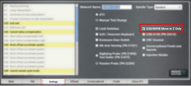

Limit G30 Moves
To limit G30 moves:
Figure 39: Settings tab.
About G30

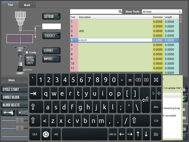

Enable the On-Screen Keyboard

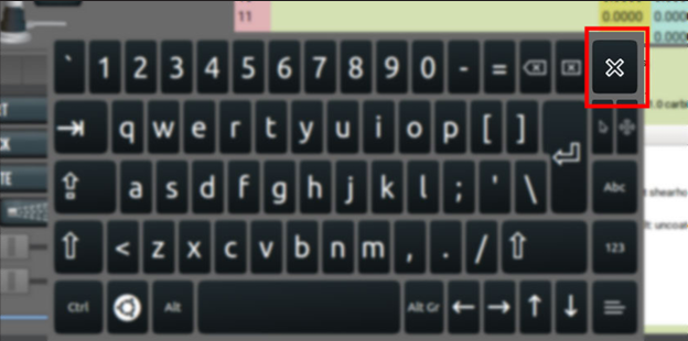

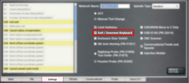

If you have an (optional) Touch Screen Kit (PN 35575), you can use a soft keyboard to type information in the PathPilot interface. For information, see "About Soft Keyboards" (page 36).
Figure 40: Settings tab.
Figure 41: Soft Keyboard
Figure 42: Soft Keyboard
Figure 43: Soft (on-screen) keyboard.
Figure 44: Settings tab.

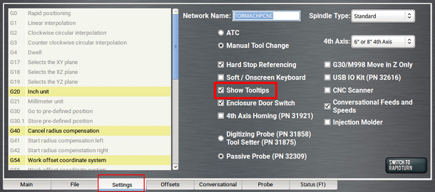

Enable Tooltips
  • From the Settings tab, select or clear Show Tooltips.
Figure 45: Show Tooltips checkbox.
Figure 46: Settings tab.

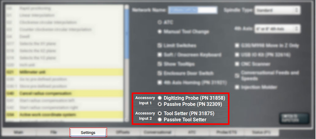

Specify Probing and Tool Measuring Options
If you have any of the following accessories, you must first specify which you're using in the PathPilot interface:
To specify a probe or a tool setter:
  • From the Settings tab, select the correct probing or tool measuring options for both Accessory Input 1 and Accessory Input 2.
Figure 47: Settings tab.

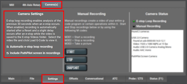

Use a USB Camera
Figure 48: USB Camera status.
About USB Cameras

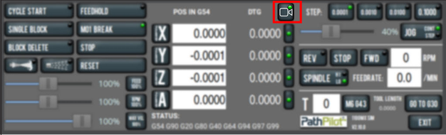

Manual Recording
Figure 49: Manual recording controls.
Figure 50: Video Camera Recording button.
Figure 51: Camera settings.
    The Main tab displays.
Figure 52: Example of taking a photo.
To view E-stop videos:

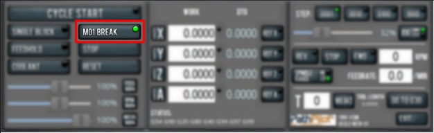

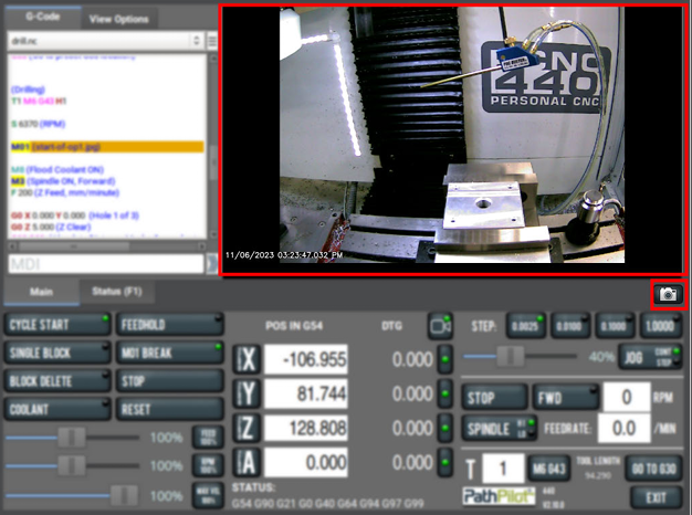

Use M01 to Take Pictures
To use M01 to take pictures:
  2. Run the G-code program.

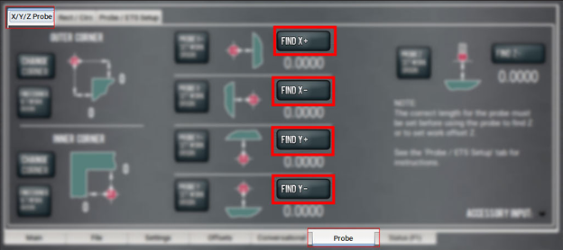

Use a Probe to Find a Feature's Location

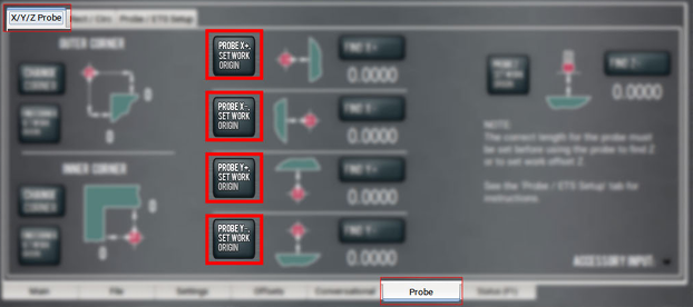

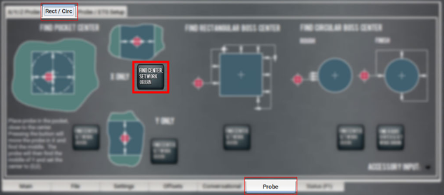

To find the location of a workpiece or vise in the current work offset coordinates:
  1. From the PathPilot interface, on the Probe tab, select the X/Y/Z Probe tab.
  2. Position the probe near the workpiece or vise.
  3. One at a time, select Find X+, Find X-, Find Y+, Find Y-, or Find Z-.
Figure 53: Probe tab.
The axis is probed, and the location of the probed surface is displayed.
Use a Probe to Set Work Offset Zeroes
You can set the work offsets of a workpiece or vise jaw using a probe.

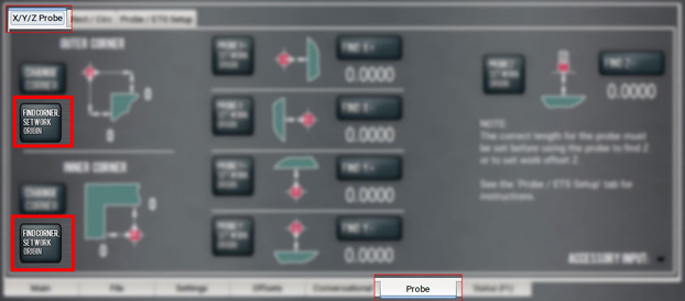

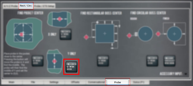

Set the X and Y Work Offset Zero on the Corner of a Feature
  2. Position the probe so that it is below the surface of the feature and 1 in. away from the vice jaw corner in the X and Y directions.
  3. Select Find Corner, Set Work Origin.
Figure 54: Probe tab.
The axes are probed, and the location of the probed surface is set as the current work offset's X/Y origin.
NOTE: Select Change Corner to change the corner on which to probe.
Set the Work Offset Zeroes on a Feature
  3. One at a time, select Probe X+, Set Work Origin, Probe X-, Set Work Origin, Probe Y+, Set Work Origin, Probe Y-, Set Work Origin, or Probe Z-, Set Work Origin.
Figure 55: Probe tab.
The axis is probed, and the location of the probed surface is set as the current work offset's origin.
Use a Probe to Find the Center of a Feature
You can find the center of a pocket, slot, or boss on a part using a probe.
Find the Center of a Pocket
  1. From the PathPilot interface, on the Probe tab, select the Rect/Circ tab.
  2. Position the probe near the center of the pocket.
  3. Select Find Center, Set Work Origin as shown in the following image.
Figure 56: Probe tab.
Find the Center of a Slot
  2. Position the probe near the center of the slot.
  3. Depending on the slot, do one of the following:
  • To probe the slot in the X direction only, select Find Center, Set Work Origin as shown in the following image.
Figure 57: Probe tab.
  • To probe the slot in the Y direction only, select Find Center, Set Work Origin as shown in the following image.
Figure 58: Probe tab.

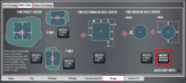

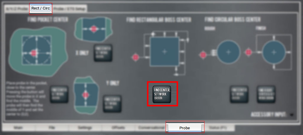

Find the Center of a Rectangular Boss
  2. Position the probe below the top surface of the boss and on the left-hand side.
Figure 59: Probe tab.
The probe moves around the edge of the workpiece to find the center.
Find the Center of a Circular Boss
Figure 60: Probe tab.
The probe moves around the workpiece three times to determine the approximate center of the curve, and then makes four additional move to confirm the center of the circle.
Find the Center Rotation of an A-Axis
  2. Position the probe directly above the A-axis center of rotation.
  3. Select Find A Axis Center & Set Work Origin.
Figure 61: Probe tab.
The probe moves around the round workpiece mounted in the A-axis to find the center rotation of the A-axis.

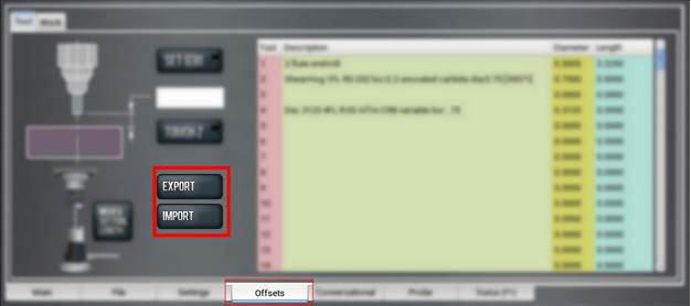

NOTE: You can import a .csv file with tool length offset data. For information, see "Import and Export the Tool Table".
To set tool length offsets:
Figure 62: Tool Table window on the Offsets tab.

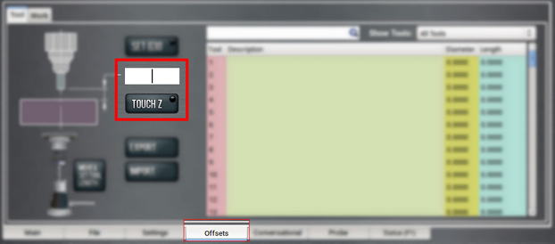

Figure 65: Touch Z DRO field and button.
  1. Select Touch Z.
  4. Jog the Z-axis up (+Z).

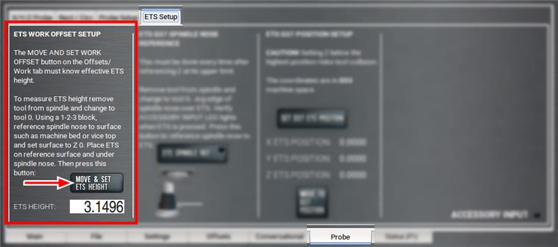

Set up the Electronic Tool Setter (ETS)
Set the ETS Height
To set the ETS height:
    For information, see “Set a Known Reference Height”.
Figure 67: Move & Set ETS Height button on the Probe tab.

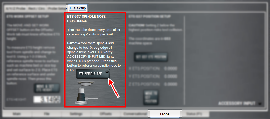

Reference the Spindle Nose
Tip! We recommend putting the ETS toward the Y+ end of travel (where it's outside of the 2 ft × 4 ft standard work envelope, and on the surface of the vacuum table). For information, see ETS Placement Layout.
  1. Remove the tool holder from the spindle.
  3. Jog the spindle until it's over the ETS. Then, slowly jog the Z-axis down (-Z) toward the contact pad on the ETS.
  4. From the PathPilot interface, on the ETS Setup tab, find the ETS G37 Spindle Nose Reference section, and select ETS Spindle Ref.
 Figure 68: ETS Spindle Ref button on the Probe tab.

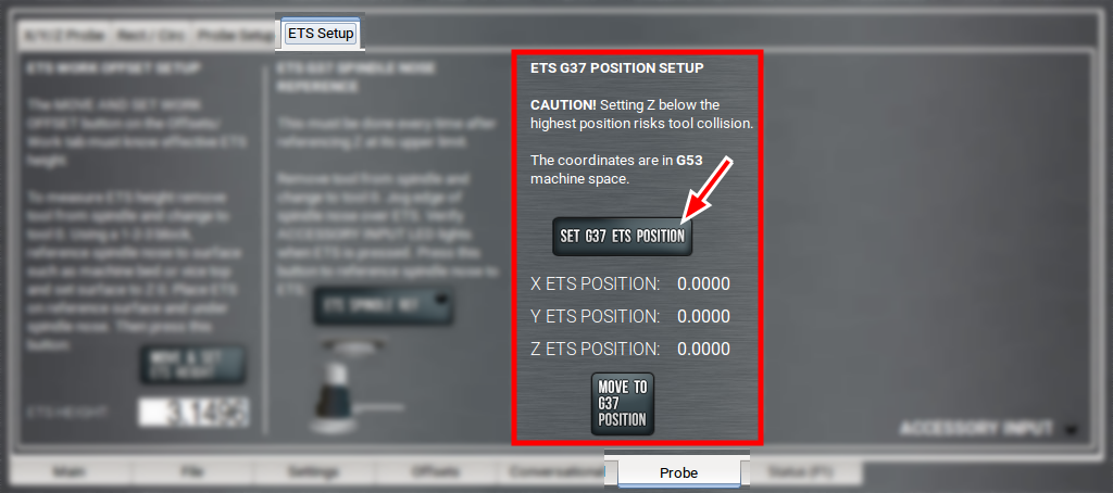

Set the G37 Position
  1. Remove the collet nut and the tool from the spindle.
 Figure 69: Set G37 ETS Position on the Probe tab.
The G37 position is now set.

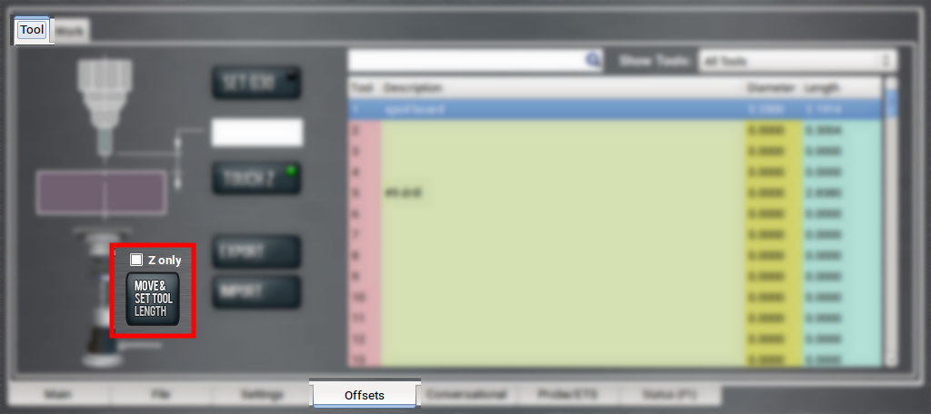

  1. On the Offsets tab, find the Move and Set Tool Length button and the Z only checkbox. Verify that the checkbox is cleared, and then select Move and Set Tool Length.
Note: You should only use the Z only checkbox to manually measure tools with a larger diameter. When it’s selected, the machine doesn’t go to the G37 position - instead, it just moves straight down (Z-) to measure the tool.
The machine moves to the G37 position and measures the tool with the ETS.
Note: Regardless of the initial feed rate, the final touch off feed rate while using and ETS is 2-1/2 in. per minute (IPM).

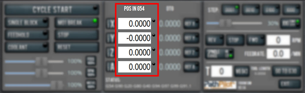

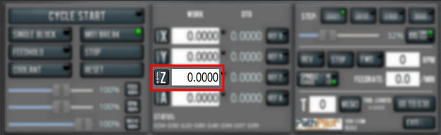

Set Work Offsets
  • Select Zero [Axis].
Figure 70: Work Offset DRO fields.
To change work offsets:
Figure 71: Work offset indicated in the PathPilot interface.

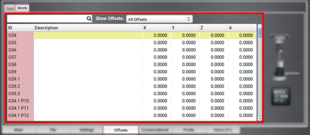

View Work Offsets
Figure 72: Work Offsets Table window.

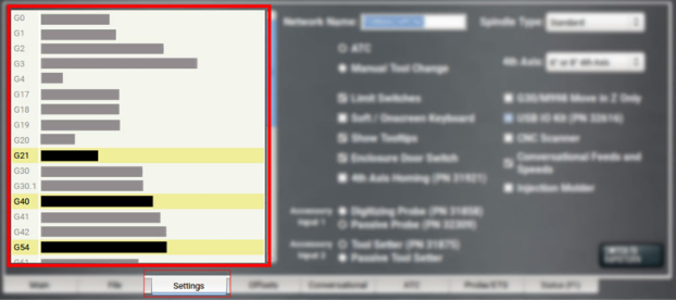

View Available G-Code Modes
Figure 73: G-code Description window on the Settings tab.

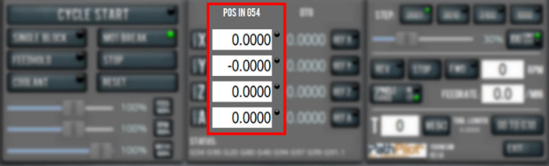

Figure 75: Work Offset DRO fields.

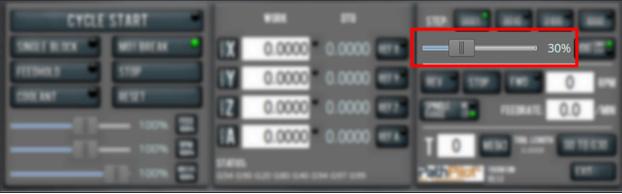

Jog in Step Mode
  • Imperial (G20) Mode 0.00025 in. to 0.1000 in.
  • Metric (G21) Mode 0.010 mm to 2.00 mm
To select the step size:
In the Manual Control Area, select the step size.
Figure 81: Step buttons (in G20 mode).
About Step Jogging

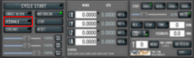

Use the Feed Hold Function
  • Select Feed Hold.
Figure 88: Feed Hold button.
About Feed Hold

Use M01 Break Mode
  • Select M01 Break.
Figure 90: M01 Break button.
About M01 Break
  • In the same folder as the G-code program
  • In an images folder within the G-code program's folder
  • In an images folder within the home directory
  1. Program an M00 or M01 break, and, using parentheses, type the full file name of the image (including its extension).
Example
M01 (Op1_Setup.jpg) displays the image file on the Tool Path display.

Capture Images with a USB Camera
To us M01 to take pictures:
  3. When PathPilot executes the M01 it looks to see if the comment contains a file.
    1. If there isn’t a file name: The comment is shown as instructional text across the tool path.

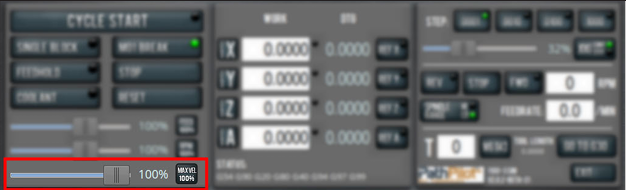

Figure 91: Maxvel Override slider.
  • Select Maxvel 100%.
About Maxvel Override

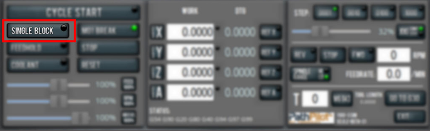

Use Single Block Mode
  • Select Single Block.
Figure 92: Single Block button.
About Single Block
You can turn single block mode on or off either before starting a program or while a program is running. For information, see "Use Single Block Mode".

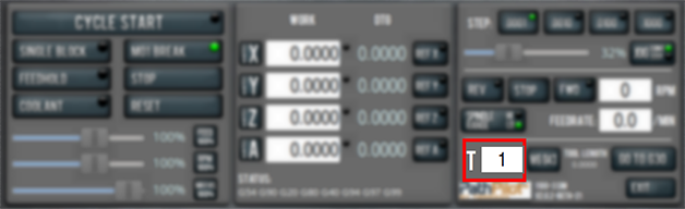

Change the Tool Number
Figure 96: Tool DRO field.
  1. In the Tool DRO field, type a number (the valid range is from 0-1000). Then select the Enter key.
NOTE: You can also select M6 G43. For information, see "About M6 G43".
About M6 G43
  • Apply the tool length offset for that tool typed in the Tool DRO field. For more information on tool length offsets, see "Set Tool Length Offsets". This is the equivalent of a G43 command.
Use a G30 Position
To set a G30 position:
Figure 97: Set G30 button.
To go to a set G30 position:
  • Do one of the following:
    • Select Go To G30.
Figure 98: Go to G30 button.

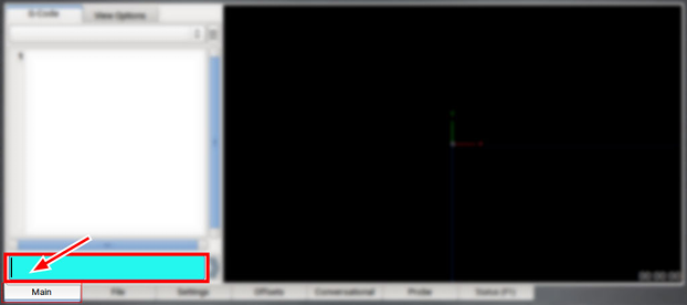

Manually Enter Commands
To manually enter commands:
Figure 100: MDI Line DRO field.
The DRO field highlights.
  1. Type the command.
About the MDI Line DRO Field

Figure 102: Feeds and speeds suggestions on the Conversational tab.
  • Spindle RPM
  • Feedrate
  • Z Feedrate
  • Depth of Cut
  • Stepover
  • Peck (if drilling)
Refresh DRO Field Values
Figure 103: Refresh button on the Conversational tab.
Use Additional Provided Information
The following tips are displayed based on the calculations that PathPilot is performing:
  • Chip Load Information Chip load — the amount of material removed per tooth — is based on the number of flutes, RPM, and feed rate.
    As the stepover value decreases, the actual chip load decreases. If the stepover is too small, the cutter may not have enough contact with the material to cut — effectively resulting in premature tool wear.
  • Cutting Speed Information Cutting speed is the speed that a given tooth (flute) on the cutter will be moving when it cuts through the material. All materials have a documented cutting speed.
    In imperial units, cutting speed is measured as surface feet per minute (SFM).
    In metric units, cutting speed is measured as surface meters per minute (SMM).
  • Material Removal Information The material removal rate (MRR) indicates how much material is removed by the tool per minute while cutting.

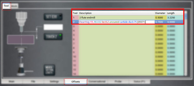

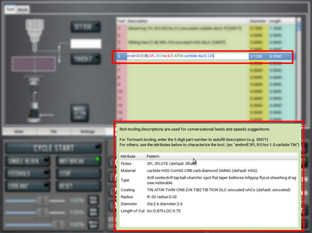

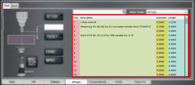

Create Tool Descriptions
  1. From the PathPilot interface, on the Offsets tab, identify the Tool Table window.
  2. Select a blank line.
Figure 104: A manually-entered tool description.
Examples
Example
Dia:.3125 4FL R:03 AlTiN CRB variable loc:.75
  • 0.3125 tool diameter
  • Four flutes
  • 0.03 radius, or "bullnose"
  • Carbide
  • Variable helix
  • 0.75 length of cut (loc)
Example
Gold colored end mill from middle drawer
This description provides very little information, and PathPilot defaults to basic cutter features:
  • Two flutes
NOTE: If you don't know the part number, you can search for the tool at tormach.com.
  2. Type the part number for the tool, like 35571.
Figure 105: An automatically-generated tool description for a Tormach tool.
Tool Keywords Reference
Item
Pattern
Example
Notes
type
Drill, Ball, Flycut, Drag
flutes
4FL, 12FL, 2flute
length of cut (or flute length)
loc:0.875
tool coating
TiN, ZrN, TiB2
No coating is specified same as “uncoated.”
tool diameter
Diameter:.0341, dia:.750
tool material
HSS, CoHSS, crb
No tool material is specified the same as HSS (high-speed steel).
tool radius
R:.02, radius:0.02

Use the File tab to manage system files on the PathPilot controller. For information, see "Transfer Files to and From the Controller".
To manage system files:
    • Select a file, and go to the Options menu. Then, select Copy, Cut, or Paste.
  • Select Back or Home.
Create Backup Files
Figure 106: Admin Settings Backup dialog box.
  2. Select Save.
Figure 107: Controller Files window on the File tab.
  • logfiles
  • media
  • ReleaseNotes
  • subroutines
  • USB
  1. Select Copy to USB.
About Backup Files
Restore Backup Files
Figure 108: Admin Settings Restore dialog box.
Figure 109: USB Files window on the File tab.
  2. Select Copy From USB.
Figure 110: Export and Import buttons on the Offsets tab.
Import a .csv File
Figure 111: Import dialog box.
Figure 112: Export dialog box.
  2. Select Save.
  4. Select Eject.
