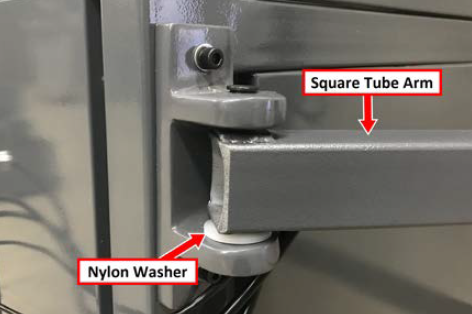

  1. Secure the square tube arm to the machine stand with two M8 socket head cap screws, two M8 flat washers, two M8 lock washers, and a 6 mm hex wrench. Verify that the white nylon washer is located toward the bottom of the mounting pad.
Figure 2: White nylon washer on the square tube arm.

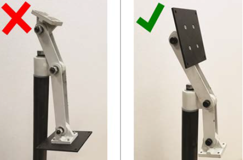

Figure 3: Incorrect and correct orientations of the monitor bracket on the Controller Arm.
Figure 4: Tightening the monitor bracket in place.

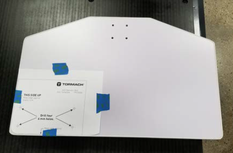

  2. Find the operator box drill template (provided in the machine owner's kit). Put the template on the operator box, and verify that the holes on the operator box align with the holes on the template. If they don't, trace the correct hole pattern on the template.
  3. Tape the template to the keyboard tray as shown in the following image. This indicates the location to mount the operator box, which you'll do later in this procedure.
Figure 5: Template taped to the keyboard tray.
  1. Drill the four holes through the template and into the keyboard tray with a drill and a #5 drill bit.
  2. Remove the template from the keyboard tray, and then discard it.

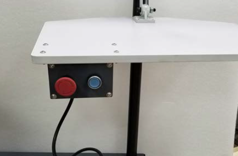

  4. Find the operator box (in the tool bag), and mount it to the bottom of the keyboard table with four M5 × 25 mm screws and four M5 nuts (provided in the machine owner's kit).
Figure 6: Operator box installed on the keyboard tray.

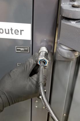

  1. Route the loose end of the cable from the operator box down the monitor post, through the openings in the square tube arm, and toward the electrical cabinet.
  2. Connect the cable from the operator box to the Emergency Stop Input port on the front right end of the electrical cabinet. Tighten the locking collar to secure the cable.
Figure 7: Operator box cable connected to the Emergency Stop Input port.

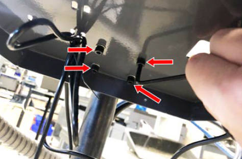

  1. Attach four wire tie mounts to the monitor post with four 4 mm flat head machine screws and a Phillips screwdriver.

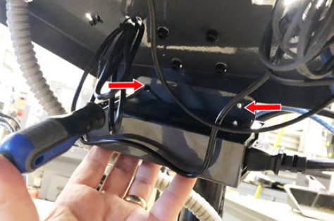

  1. Put the operator console's power supply into the power supply bracket (provided in the operator console box), and attach the assembly to the underside of the keyboard tray with M3 Phillips screws and a Phillips screwdriver.
Figure 11: Attaching the operator console's power supply and power supply bracket to the keyboard tray (from below).

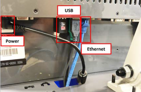

  3. If you have any of the following optional USB accessories, connect them to any USB port on the operator console:
  • Keyboard
  • Mouse
  1. Connect the WiFi dongle to any USB port on the operator console.
  2. Connect the Ethernet cable to the Ethernet port on the operator console.
  3. Connect the barrel end of the power supply cable to the Power Supply port on the operator console.
Figure 12: USB accessories connected.

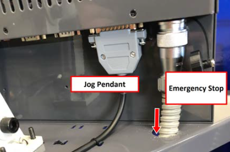

  1. Connect the jog pendant cable and the Emergency Stop cable to the operator console.
Figure 14: Jog pendant (left) and Emergency Stop (right) cables connected.

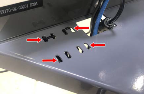

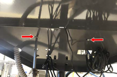

  1. Route the loose end of the operator console's 12 ft power cable, and the Ethernet cable down the controller arm. Then, route the cables through the slots in the square tube arm that's connected to the machine stand.
  2. On the right side of the machine, connect the loose ends of the cables as follows:
    1. Connect the operator console's power cable to any of the Accessory power outlets.
    2. Connect the Ethernet cable to the Controller Communications port.
  3. Secure the cables to the wire tie mounts that you installed on the round monitor post with four 4 in. cable ties.

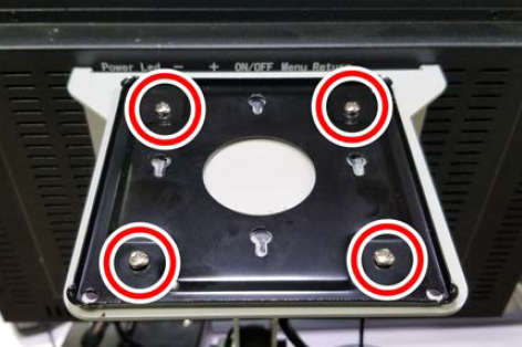

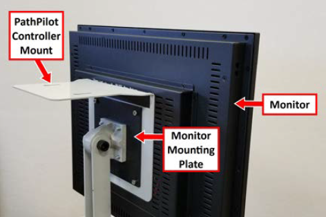

The PathPilot controller mount allows you to install the PathPilot controller behind the monitor (which is attached to the Controller Arm).
NOTE: If you're using a Touch Screen Kit (PN 35575), you must first remove the stock mounting bracket from the back of the monitor.

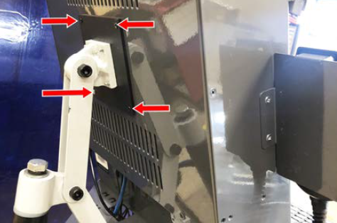

  1. Put the PathPilot Controller VESA Mount (PN 50382) against the monitor mounting plate. Then, put the monitor on the other side of the PathPilot controller mount, and align the holes on the three components.
  2. Attach the monitor, PathPilot Controller VESA Mount, and monitor mounting plate together with four M4 × 12 mm socket head cap screws (provided with the PathPilot Controller VESA Mount).
Figure 16: PathPilot controller mount attached to the back of the monitor.

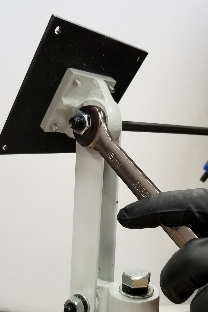

  1. Adjust the position of the monitor and the keyboard tray with an 8 mm hex wrench and a 16 mm wrench. Once complete, securely tighten the pivot screws.

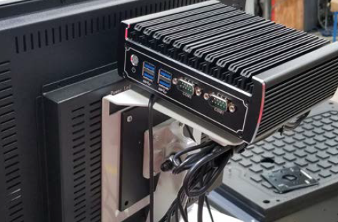

The PathPilot controller attaches to the top of the PathPilot Controller VESA Mount and behind the monitor.

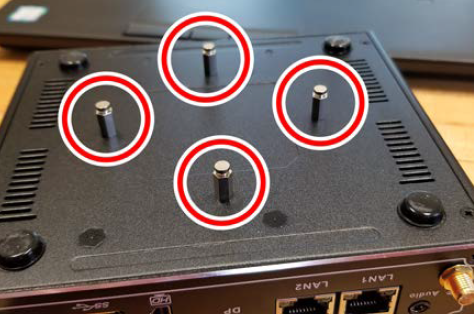

  1. Put four standoffs into the controller and tighten them by hand.
  1. Find the four M4 screws and the VESA plate included with the controller. Then, mount the VESA plate to the PathPilot Controller VESA Mount (PN 50382). Make sure to put it flat side down with the keyholes toward the monitor.
  1. Attach the controller to its mount by sliding the standoffs through the key slots.
  1. Connect all USB accessories to the controller:
  1. Connect the monitor's video cable to the PathPilot controller.

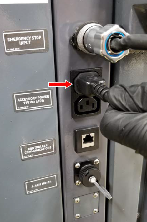

  3. Connect the monitor's power cord. Depending on the type of monitor you have, do one of the following:
a. Connect two of the Controller/Monitor cables (provided in the machine owner's kit) together. Then, connect one end of the cable assembly into the monitor.
b. Route the loose end of the cable assembly down the monitor post, through the square tube arm, and toward the electrical cabinet.
c. Connect the cable assembly into one of the Accessory Power Ports on the front right end of the electrical cabinet.
Figure 17: Connecting the monitor cable to the Accessory Power Port.

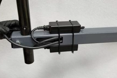

  1. Connect the PathPilot controller's power supply to the PathPilot controller.
  2. Connect the loose end of the power supply to one of the Controller/Monitor cables provided.
  3. Route the power cable down the monitor post, through the square tube arm, and toward the electrical cabinet.
  4. Connect the loose end of the Controller/Monitor cable into one of the Accessory Power Ports on the front right end of the electrical cabinet.
  5. Attach the PathPilot controller and monitor power supplies to the square tube arm with cable ties (provided in the machine owner's kit).
Figure 18: Power supply attached to the square tube arm.
