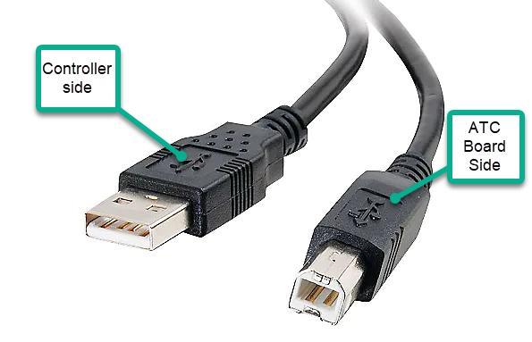

  1. All machines with an ATC communicate through a USB to USB-B cable. Identify this cable on your machine.
  1. Reseat the cable on both ends and then, in the PathPilot interface, check to see if the ATC tab does not disappear after 30 seconds. If the ATC tab does disappear, try replacing this cable and rechecking PathPilot for the ATC tab.

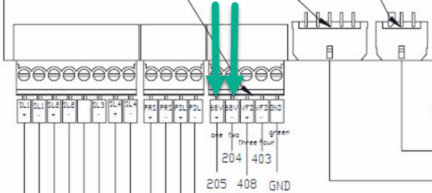

  3. Check for 68 Vdc across wires 204 and 205 at the ATC control board.

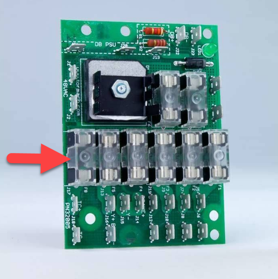

  1. If you do not have +68 Vdc across wires 204 and 205, move to the DC bus board in the electrical cabinet and check the F8 fuse for continuity. If you do not have continuity, replace the fuse.
    Note: This value should be close to zero and absolutely no more than 5 ohms.

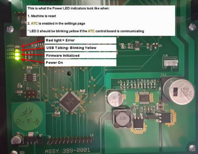

Legacy ATC
  1. Your ATC board should show the following LEDs lit if it has +68 Vdc at wires 503 and 504 at the ATC control board and is successfully talking to PathPilot.
  2. If you have +68 Vdc at wires 503 and 504 at the ATC control board but no lights on the board, contact Tormach Technical Support .

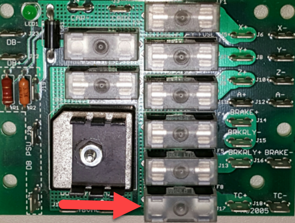

  3. If you do not have +68 Vdc across wires 503 and 504, move to the DC bus board in the electrical cabinet and check the F8 fuse for continuity. If you do not have continuity, replace the fuse.

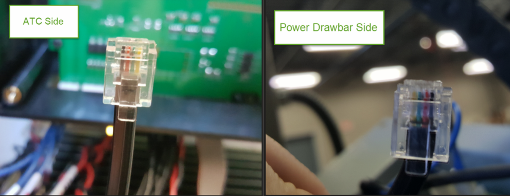

  4. If the ATC won’t communicate and the ATC tab goes away, but the power drawbar opens/closes and the Status tab shows when the USB is removed and replaced, then inspect the RJ11 (DB3) cable for damage. Reseating and/or replacing this cable may be necessary as it may have became damaged or have an intermitted short.
