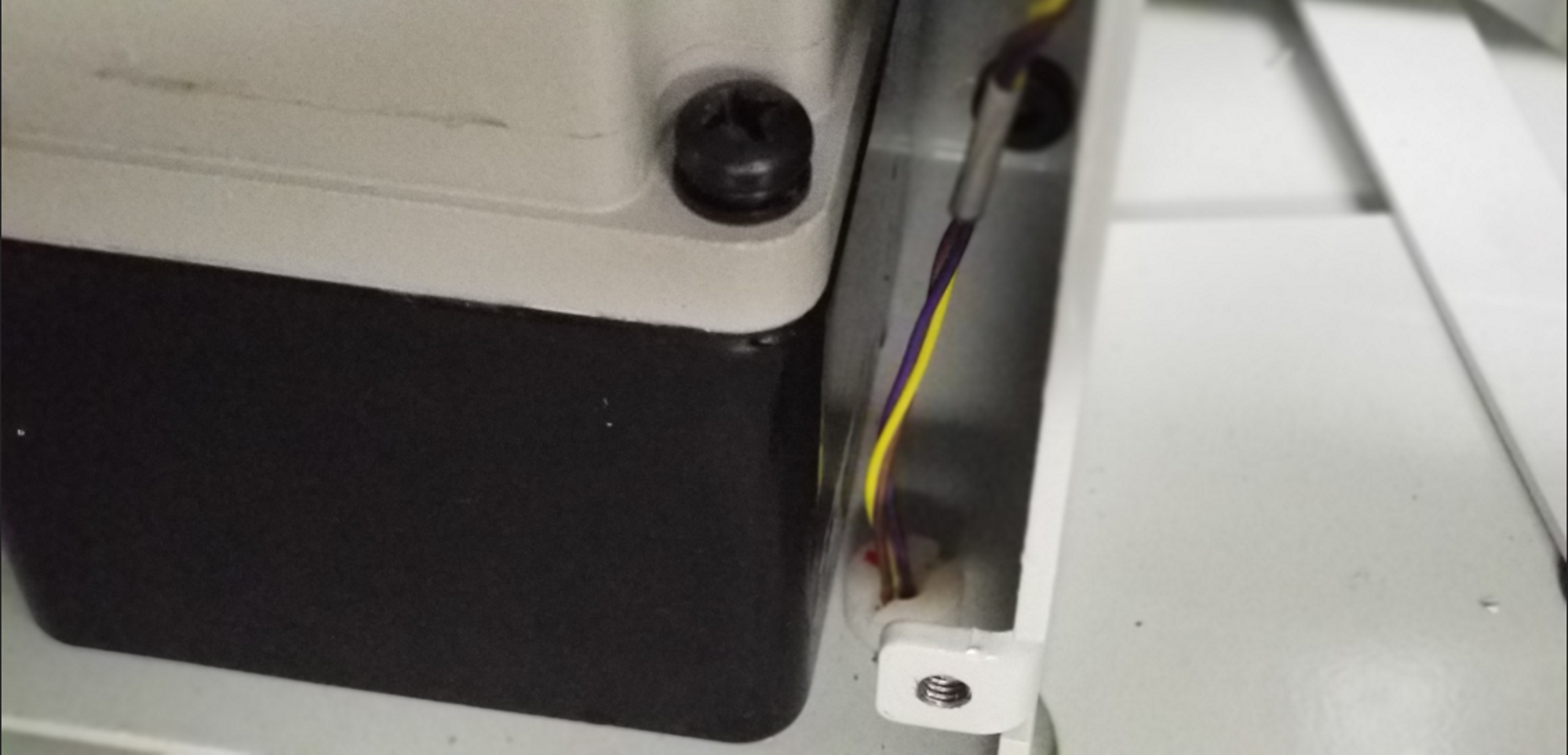

Check Wiring and USB Cable
Reason: Loose or broken wires
  1. Check that the three wires are firmly seated in the 4-pin Molex under the motor cover. Also, check pins at the 10-pin carousel cable connector end (PN 38670). Re-seat as required. Inspect plug for any bent, or ‘spread’ pins. Stretched pins can cause the ATC motor to short, and is often times accompanies by a jittery motion.

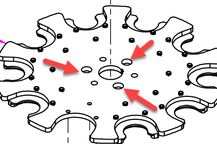

Check Tool Tray
Reason: Tray or hub bolts came loose
  1. Power up the mill.
  2. With power to the ATC, you should not be able to rotate the tool tray by hand. If there is any detectable slop, make sure to tighten all six bolts that are accessible from the bottom of the tool tray.
3 bolts are accessible through clearance holes in the tool tray

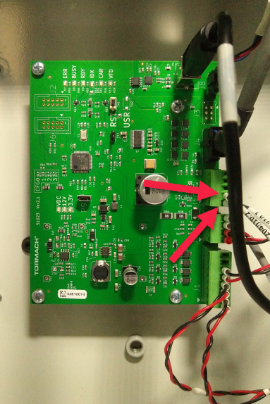

Board Issue
Reason: Bad ATC board
  1. Check for 68 DCv on your board. (Wires 204-205)
V2.x ATC Board
  1. If the sensor appears to be functioning, you have voltage on your board, and you need to realign your ATC after an emergency stop, or powering down your machine, contact Tormach Technical Support.
