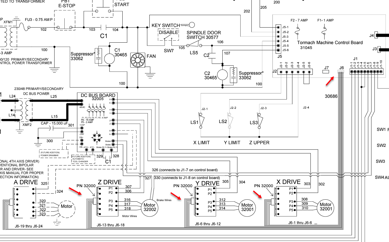

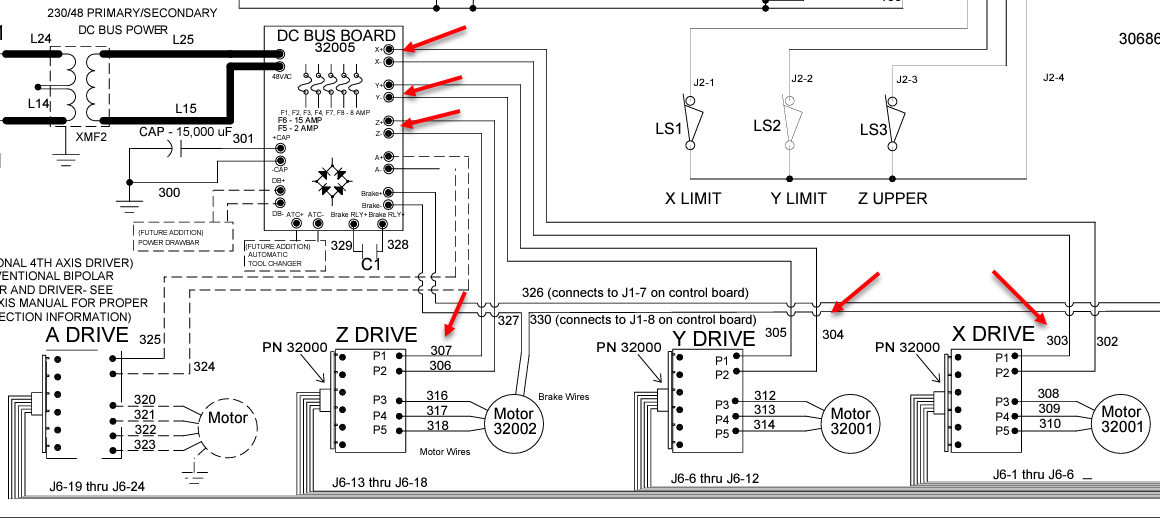

  3. Examine the data cable at the machine control board and the axes drivers.
      1. J6-1 - J6-6 (X-axis)
      2. J6-7 - J6-12(Y-axis)
      3. J6-13 - J6-18 (Z-axis)
PCNC 1100 J6 Ribbon Cable
PCNC 1100 Main Control Board and Driver Locations
      1. 302/303 (X-axis)
      2. 304/305 (Y-axis)
      3. 306/307 (Z-axis)
PCNC 1100 Stepper Driver Power Wires

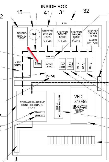

PCNC 1100 DC-BUS Location

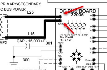

Inspect the DC-BUS board
Reason: The DC-BUS is malfunctioning.
    1. If it does: The motors or stepper driver controllers will be illuminated, if the DC Bus Axis Fuses are not blown. To learn how to check individual fuses, see: One Axis Won't Move (or Only Moves in One Direction), and Other Axes Move - PCNC 1100 | Inspect the DC Power Supply
  2. Power off the machine.
    1. L25
    2. L15
PCNC 1100 DC-BUS

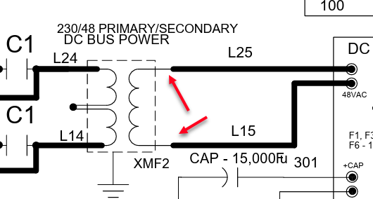

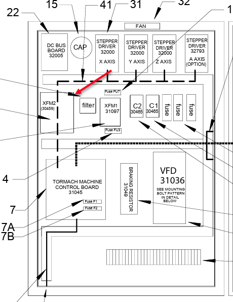

Inspect the XMF2 Transformer
Reason: The transformer is shorted
  1. Power off the machine.
  2. Remove L25 and L15 from the transformer.
PCNC 1100 XFM2 Location
  1. Power the machine back on.
  2. Take an AC reading between the terminals L25 and L15 were on.
  3. If you do not see 48 Vac, continue to the next troubleshooting step.

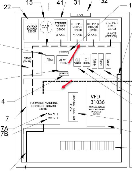

Check the C1 Contactor
Reason: The C1 is defective.
  2. Inspect the C1 to see if the center bar has been pulled in.
    1. If bar is in: The C1 is latched. Using a digital multimeter set to Vac, measure for 220 Vac between:
      1. L14
      2. L24
  3. Press and hold the Reset button on the operator box and observe the C1. Then release the Reset button and observe the C1.
    1. If the bar only stays in when the button is pressed: There is a loose coil wire, short, or the C1 has malfunctioned.
    2. If the bar never gets pulled in: See Machine Won't Power On - PCNC 1100
