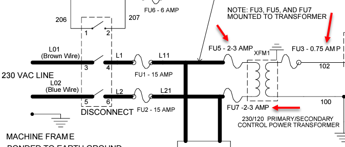

PCNC 1100
L1 and L2
230 Vac nominal
Check the FU1 and FU2 Fuses
Reason: Fuse is blown.

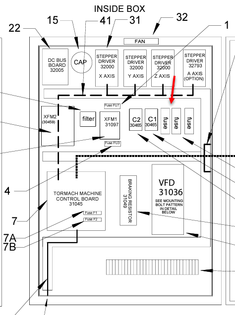

  1. Identify your machines main fuses.
PCNC 1100 FU1 and FU2 Location
  1. Power down the machine, and remove both fuses.
  2. Check both fuses using the following process: Checking a Fuse on a Tormach Machine
  3. If any fuse is blown, replace it.

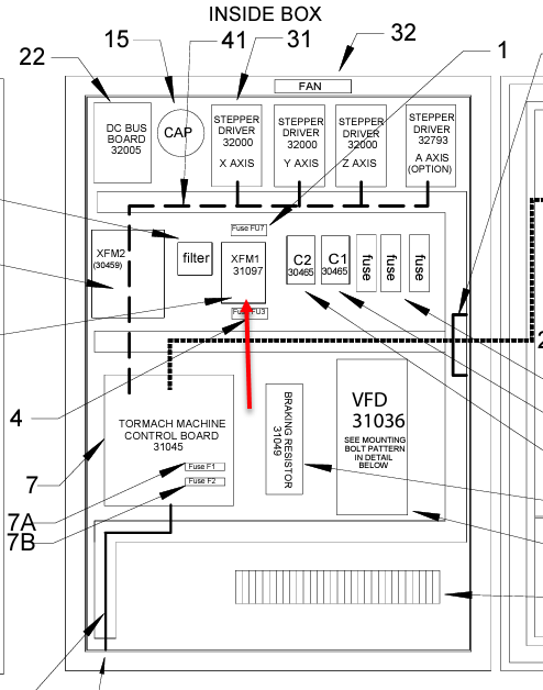

Inspect the XFM1 Transformer
Reason: Transformer fuse blown or transformer shorted.
  1. Take a Vac reading between wires 100-102.
  2. If no voltage is present, power down the machine, and check all three fuses on the transformer.
XFM1 Transformer Location

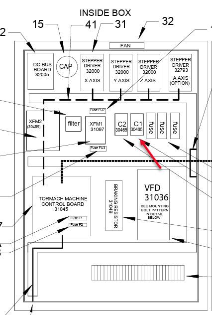

Check the C1 Contactor
Reason: The C1 is defective.
  2. Inspect the C1 to see if the center bar has been pulled in.

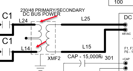

    1. If bar is in: The C1 is latched. Using a digital multimeter set to Vac, measure for 220 Vac between:
      1. L14
      2. L24
PCNC 1100 C1 Location
  1. Press and hold the Reset button on the operator box and observe the C1. Then release the Reset button and observe the C1.
    1. If the bar only stays in when the button is pressed: There is a loose coil wire, short, or the C1 has malfunctioned.
    2. If the bar never gets pulled in: Go back to the previous troubleshooting topics to ensure your machine is receiving power.
