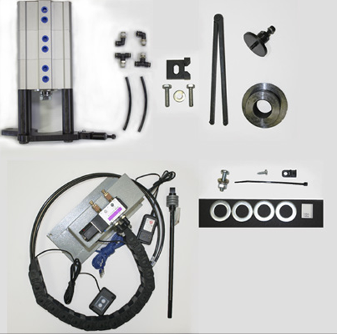

Purpose
This document details installation of the Power Drawbar on the PCNC 1100 mill.
Qty.
PCNC 1100 Power Drawbar
PN
1/4 in. Plastic Tube: 112 mm
31457
1/4-20 × 1 Screw, Flat Washer, and Nut
31331
105A Wire Labels
Air Fitting: Elbow
31324
Air Fitting: T-connector
31325
Cable Carrier End Bolt, Washer, and Lock Washer
Control Assembly
31470
Cylinder Assembly
31380
Drawbar
31320
Drawbar Bushing
31330
Eccentric Mounting Post
31316
Leg Bracket
31318
M6 × 25 mm Screw and Flat Washer
32371
M6 × 45 mm Screw and Lock Washer
31332
M16 Flat Washer
31445
Pendant
31471
Plastic Mount Tab
31460
Sheet Metal Screw
31718
Spanner Pin Wrench
31118
Spindle Flange and Set Screw
31321
Spring Washers
31319
Thread Seal Tape
Wire Tie
31719

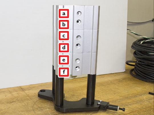

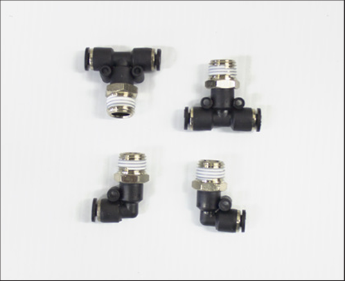

  1. Find the four provided air fittings (see Figure 1).
Figure 1
  1. Completely wrap the threads of the four air fittings with the provided thread seal tape.
  2. Put the power drawbar cylinder on a flat surface as shown in Figure 2.
Figure 2

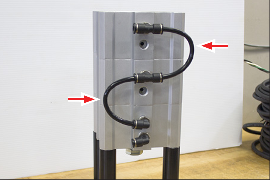

  1. Install the air fittings in the power drawbar cylinder in the order specified, from top to bottom (see Figure 2 and Figure 3):
    1. T-connector
    2. (empty)
    3. T-connector
    4. (empty)
    5. Elbow connector
    6. Elbow connector

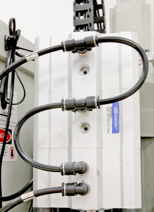

When complete, verify that your power drawbar cylinder matches Figure 3.
Figure 3

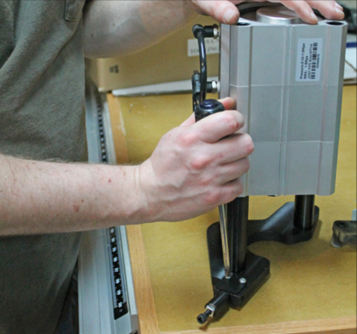

  1. Find the two provided 112 mm 1/4 in. Plastic Tubes.
  2. While facing the power drawbar cylinder, put one plastic tube between the left sides of both T-connector air fittings as shown in Figure 3.
  3. Put the remaining plastic tube between the right sides of the T-connector air fitting and the elbow connector air fitting in as shown in Figure 3.

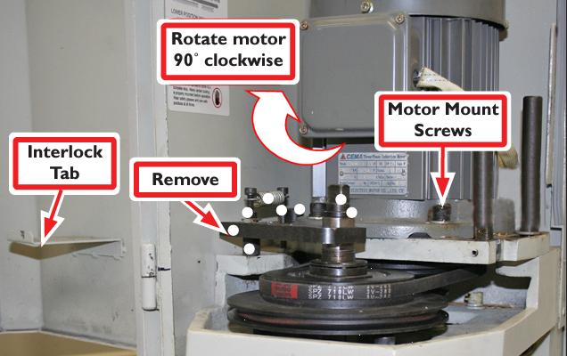

  1. Remove the spindle door Interlock Tab (see Figure 4).
Figure 4
  • On Newer Machines This is bolted; unbolt and remove it.
  • On Older Machines This is welded; removed it with a hammer and chisel (or similar).
NOTICE!: If you use a chisel, it could leave visual marks on the front face of the door. Work slowly to avoid machine damage.
  1. Remove and discard the existing spindle lock, spring, spacers, pin, and fasteners that are indicated by white dots in Figure 4.
NOTE: If the pin is difficult to remove, cut it off flush at its base.
  1. Remove the existing drawbar and drawbar bushing, if equipped.

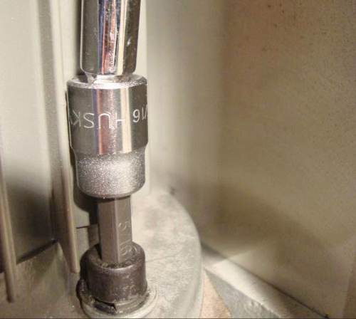

  2. For Older PCNC 1100 Mills Remove the four Motor Mount Screws with a hex extension and rotate the spindle motor 90˚ clockwise (see Figure 4). Re-install the Motor Mount Screws.
    Verify that the spindle motor is facing the interior of the cabinet.
Figure 4

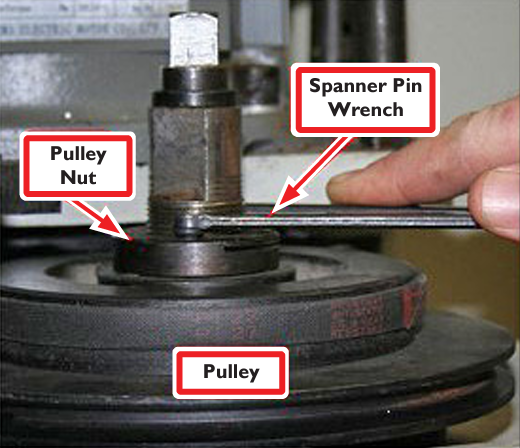

  1. Loosen the Phillips screw on the pulley retention nut, then remove the Pulley Nut with the provided Spanner Pin Wrench as shown in Figure 6. Discard the Pulley Nut.
NOTE: Some nuts may not fit the Spanner Pin Wrench. You can also use a large channellock or locking pliers.
Figure 6
  1. Inspect the top face of the Pulley for rust or other debris and, if necessary, clean it.

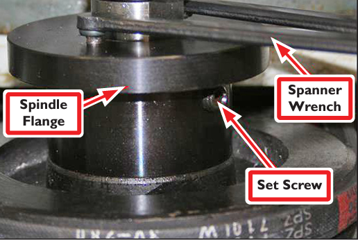

  1. Thread the Spindle Flange onto the spindle and use the Spanner Pin Wrench to securely tighten (see Figure 7).
  2. Put Loctite on the Spindle Flange Set Screw and securely tighten (see Figure 7).
NOTE: The set screw is already recessed in the Spindle Flange; fully tighten the screw once the flange is in position.

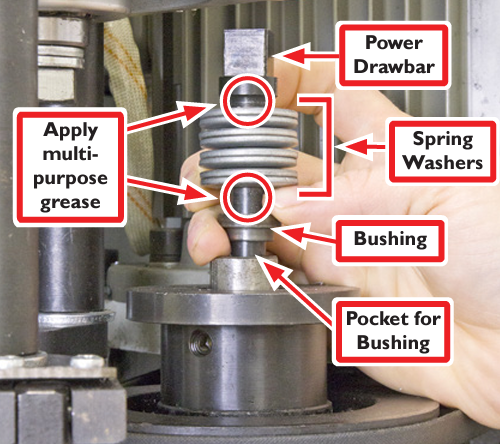

  1. Put the Power Drawbar, Spring Washers and Drawbar Bushing (see Figure 8). Insert an empty Tormach Tooling System (TTS)® collet into the spindle and thread in the Power Drawbar. Hand tighten the Power Drawbar. Then, insert a TTS tool holder into the collet and, with the wrench, tighten the Power Drawbar two turns.
  2. Put multi-purpose grease to the areas shown in Figure 8.
NOTICE! After the initial installation, you must complete a final pre-load adjustment (for information, see Spring Washer Pre-Load Adjustment). If you don’t, it could result in tool pull-out.
Figure 8

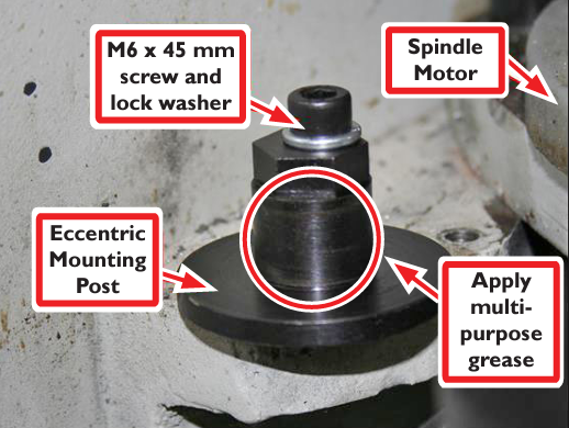

  1. Mount the Eccentric Mounting Post to the pre-existing hole formerly used to mount the spindle lock plate with M6 x 45 mm Screw and Lock Washer (see Figure 10).
    Do not tighten the screw at this time.
  2. Put multi-purpose grease on the area shown in Figure 10.

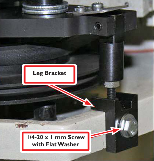

  1. Mount the Leg Bracket as follows (see Figure 11):
  • Pre-Drilled/Tapped Hole Use the M6 x 25 mm Screw and Flat Washer.
  • No Pre-Drilled/Tapped Hole Use the 1/4- 20 Screw and Flat Washer.
Figure 11
  1. Use the Leg Bracket as an alignment tool to mark the center of the bracket mounting hole.
NOTE: Depending on the age of mill, the pre-drilled and tapped hole may not provide proper alignment, and drilling a second hole may become necessary. Before drilling a second hole, test the alignment (see Figure 14 and Figure 15). If proper alignment is not achieved with the pre drilled and tapped hole, this step is necessary.
  1. Move the Leg Bracket to the vertical position (see Figure 12).

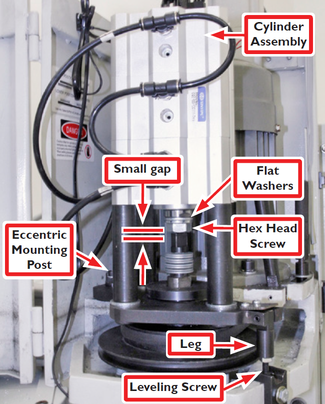

  1. Move the air Cylinder Assembly over the Eccentric Mounting Post as shown in Figure 13.
  2. Adjust the Leveling Screw until the Cylinder Assembly is close to level (see Figure 13). Tighten the Leveling Screw jam nut.
  3. With the cylinder in the retracted position, there should be a small gap between the Hex Head Screw and the top of the Drawbar (see Figure 13). If there is no gap, remove one M16 Flat Washer from the cylinder rod.
Figure 13
NOTE: Four extra flat washers are provided. If necessary, place the washers under each mounting post to further adjust the small gap between the hex screw and the top of the Power Drawbar.
IMPORTANT! Verify that the Hex Head Screw is tight on the cylinder rod when complete.

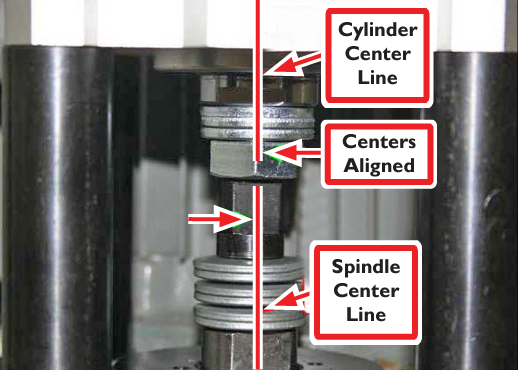

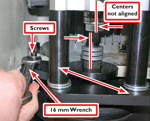

  1. The cylinder must be centered over the Power Drawbar for proper operation – the Eccentric Mounting Post is designed for this purpose.
    Rotate the eccentric with a 16 mm wrench to tweak the position of the Cylinder Assembly so that the cylinder is visually centered over the Power Drawbar. When the adjustment is complete, tighten the M6 × 45 mm cap screw on Eccentric Mounting Post (see Figure 14).
Figure 14

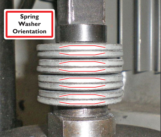

NOTE: Six spring washers are shown in Figure 15. This photo is intended to show correct alignment only. Eight Spring Washers are provided.
Figure 15

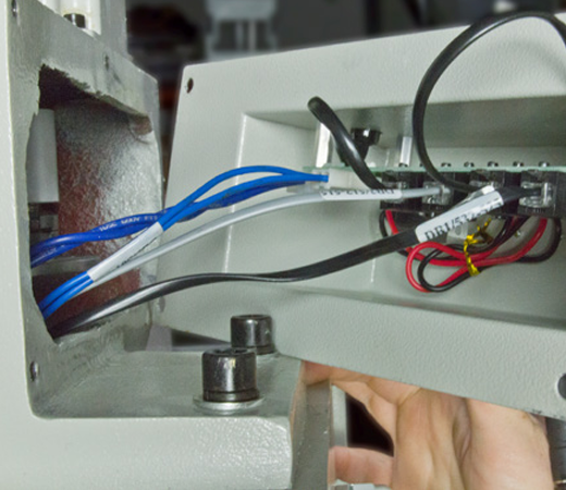

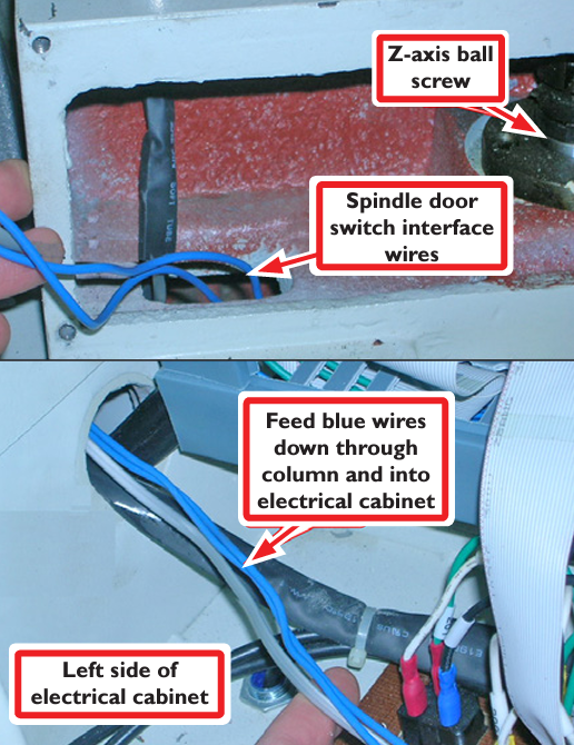

  1. Remove the existing Z-axis motor mount cover, and set it aside with its screws.
  2. Move the Control Assembly’s blue wires down the access hole (see Figure 16).
NOTE: Keep the ends of the wires with the white connector toward the top, and move the spade ends down through the column. It may be useful to tape the ends together.
Thread the wires down through to the column access hole to the inside of the main electrical cabinet (see Figure 16).
IMPORTANT! During operation, wires must not come in contact with the ball screw and Z-axis motor coupling. After installation, you must confirm that these wires are out of the way. This does not apply inside the column — only inside the motor mount.
NOTE: Before you terminate the free ends, twist the blue wires together approximately a dozen twists.
Figure 16

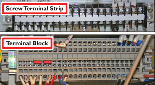

  1. Older machines are equipped with a Screw Terminal Strip, while newer machines have a Terminal Block. Identify the connection type in electrical cabinet specific to your machine as shown in Figure 17.
Figure 17
NOTE: For both the terminal block and strip, the wiring numbers and layout shown in Figure 18 are the same.

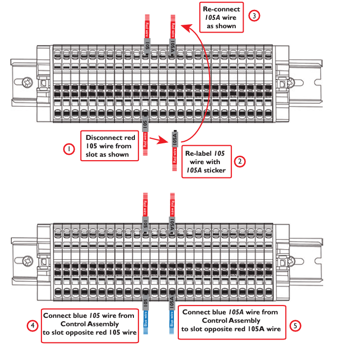

  1. Following the instructions in Figure 18, put the new spindle door wires in series with the spindle door switch circuit. Some wiring configurations may appear different than shown, but wire numbers and layout are all the same.
NOTE: You may want to record the wiring changes in the machine’s operator’s manual.
Figure 18

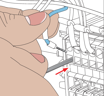

  1. If your machine has a terminal block, connect the wires:
    1. Slowly insert the end of a small, flat-head screwdriver into the slot above or below the selected wire connection site (see Figure 19).
    2. Pry the terminal clip open carefully. Then, insert the wire into the terminal block.
    3. Slowly remove the screwdriver.
Figure 19

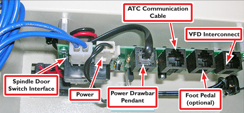

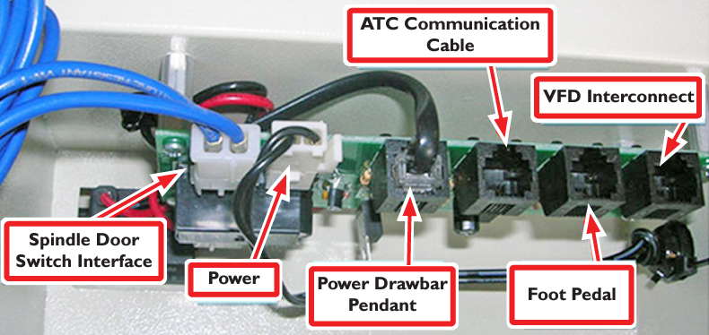

  1. Connect the blue wires to the inside of the Power Drawbar control box (see Figure 20).
Figure 20
NOTE: This photo is for reference only. The units are pre-wired.

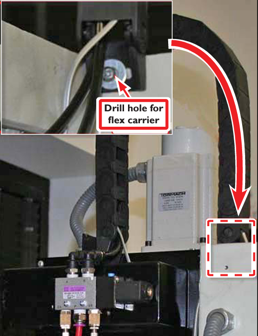

  1. Position the free end of the flexible hose/wire carrier to the inside of the spindle guard.
  2. Mark the hole and drill through with a 9/32 in. drill bit.
  3. Mount the free end of the carrier with the Carrier Cable End Bolt with Washer and Lock Washer as shown in Figure 22 and inset.
Figure 22
NOTICE! Be cautious of lubrication lines that may run on the back side of the spindle guard.

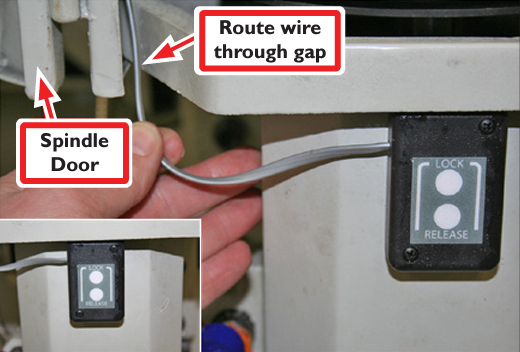

  1. Mount the Pendant to the spindle head with the double-sided tape that’s on the back of the Pendant (see Figure 23 inset).
  2. Route the pendant’s wire as shown in Figure 23.
Figure 23

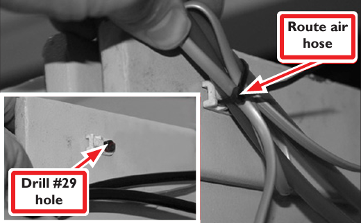

  1. Drill a hole in the upper portion of the spindle cover’s left wall with a #29 drill bit (see Figure 24 inset).
  2. Mount the Plastic Mount Tab with the included Sheet Metal Screw.
  3. Route the air hoses and excess pendant wire through the Wire Tie and tighten (see Figure 24).
Figure 24

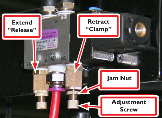

  1. Connect the air hoses to the cylinder (see Figure 25).
Figure 24
  1. Plug the power cord into any 120 Vac outlet.

Initial Setup Adjustment
The purpose of this adjustment is to set the highest possible pre-load, while still allowing the power drawbar cylinder to release the tool.

Exhaust Valve Adjustment
The air valve in this system has two adjustable choked exhaust ports. Adjusting these ports changes the rate at which air exits the system. Tightening the screw slows air flow (and motion), while loosening the screw increases flow (and motion). The retract can be adjusted for fast motion, but the extend should be a bit slower (see Figure 27). If this is adjusted too tight, no flow occurs and the cylinder likely will not move. If these are adjusted too loose the cylinder moves too fast and impacts the drawbar with more speed than is needed, increasing wear and tear on the system.
Proper adjustment makes motion smooth and solid; no banging and no sluggishness.
NOTE: Verify that the jam nuts are tightened when adjustment is complete.

  1. Top of the Power Drawbar (under the drawbar flange and the spring washers)
  2. Eccentric pivot mount
  • Inspect all spring washers, which are wear items, once a month for cracks. Replace any damaged components with Power Drawbar Spring Washer (PN 31319).

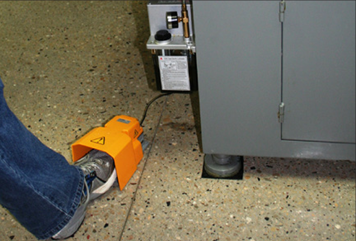

Foot Pedal Kit
The Power Drawbar Foot Pedal Kit (PN 31728) provides foot activation for hands-free operation.
  1. Remove the Power Drawbar electrical housing (see Figure 28).
Figure 28

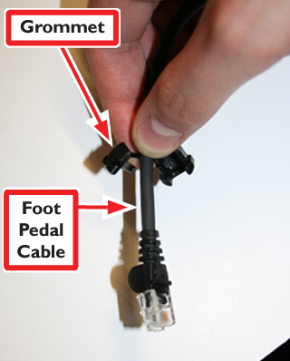

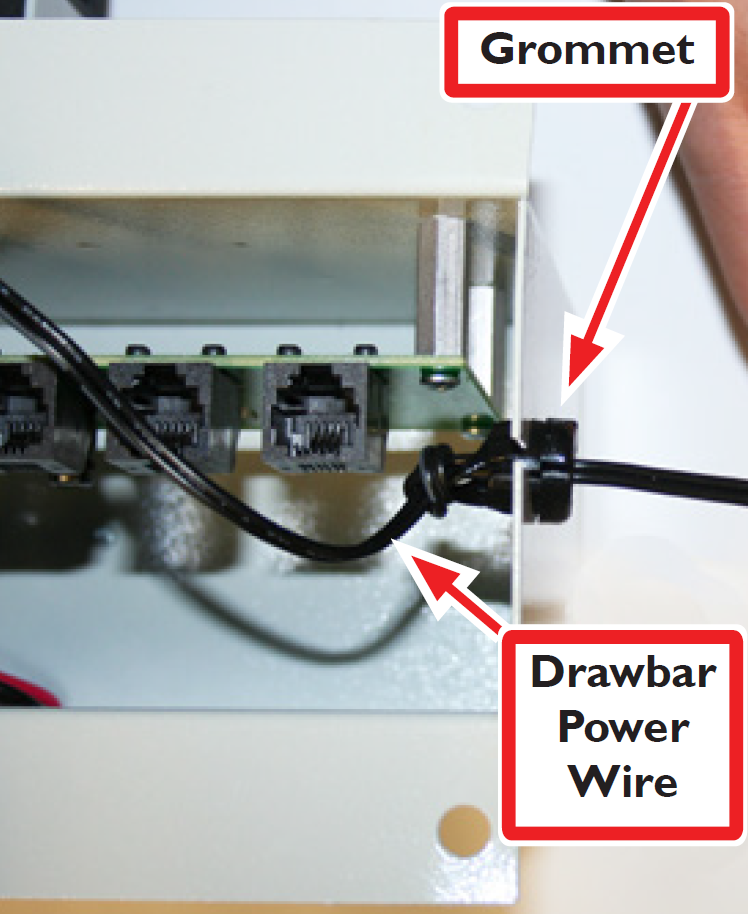

  1. Identify and remove the Grommet on the Drawbar Power Wire (see Figure 29) and discard.
Figure 29
NOTE: Some earlier models may not include the Grommet.

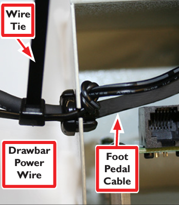

  1. Carefully cut wire tie used to attach the extra Grommet to the Foot Pedal Cable. Then, clip the Grommet back onto the cord and insert it in the housing (see Figure 30).
Figure 30
  1. Move the Drawbar Power Wire through the slot, in line with the Foot Pedal Cable. Attach both wires together with the provided Wire Tie.
Figure 31
  1. Plug the Foot Pedal Cable into the Foot Pedal slot on the power drawbar control board (see Figure 32).
Figure 32
  1. Put the foot pedal in a position that allows for easy access during operation (see Figure 33).
Figure 33

Visually inspect that cylinder hex bolt is aligned concentrically with the drawbar. Refer to Mechanical Assembly section earlier in this document for more information.
It is ideal to pass 100 percent of the available cylinder force directly down into the spring washers. Any misalignment will result in some side loading and a reduction of downward force. Component damage can also occur in cases of extreme misalignment.

Cylinder is stroking out (running out of travel) before compressing the spring washers fully
Low
There should be no more than a 1/8” gap between the cylinder hex bolt and the top of the drawbar. If gap is too large, cylinder will stroke out (run out of travel).
This issue is usually found only during installation. Should this occur, add a flat washer under cylinder rod hex bolt to reduce gap. For more information, refer to Mechanical Assembly section earlier in this document.

If the pre-load is too loose, the spring washers will not hold the tool holder tight enough. Pre-load should be checked occasionally as use can cause the system to fall out of adjustment.
Spring washers are worn or cracked
Medium
Inspect spring washers
Spring washers are a wear item; replace as needed.
