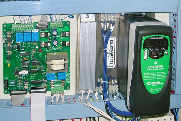

NOTE: We're continuously improving our products, so your machine may vary from the photos in our documents and videos. For example, newer upgrade kits use a Commander C200 VFD, and older upgrade kits use a Commander SK VFD. While the images may vary, the concepts still apply.
Removing Existing Drive

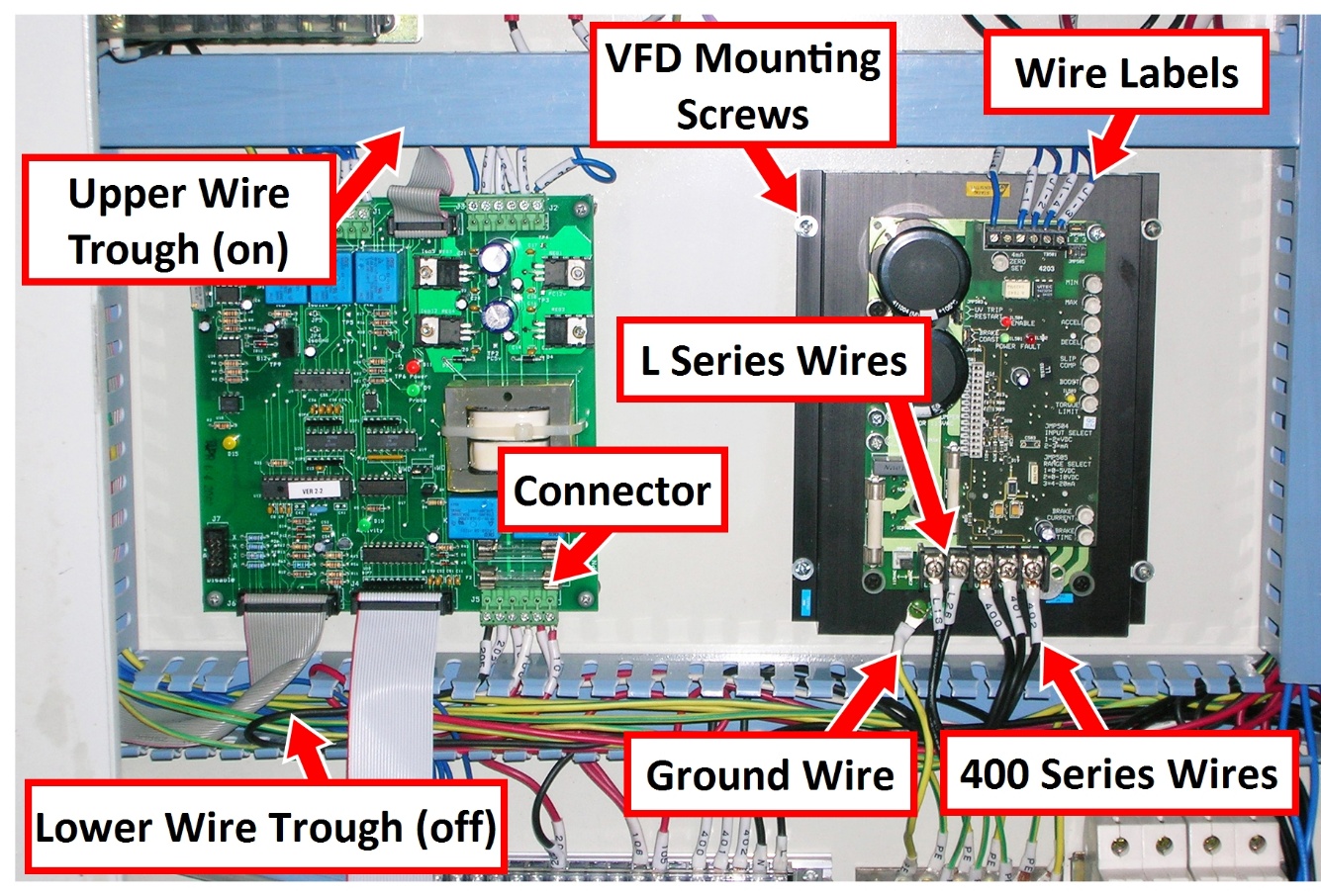

  2. Remove the cover of the upper and lower wire trough inside the electrical cabinet.
Figure 1: Electrical cabinet.
  1. Detach and remove all wires from the existing drive.
    NOTE: If any wires are missing wire labels, note their connection labels as shown in the following image, and tag them with the extra wire labels (included).

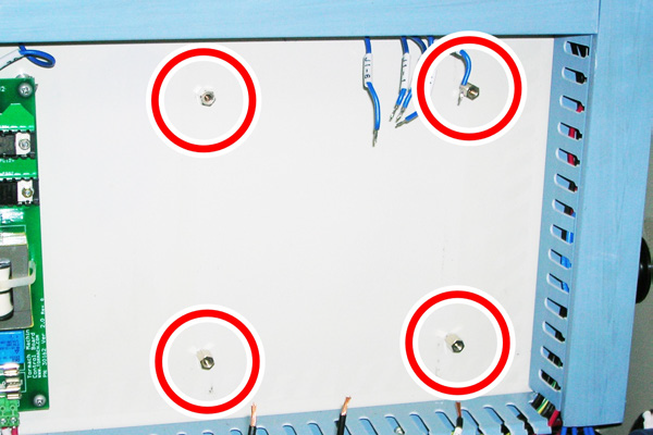

  1. Remove and discard four VFD mounting screws that secure the drive to the back panel of the electrical cabinet.

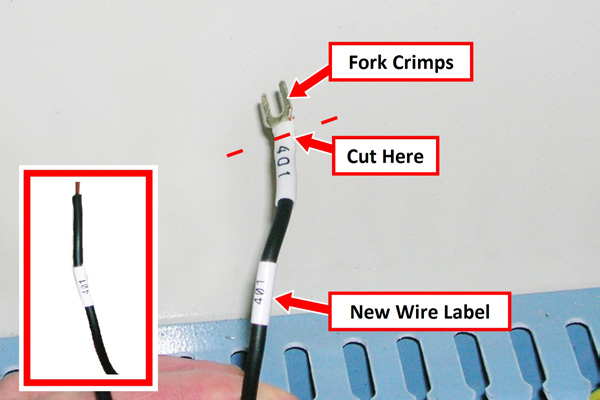

  1. Identify wire L16, L26, 400, 401, and 402 in the lower wire trough.
  2. Match each wire label (included) to each wire; put the new wire label below the existing label, as shown in the following image.
Figure 3: Attaching new wire labels.
  1. Using a wire cutter, remove existing fork crimps at the location indicated in the image above.
    NOTE: Do not to remove any more wire than is needed.
  2. Remove the original wire label and strip the wire 1/4 in. from its end (as shown in the image's inset).

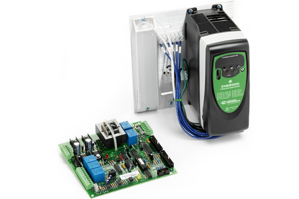

Mounting VFD Motor Drive Assembly
  1. Put four M4 × 10 mm spacers (included) into the four mounting holes that were previously used for the original drive.
Figure 4: Spacers installed
  1. Using four M4 × 10 mm screws and four M4 flat washers (both included), mount the VFD motor drive assembly onto the spacers that you installed in Step 1.
Figure 5: Replacement VFD installed.
NOTE: On some mills, the vertical space between the wire troughs may be too tight to fit the VFD motor drive assembly. In this case, adjust the lower wire trough and remount.
IMPORTANT! Be careful to not damage any wires in the wire trough.

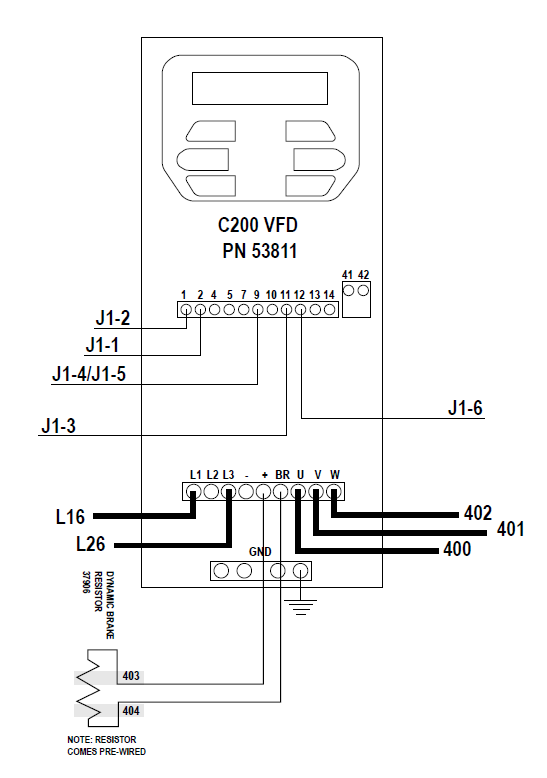

Wiring VFD Motor Drive Assembly

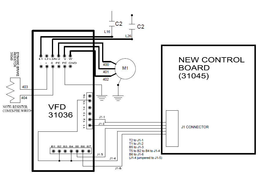

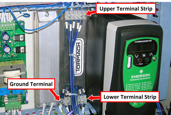

  1. Identify wires from the upper wire trough; these connect to the upper terminal strip on the VFD motor drive assembly.
Figure 6: Replacement VFD wiring.
  1. Refer to "Drawings” to make specific wiring connections on the upper terminal strip.
  2. Repeat Steps 1 through 2 for the lower wire trough and its corresponding wiring connections on the lower terminal strip.
    NOTE: If the space is too tight to connect the wires, remove the two screws holding down each terminal strip and make the wiring connections. Remount both terminal strips when wiring is complete.

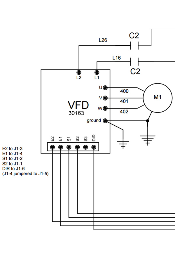

  3. Some older mills may have wire numbers that do not correspond to wires labeled J1 in this upgrade kit. Refer to the table below for correct wiring on older mills:
Original Spindle Drive Wire Number
If equipped with SK VFD (PN 31036)
If equipped with C200 VFD (PN 53811)
S2
J1-1
S1
J1-2
E2
J1-3
11
E1
J1-4
DIR
J1-6
12
  1. Using the wiring diagram (in "Drawings"), make the correct ground wire connection.
IMPORTANT! Ensure there are no loose wire strands at the terminal strip that may come in contact with another wire.
Mounting New Machine Control Board
  1. Remove all wire harnesses from the existing control board.
    NOTE: Discrete wires are connected through the use of multi-terminal connectors that mount to the control board. Do not remove individual wires; remove the entire connector from the control board.
  2. Remove the four mounting screws and the original control board from the electrical cabinet. Replace it with the included machine control board, and reconnect the wire harnesses.

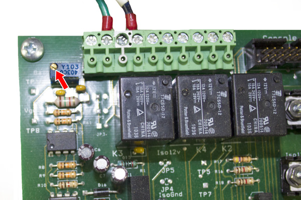

  4. Inspect the value displayed on the front panel of the VFD. The recommended range is 34-36 Hz.
  5. If the value is outside of the 34-36 Hz range, use a small, flat-blade screwdriver to adjust the trim potentiometer screw on the machine control board until the value is within range.
    NOTE: If better accuracy is needed, use a tachometer to measure actual spindle speed.
Figure 7: Trim potentiometer screw on the machine control board.

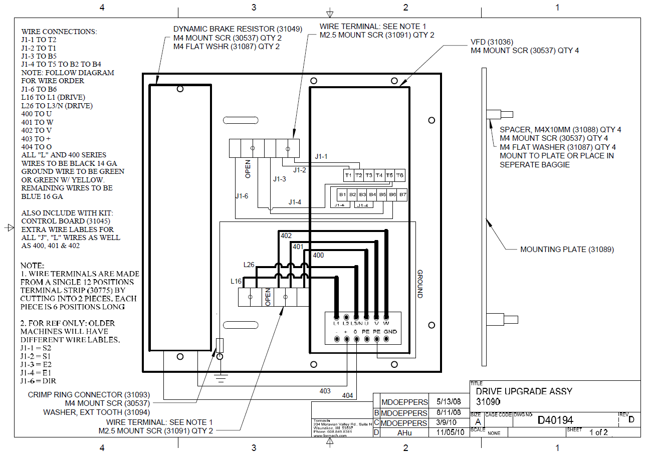

NOTE: After Spindle Drive Upgrade Kit is installed, attached drawing (D40194) supersedes VFD wiring diagrams in original Operator Manual.
Drawings
IMPORTANT! Two wiring diagrams are included. Newer upgrade kits use a Commander C200 VFD (PN 53811), and older upgrade kits use a Commander SK VFD (PN 31036). Use the wiring diagram specific to the VFD in your upgrade kit.
Wiring Diagram for SK VFD (PN 31036)
Wiring Diagram for C200 VFD (PN 53811)
D40194 - VFD Upgrade Assembly
